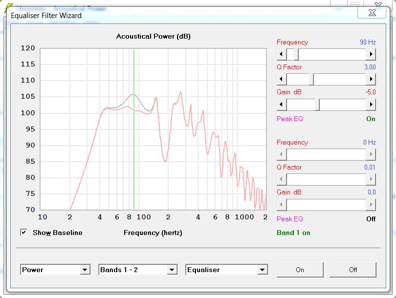

‘Unwanted resonance’??An EQ setting of F=90 Hz dB=-5 Q=3 will have a pretty narrow effect. That's a setting I'd expect to see when trying to tame an unwanted resonance, rather than reduce output over a wider set of frequencies.

?!? An untamed resonance? It does effect a large part of the bandwidth of the design.

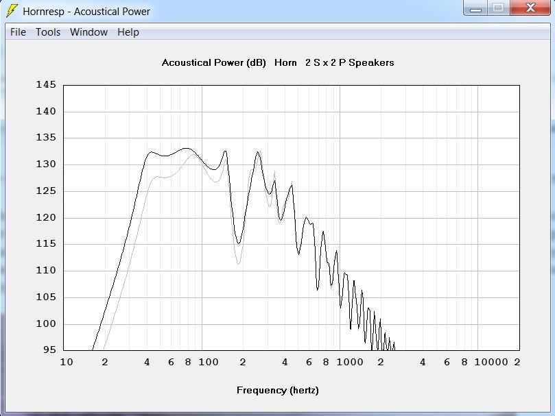

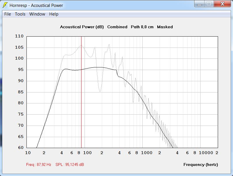

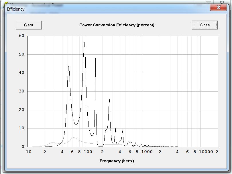

Hornresp does seem to agree with me on the efficiency difference between a BR and a ROAR with the same driver and drive voltage from the amp.
That is a huge difference!Hornresp does seem to agree with me on the efficiency difference between a BR and a ROAR with the same driver and drive voltage from the amp.
As Brian asked, how many liters is the ROAR compared to the BR sim?
The ROAR15 is 347 liter system volume compared to 110 liters for the BR (hornresp sim).

Quite possibly. I did this by ear and it just sounded better to me.

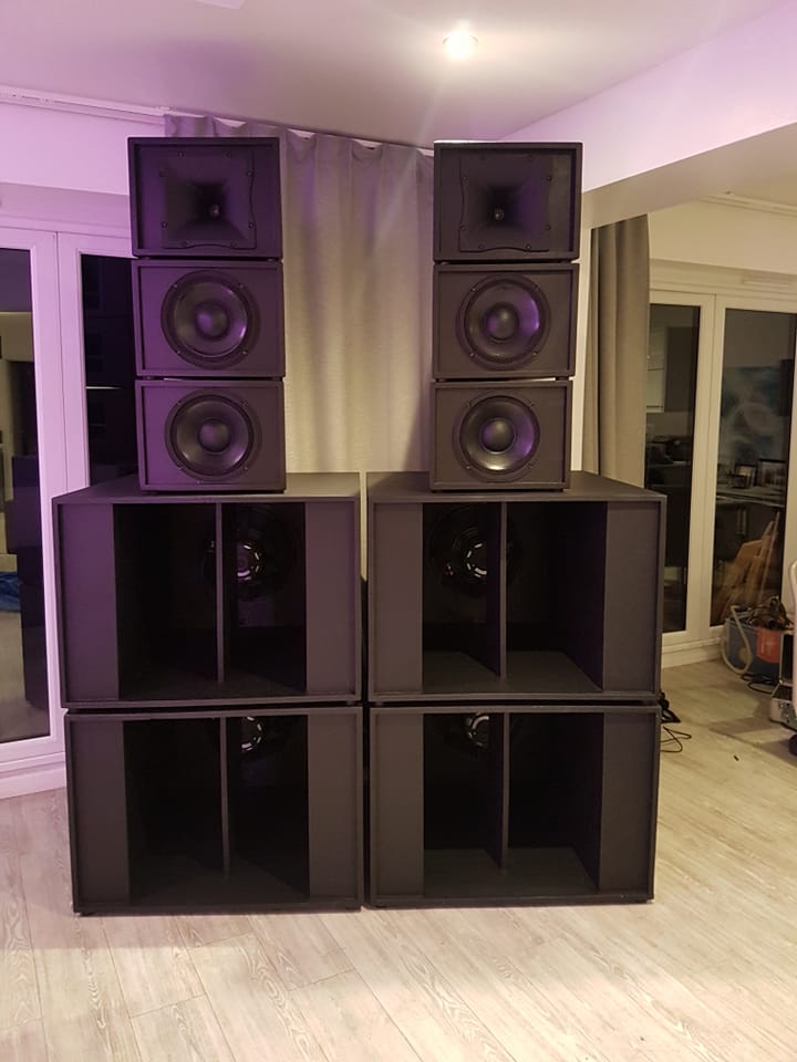

They are much bigger and a pain to move about, compared with the smaller BR ones which were <30kgs and easy to move about. They do just look blooming big but for the extra output its a no brainer.
If I understand you correctly then the ROAR is 10 dB more efficient in the mid bass where most of the energy is centered in music - compared to a BR (?) with the same driver. This matches simulation quite well. One tenth of the power for the same spl!
Nice build! Have you tried 4 of them together with some power? I would guess you will need less EQ for the mid bass peak if you stack a few of them.
Yes the 4 together sounds amazing. Actually in pairs they sound tonally a bit better than a single. not sure why, but they do.
I had this rig outdoors yesterday and the bass absolutely kicked, with the 2 10s up to 700 hz then the bms4594s it sounded amazing, crystal clear and balanced. I have to thank Chris Grimshaw here for helping out on the tuning. Loads of people commented on how good it was. It sounded better than the main stage. The guys from there came over and were amazed at how relatively small the rig was for the output. They were expecting something much bigger. Each sub was getting about 600, maybe 700 rms (1000rms rated, limiters set at 800rms but they didnt get that far). Loads of head room. I'm so pleased with this rig it has performed beyond my expectations.

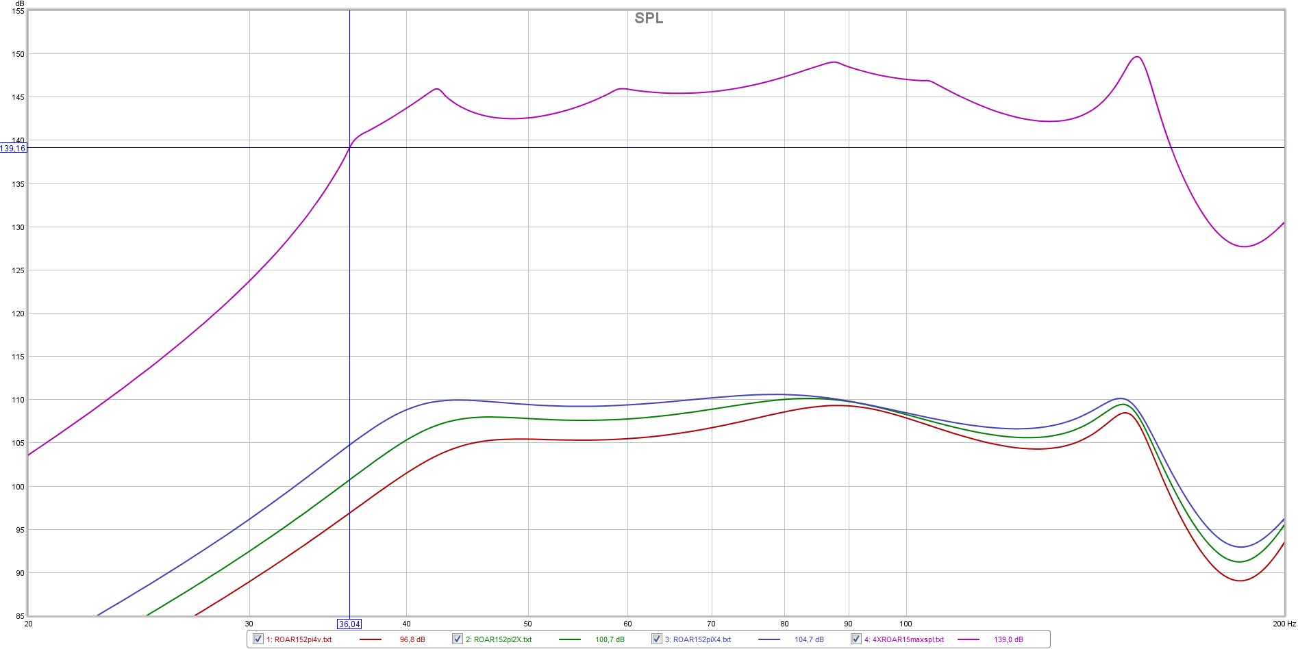

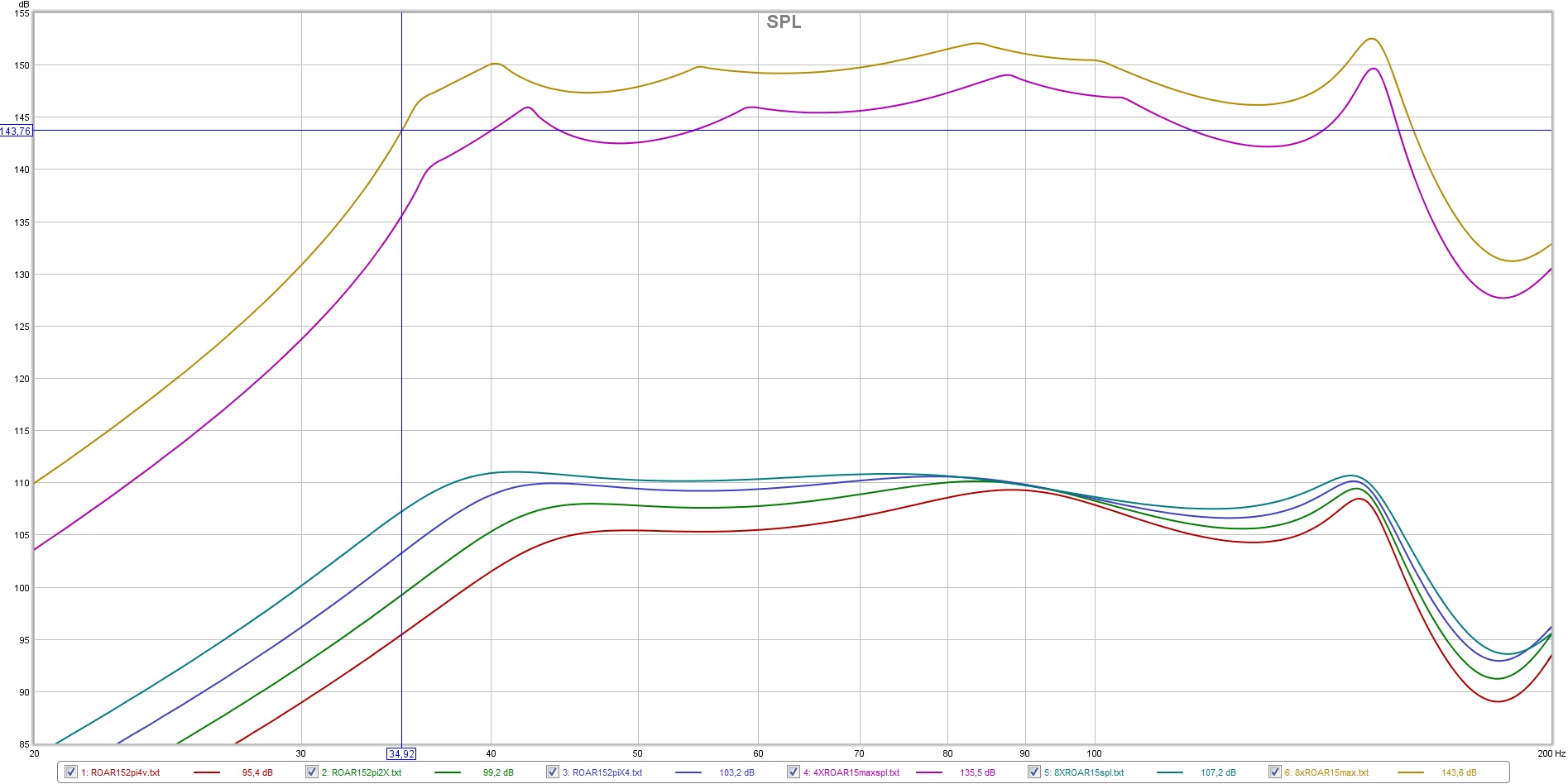

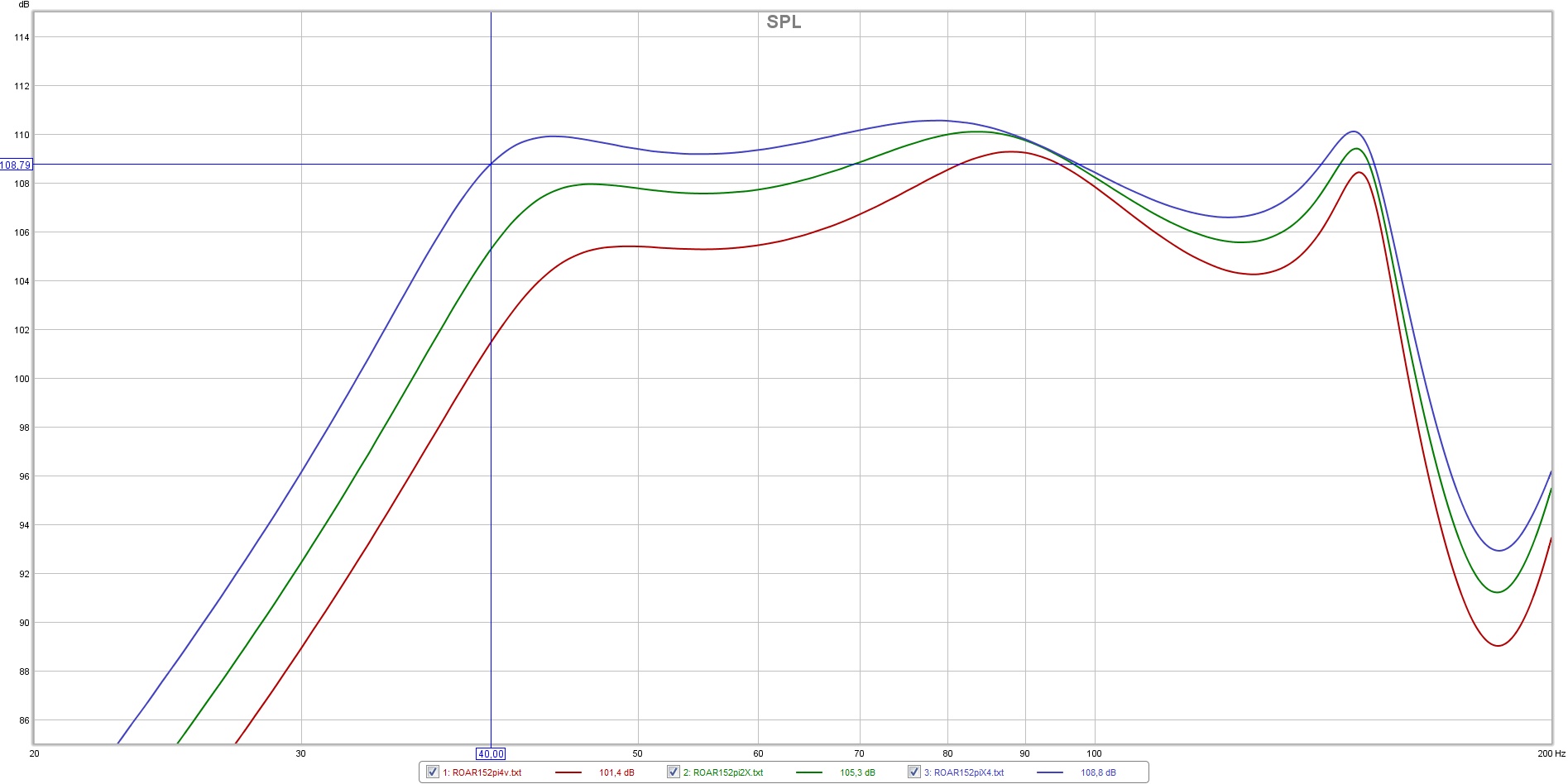

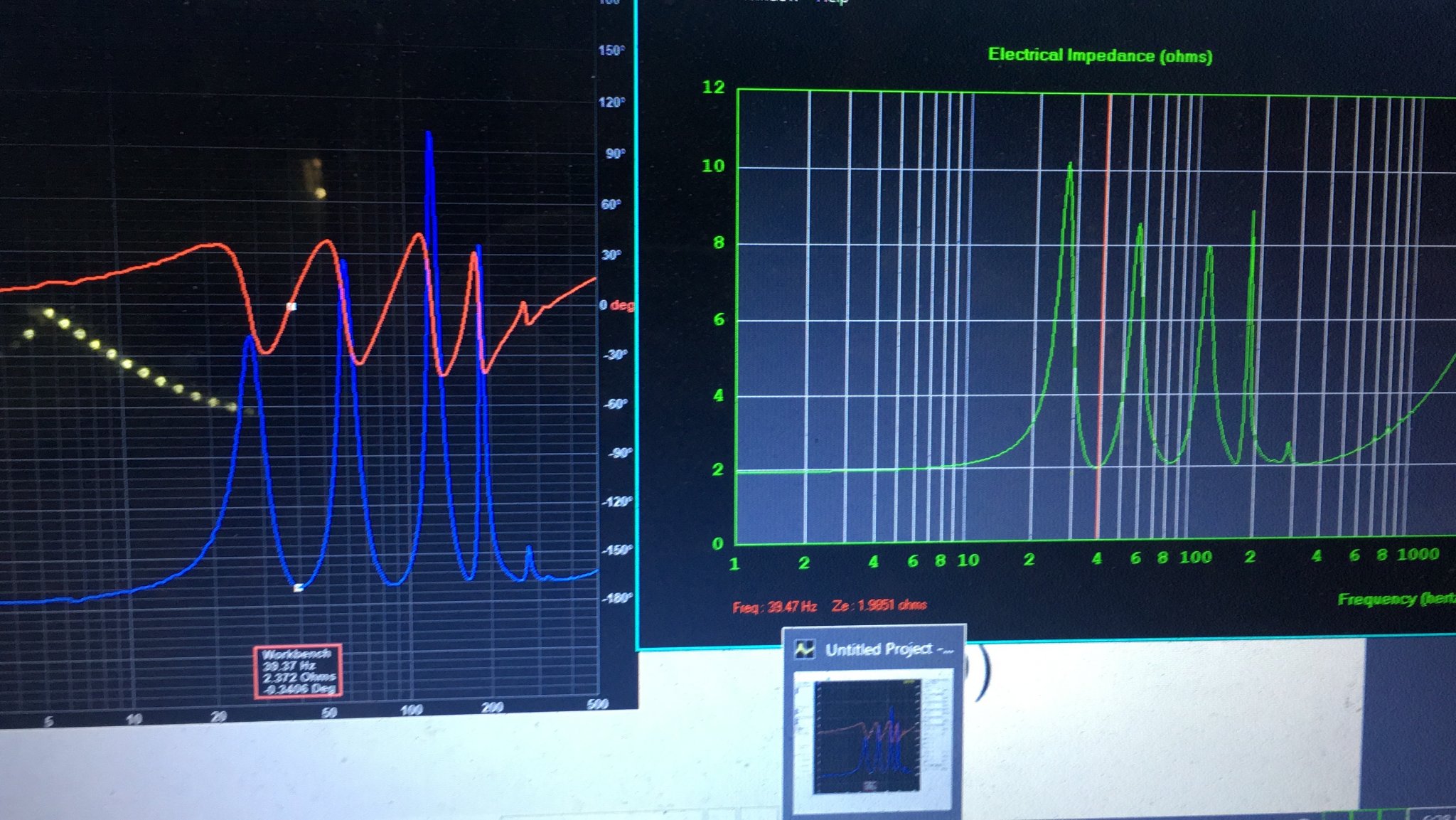

Here is one, two and four ROAR15 with Faital Pro 15HP1060. I adjusted the drive voltage for each step up in number of boxes in the simulation. 4.0 Volt for the single ROAR15 (red). 2.83 Volts for the double (green) and 2.0 volts for four of them stacked (blue) (all parallel).
I do think it explains the "sounding better in multiples" experience you had.
4 large front resonators seems to couple together and move the design further towards a crude stepped exponential horn. You seem to gain a few Hz deeper response with four of them stacked. I would love to see this behavior measured and verified in real life.
Here is simulated max spl for a stack of 4 ROAR15 loaded with Faital Pro 15HP1060. 2000 watts for each driver and 12.5 mm xmax.
It is designed for a solid 40 Hz response from a single box in real life. The spl graph does not readily show this, but the cone excursion graph and the max spl graph shows the true usable extension better.
The 4 together looks like a great response which is made me even more determined now to build 4 more and have 4 either side as a stack (when needed).
One of the Djs played some drum and bass with a couple of the C0# bass notes (35hz) and I thought, actually, that still sounds very much there still.
Thanks for your time and input. It very much aligns with what I could hear.

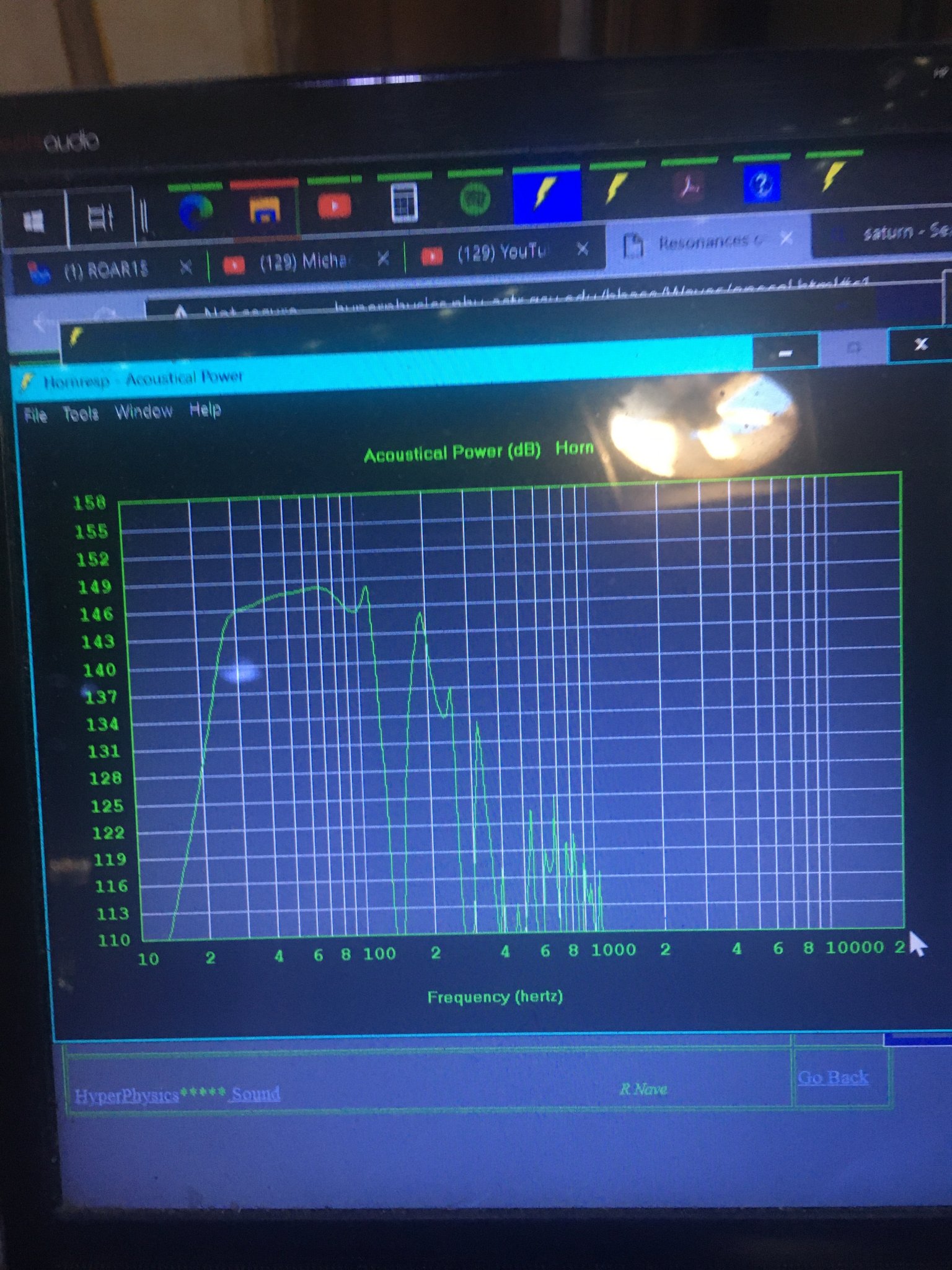

Still typical bandpass response.
ROAR = BP6S.
TH = BP6S.
TQWP (TQWT) = BP6S.
T-TQWT (T-TQWP) = BP6S.
All 4 enclosures can be modeled in HR with the TH function.
The ROAR and TQWP can be modeled with any BP6S type function in HR.
