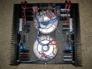

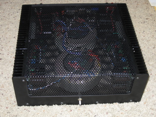

Ver. 2. Done with amps now. Speakers only from here.
Sheldon
Very business like. Cool. Got the harmonic field gremlin even down lower in this config I would suppose.
Yes, a little lower. But it's hard to get to absolute zero in a stereo amp with transformers like this. I had to rotate them in a few iterations to get lowest value, and they interact somewhat. So it takes a few back and forth. Couldn't source transformers like Mihai's, which should have lower leakage still.
I'll probably dress up the front when I get an inspiration.
One annoying issue, is that I have one pair of opt transistors on one channel that bias at about twice the current as the rest. All the others are within a few mV. I tried to find some more to select from, but the main sources here (Digikey, Mouser) don't carry them any more, and I can't find any others that will sell less than 150. I used NJL3281/1302D. Anyone have a source outside the U.S.?
It doesn't seem to affect distortion, but are the hot pair likely to current hog if the amp is pushed hard?

I guess the hogging scenario is a worry. The designer will tell if it is feasible to degenerate them more so to get them even for current without side effects, if you can't readily find a matching pair to the rest.

To reduce (get rid of) this transformers hum issue you can try to dress them up in a permalloy shield.
Did you build RMI-FC100 MK II version or rebuild your first try?
Where did you find NJL, 2SA1360, 2SC3423, 2SK170 transistors? As far as I know only NJL types are available on Digikey and Onsemi.
As far as I know, Mihai has only published the original version. The hum is not much of an issue. Can't hear it unless my ear is within a cm or so of the diaphragm. Not worth a permalloy treatment.
I got the LSK from a DIY audio group buy, and the 2SA/SC from Bent. Got a few left, but probably not many matches.
