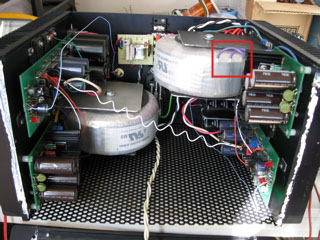

Here's a more detailed pic of the wiring.
The green thing between the 4 smaller power supply caps, is a film capacitor that connects the main star to the chassis (green wire going to bottom center transistor mounting screw).
The only other thing that is not self explanatory, is the small red/black twisted pair. Those take power from one rail to the relay for the soft start circuit. Not much current draw there, and I have checked the system with those disconnected - no effect on hum.
Leakage from the transformer should be primarily along the center axis, which is over the power supply part of the board, so I don't think this should be too much of an issue. Again, one channel only, affected.

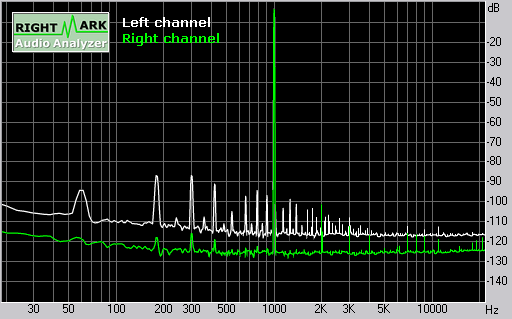

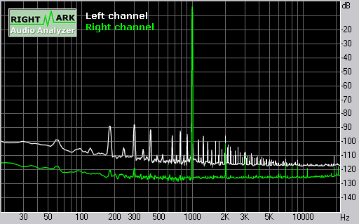

Thanks for all the suggestions folks. I went back and simplifies somewhat. I removed the front end ground lift. I got rid of the shielded feedback connector. I found that neither were helpful, and just make things messier. I connected just a fine guage wire for the feedback connection, but on the bottom of the board to R24 - just because it's easier to get at. I left the front end ground connected between c10,11.
Redid the measurements, but properly set up the card this time. I think Mihai will be more pleased with the outcome. Right channel is still just a tiny bit noisier than the left, and a touch more second harmonic. But, the hum is only audible if I stick my head all the way inside my 100dB horn. So completely inaudible just a foot away. The actual dynamic range is larger than the graph makes it appear, as the card cannot take anywhere near full power, even with an attenuator on the output of the amp.
Left Channel
Left Channel
Are those field induced hum spikes on the left channel? Is there some more proximity to something than to the right channel?
I have seen in my projects that the strongest emission point with toroidals is the secondary exit points. Try to rotate if you have some slack while measuring and see if something changes. The different level and front to back distance of toroid mounting can be giving some more filed to one side in a different manner than to the other?
Salas said:Are those field induced hum spikes on the left channel? Is there some more proximity to something than to the right channel?
The two channels are layed out exactly the same. Just one is inverted relative to the other when assembled so that I could make the case a little narrower.
Ignore the Left/Right designation on the graph. The signal is the white trace. The green trace is just the card loop back. Left channel is the first post, right is the second. This shows noise at -90dB, but it's actually lower, as I have to limit the input to the card. As measured on the scope, it's over 105dB down.
Sheldon
Edit 3: I see that you have outlined the exits for the front end secondaries. Next time I open it up, I'll rotate the transformer some and see if anything changes.
Aha. So its a common thing between channels. So your 0dB level isn't calibrated against 1V. What is the Voltage level of the signal spike on the graph? Of course SNR will go up with more output voltage delivery, but the noise floor level is the standard bottom. Try the rotations IMHO. If you improve it enough the amp will sound softer, deeper in 3D and more resolving. It seems adequately low, but its a gremlin. That comb extending far high is eating away resolution. Got to listen unmistakeably finer each time I have eliminated a not so obvious such problem. Its worth the chase. Beautiful aesthetics and construction BTW. Congratulations!🙂
Salas said:Aha. So its a common thing between channels. So your 0dB level isn't calibrated against 1V. What is the Voltage level of the signal spike on the graph? Of course SNR will go up with more output voltage delivery, but the noise floor level is the standard bottom. Try the rotations IMHO. If you improve it enough the amp will sound softer, deeper in 3D and more resolving. It seems adequately low, but its a gremlin. That comb extending far high is eating away resolution. Got to listen unmistakeably finer each time I have eliminated a not so obvious such problem. Its worth the chase. Beautiful aesthetics and construction BTW. Congratulations!🙂
Signal level is about 200mV. Not sure that some of the noise isn't in my measuring system. I have a little preamp that I need to fix, then repeat the measurements.

I have this habit too... In my KT-88 I got rid of such stuff by using copper foil around the toroid, and grounded it. It may well be your driving electronics, of course. What I do is I use a 1:10 attenuator and I run the card at 1V RMS out through it. So it picks up some SNR and then drive the amp at 1W/2.83V at 8R. At about 100mV in, they normally hit the 1W if around 30dB gain. Also the output attn brings down computer psu wideband noise that rides the card's signal in many cases. That way I avoid preamp and I am not afraid of burning the dummy by mistake on output level. If you calibrate the card with a DVM, it will follow exactly what you type in as level. Use ARTA. Its free and has a detailed calibration menu, among other excellent stuff.

Pooge and Salas. Looks like the gremlins are indeed field induced from the transformer. It's not the wiring, per se, as I can push the wires around with no change in the hum/buzz. But surprisingly small changes in transformer orientation make a big difference. So, going to have to experiment, but it appears I can get rid of this background, even in this cramped chassis.
