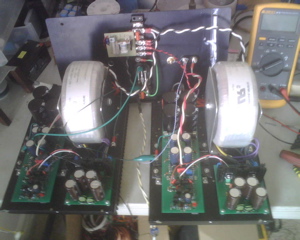

Down the home stretch. Got the parts back from anodizer and assembled everything up. At first, everything checked out fine. Then somehow during the course of testing/assembling, I probably shorted something. It's not the first time I've done that, and I have some spare components, so I was not too worried. Just gotta figure out what I cooked.
In originally assembling the boards, I followed Mihai's suggestion for sensitive speakers, and cut the trace, and lifted the front end supply connection to the main star with a 2.2R resistor. Whatever I'd shorted now, had overheated this resistor in the right channel, so it was now about 100R. I replaced it, and looked for any other obviously overheated components, but didn't see anything. When I powered back up, I noticed slightly more hum in this channel - about 1mV. The left channel reads at 0.1mV on my meter. Also, the offset on the right channel went to about +30mV, whereas the before it was less than 2mV.
I then checked various currents on each channel and got these readings:
R20 right- 1.343V, left- 1.344V
R19 Rch- 1.227 Lch- 1.227
R15,18 Rch- 1.281, 1.281 Lch- 1.278, 1.279
R16,17 Rch- 0.365, 0.367 Lch- 0.303, 0.305
R6,41 Rch- 0.567, 0.555 Lch- 0.747, 0.582 (note, R6,41 are 150R)
The only differences I see, are lower current for Q7,8 in the affected channel, maybe accounted for the the higher current draw for Q19.
Any suggestions on what to look for?

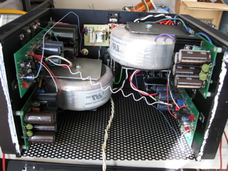

Is that a shorted turn around each of the toroids?
No, there's an insulating grommet on one end of the bolt.
Sheldon
well thought out, you're a brave soul.Sheldon said:there's an insulating grommet on one end of the bolt.
AndrewT said:well thought out, you're a brave soul.
Thanks, but not that brave. The mains is fused at 5A to backstop me.
Sheldon

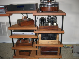

Sounds very nice. I've got it running 400-20kHz, on a multi amped system. http://www.diyaudio.com/forums/showthread.php?s=&threadid=69906&highlight= Can crank it up to very loud (when it's just me at home) and very clean. The compression driver and mids on the horn are crossed passively in this configuration. The FC 100 is driving the horn, and the horn system is corrected and crossed at line level with a DEQX to the woofers. The woofer system is described in the thread. I'm running one Symasym channel per woofer. They are the limiting factor in output for this. I've added Geddes foam to the horn and made some other mods to the cabinets, but basically as you see it in the linked thread.
I can run the tube amp at night for lower level listening and that nice glow, if I like (FC sounds very nice at low level too, and LED's are nice, but not as nice as tube glow). But if I wanna rock, gotta go with the FC.
Dressed up the amp with some Koa veneer, to soften the industrial tech look.
Sheldon

BTW, the problem I had earlier with toasting the ground lift resistor between the frontend and output, was due to accidentally connecting the scope ground to the positive output. That resistor needs antiparallel diodes for the careless. Apparently I damaged Q10, because replacing it got everything back in line.
Sheldon

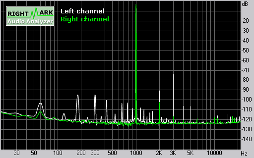

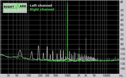

some measurements
I get a slight amount of buzz on the right channel. It's very faint, but the left has none, and I wonder where the difference is. Seems the PSRR is slightly degraded in the Right channel. Could be I partially cooked something in all my adventures - would not be anywhere near the first time. It's not due to layout, as they are identical. Anyway, you can see the difference here:
Left Channel
Left Channel
Rule out a ground loop between your amp and preamp (although that would more likely be a hum rather than a buzz.) Turn off your amp, disconnect one of the connects to one input channel, turn on amp, and check for buzz.
Edit:
Whoa. That's at 1 khz. Maybe getting some rf rectification???
Edit:
