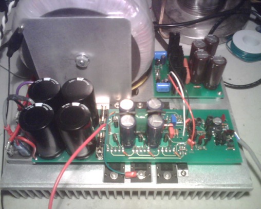

I've got a pair of mono modules assembled on the heatsinks and ready for the finishing casework. Everything looks good, with one exception. That is, I get around 5-6mA offset. I don't care much about the offset per se, but that, combined with 2-3mA variation in the individual output device current, makes it impossible to get all the output devices within the optimum 15-20mA bias current.
First, is this much of an issue?
Second, is there any convenient way to trim the offset?
Sheldon

One thing I noticed, is that the offset starts out negative, goes positive over the first minute, then gradually increases to the final level as the sink warms to steady operating temperature. Does that provide any clue as to where I might tighten things up, if any of the modules have higher offset?
Sheldon
Playing around a bit more, and blowing a stream of air from a tube, I found that the biggest effect was on the JFETs (as Mihai proposed). If I cool the input FET, the offset goes towards the negative. If I cool the other one, the offset goes more positive. Might see what I can do by swapping.
Sheldon
Sheldon
Bound them together with a thermal compound between 😉
I got 0.2mV output offset.
The input pair are thermally coupled and bound with three turns 0.5mm diameter copper wire.
The output emitter resistors are matched to <0.5%.
Measuring output or bias currents through unknown or loose tolerance resistors is a complete waste of time and effort.
