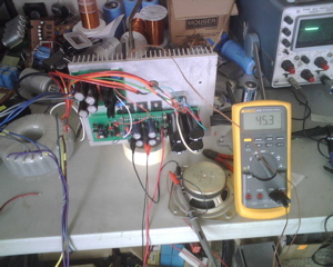

Up and running. Makes music too. Now time to get the enclosure worked out.
One question: The transformer has dual windings. So choice of one or two bridges per channel. any strong opinions either way?
Sheldon
Edit: Don't know that it's necessarily a problem, but it doesn't like to be messed with. I left the input open. But if I touch it with a probe or lead it likes to oscillate and blow fuses (5A rail). A little buzz though the speaker when I do this, but nothing crazy, so it must be HF.

I saw in your previous picture that you have an oscilloscope. Use it to trace any spurious oscillations. Pass through the amplifier square waves, with 8 ohm loads.
If you find something suspicious you could decrease R6/R41 to 150...120R

It's an old Tektronix 454, 150MHz at 20mV/div. I'll check out the cascode transistors (1kHZ SQW OK?), and swap out R6/41. If I get anything interesting, I'll post it.
Thanks Again
Sheldon
Thanks Again
Sheldon
Gotta get some more fuses. All OK, until I start probing the front end. Doesn't like that much. I don't know exactly where I did it, so I'll have to track it better next time.

I'm gonna make the fuse company happy if I do too much more testing. I'll poke around with the output unpowered. Amp seems stable on its own, but it's hard to find where the problem is. If I just unplug the input from the signal generator, and try to plug it back in with the amp on, the rail fuses go. Yes, I know, not generally considered good practice to connect and disconnect with the amp on, but it shouldn't oscillate severely, that easily. I'm not sure how to check without the fuses going.

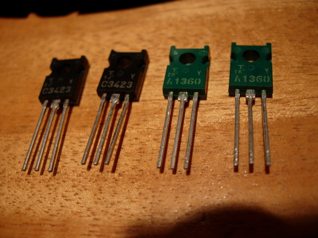

Do these look legit? Got them here: http://www.bdent.com/search/part.jsp?partnum=2SA1360#
Sheldon

With the output unpowered, all the voltages/currents check out for the front end. Currents for the back cascode/mirror (R15-18) with the outputs powered are very close to the unpowered state. Didn't dare poke around to much in front of that with output power, as that's when the fuses go.

roender said:Your A1360 seems to be fake 🙁
This could be a problem if the chip inside don't have low Cob
This, of course, begs the question: Anyone know where I can get genuine parts, this time Y versions?
