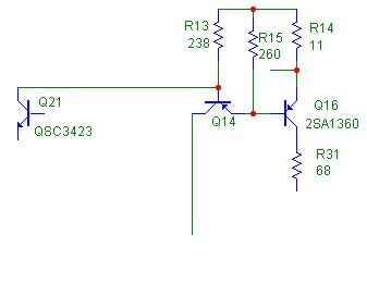

edit: Actually, it looks like I wouldn't even have to modify any traces. A few components removed, a couple of free standing connections, and some jumpers. If I didn't like the results, easy to go back.;[/QUOTE]
Looks like all I have to do is remove from the original schematic Q11,13, D2,7, R15,18, add appropriate jumpers, add R14, 15, 31,34(as shown on the MkII schema), and switch the drain and base on Q14. I don't need to cut any traces. But I do have a couple of questions for Mihai, or anyone who can answer them:
I assume that the change of C21 (feedback cap) from 470-330u is of no particular consequence?
C8,9 were changed from 15-22pf. Is this an important difference? Or is the ratio of R31,34 and C8,9 the important parameter?
Mihai suggested that at 100mA bias for the drivers, that C1 was not needed. The MKII schematic has it back in, with 0.8R in series. I take this as the preferred set up?
Finally, R19 changed from 91R to 96R. However, it looks like the current hasn't changed for the input bias string. R16,17 for the current mirror haven't changed, but it looks like the current there has changed (unless I'm adding thing up incorrectly - a distinct possiblity). Is the difference important?
Like I said, unless Mihai says otherwise, I'm game to try itl.
