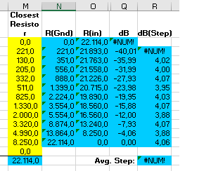

With only 11 steps, 1 being "-inf", half of those being above the usual listening volume position, it's inevitable that the steps will be larger than ideal.
The rest really comes down to knowing in advance what the listening range of attenuation is going to be. One way to check is to note the position on your existing volume control, then (on a similar unit) measure the resistance between wiper and ends, and calculate the dB loss.
Perfect, thank you so much for the information, I didn't get it at the beginning.
At this point I think I will just try with the current setup, modifying and testing it until I don't get the values I prefer.
I will post the final result in case someone wants to try it.

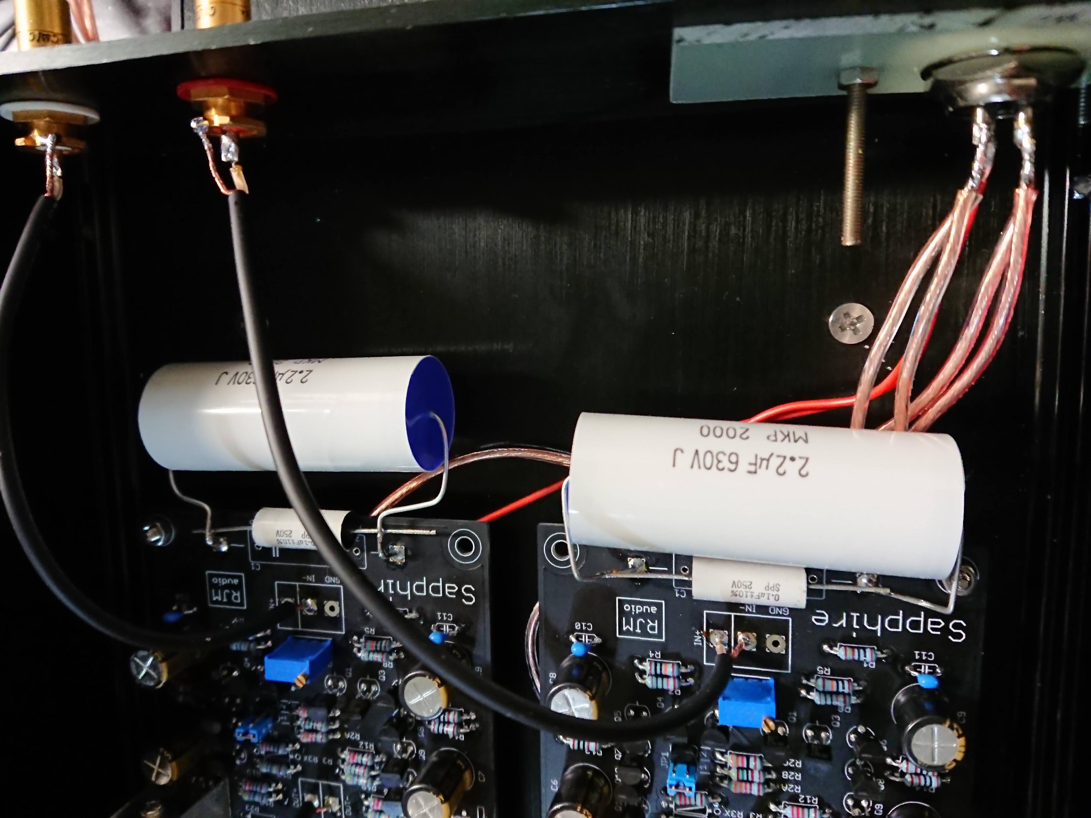

And you tried not to use C1? This is best for sound.
You can't remove C1. The input to the Sapphire is DC biased by R4,5,6 with an offset voltage to control the output offset. Remove C1 will short the bias voltage though the input component.
What could be the practical consequences of removing C1? Danger to Sapphire or input component?
There are two obvious issues. Without C1 you have a DC amplifier. Any DC offset on your input signal will end up on the output, multiplied by the gain. Second, the trim pot. which is used to adjust the DC output offset to zero no longer functions. So even if you don't have any DC on the input signal, you may likely have a large DC offset on the output regardless, and no way to counter that.

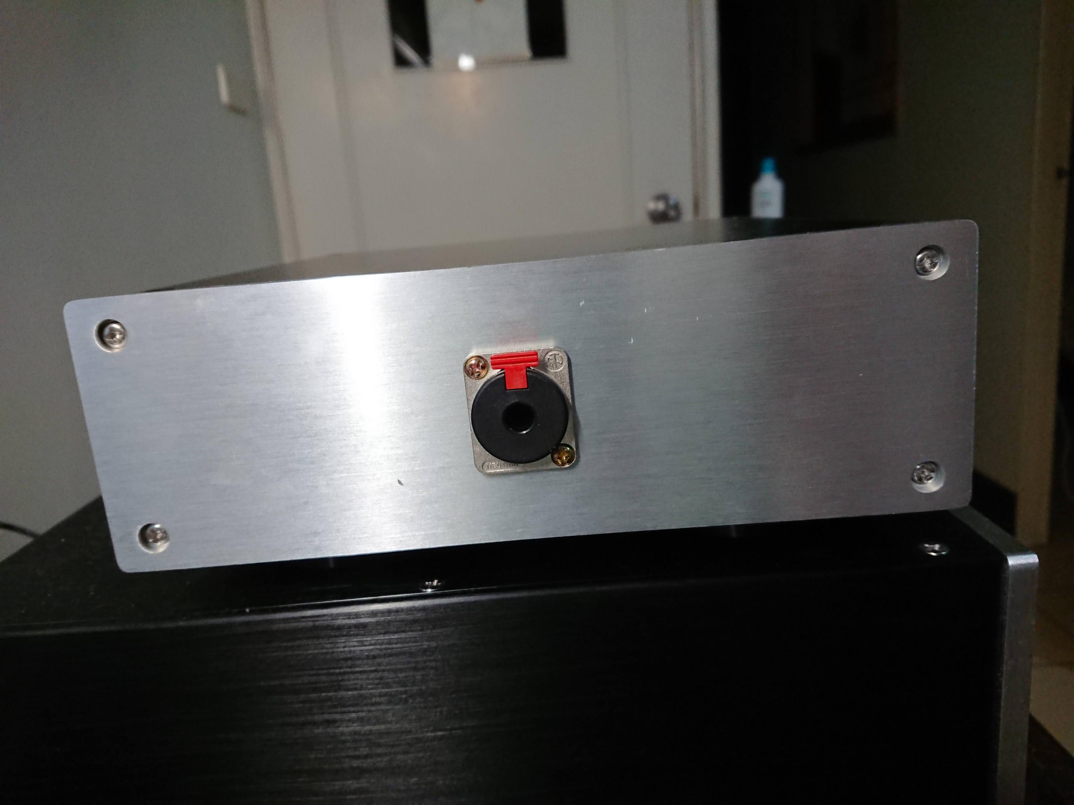

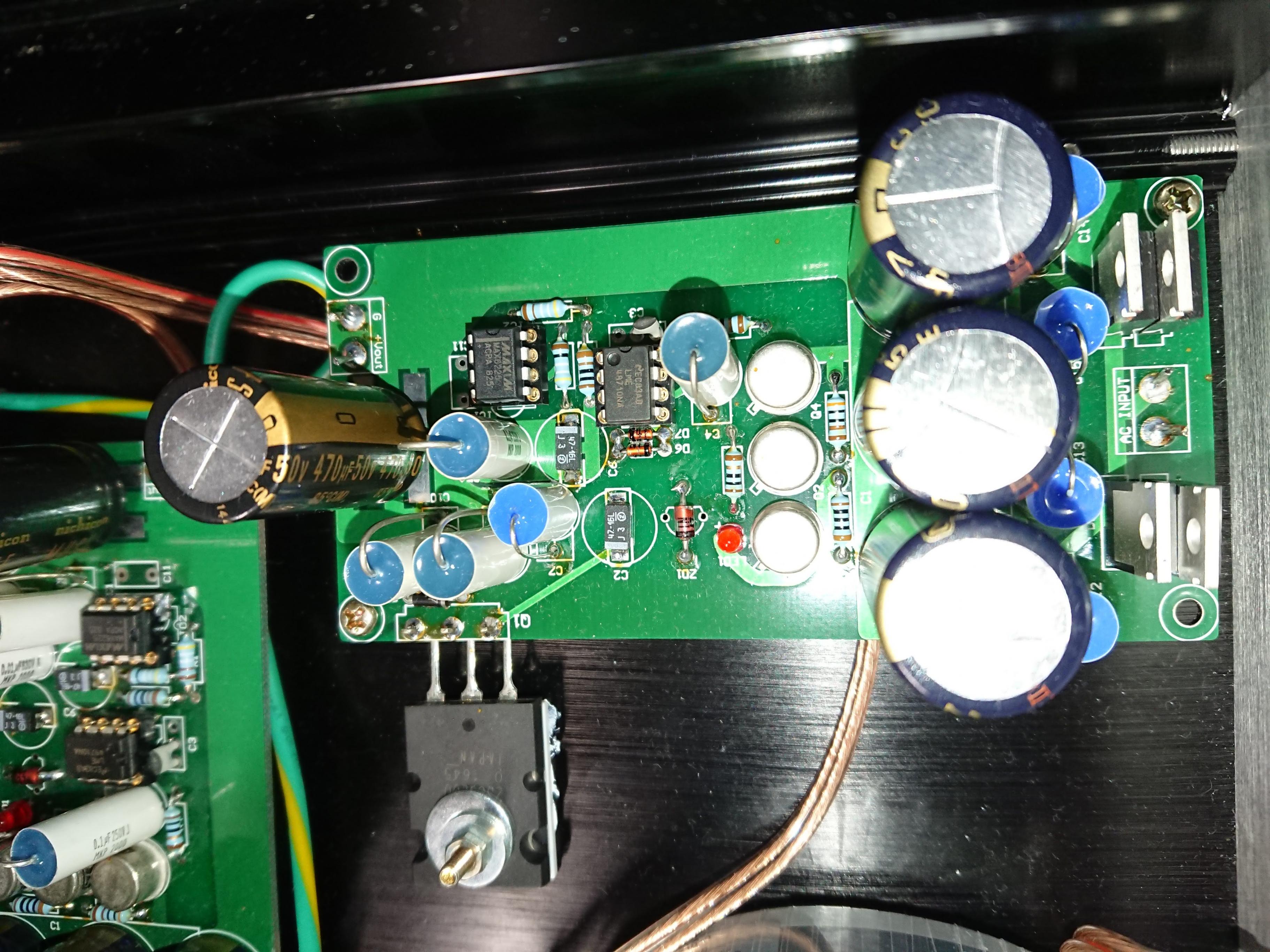

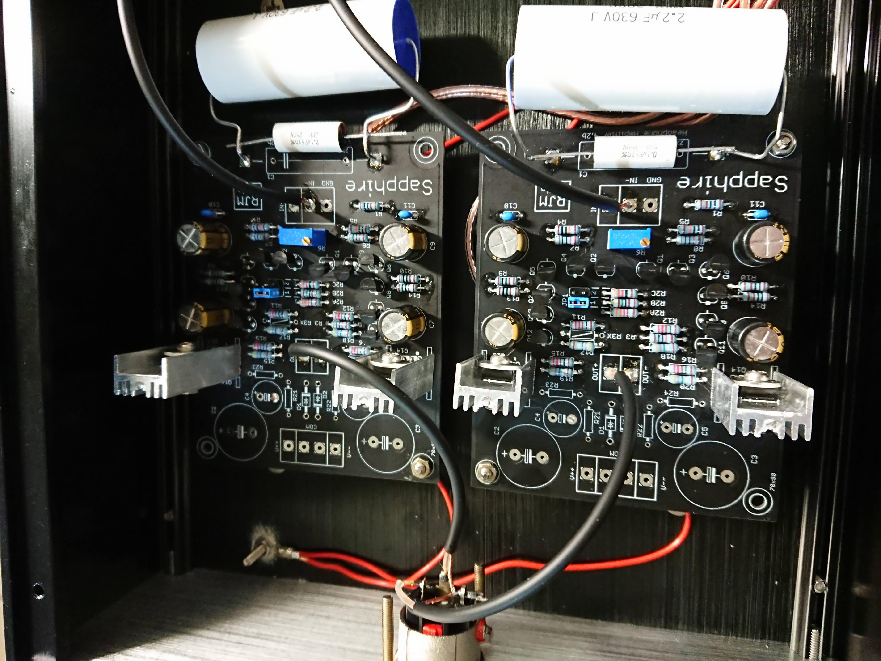

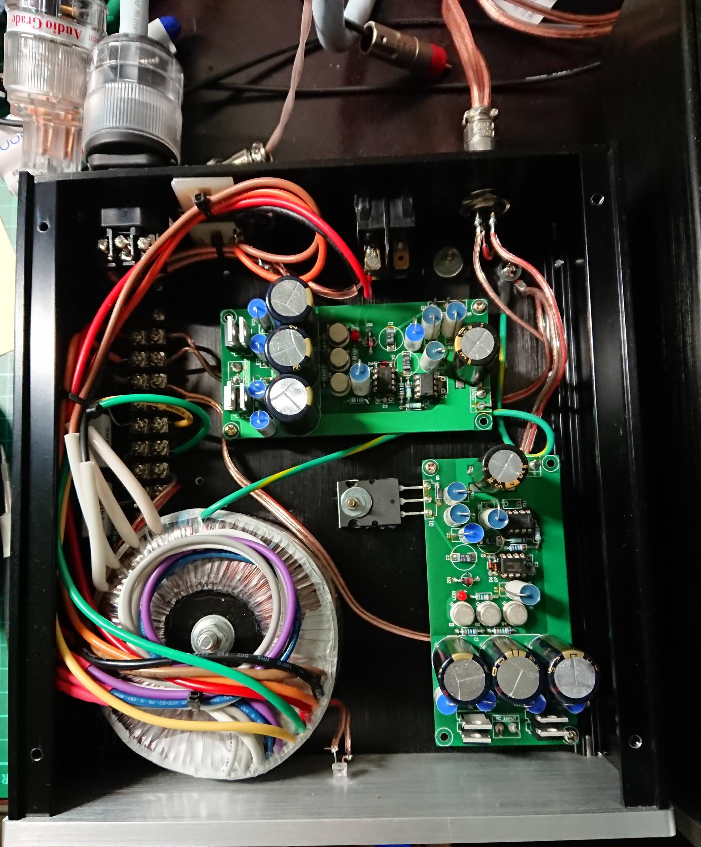

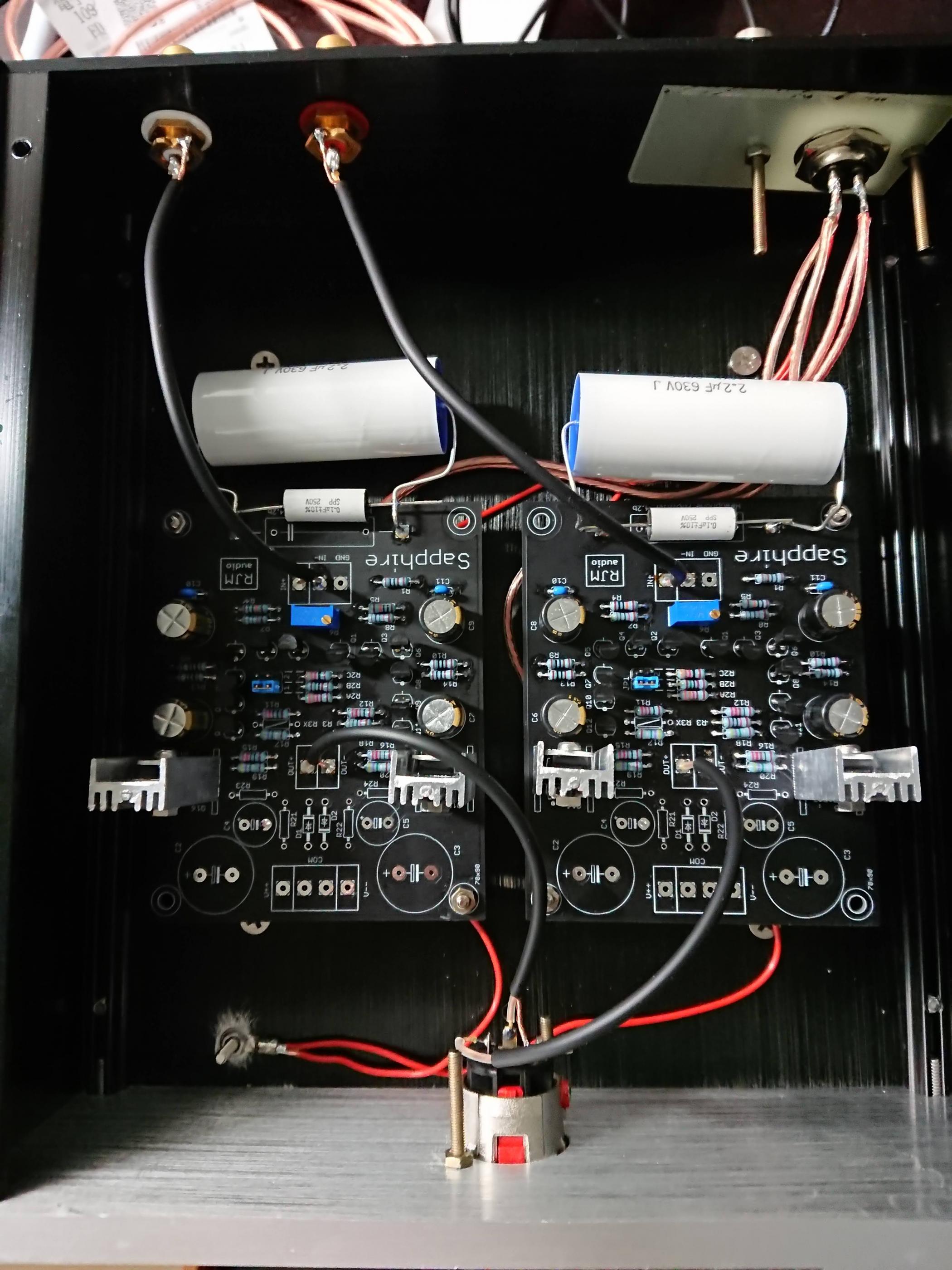

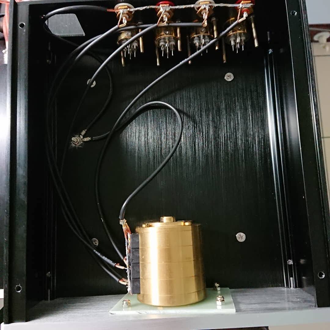

Hi, Guys,
I finished the Sapphire headphone amp, Finally.😀
I order the kit of Sapphire, It is easy to build with very well designed board.
So, I successfully done the kit once, without any mistake.
My Sapphire is different from the original.
First, I change the PSU. What I use is the GR regulation that is designed by a Taiwanese. The GR regulation use a highly precise and ultra-low noise voltage reference IC and a op amp for error amplifier.
The last, the VR is Alps RK-50, it is located in another case.
The sound is awesome. With my ATH AWKT, it sound smooth and clear, with good punch. I like it.

Thanks for sharing your build. The Sapphire is open to power supply mods, though the Z-reg built in to the main boards is quite sufficient for the purpose. You can even run it from unregulated supplies, like you would a power amplifier. It really comes down to what sound you prefer.
