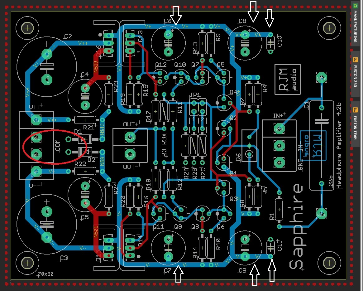

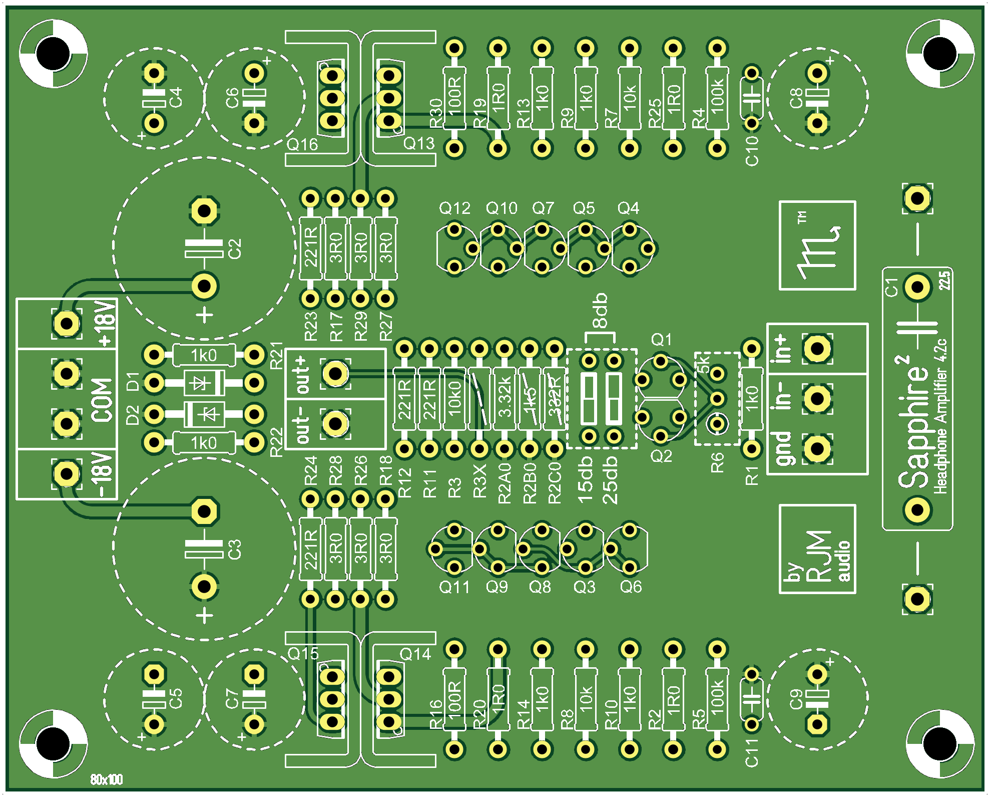

The schematic on your webpage shows an output stage with multiple To-92 devices whereas the PCB shows single bd139 or similar in the output stage.
I believe one of them is wrong or at least another version.
What are these versions called/referred to?
Thanks!
Probably not, and I only have the 4.1z and 4.2b boards myself.
As you note, though, there are Gerber/.brd files floating around so you can get older versions made if you prefer.
Having listened to all the revision history, the "4" (all discrete) is superior to all previous versions of the Sapphire using op amp input stage.
-Richard

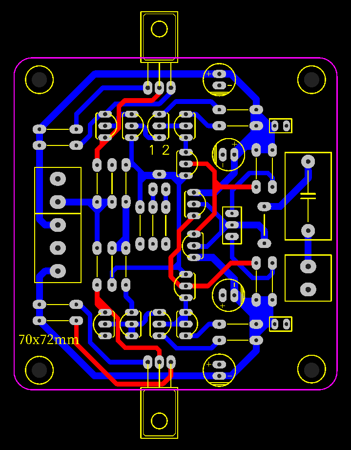

I´d love to do a tiny SMD-version but don´t understand hfe-variations enough to proceed with it.
If I take the simulation file that was attached earlier (sapphire_41m_thd.asc),
the BC327-25-model has a hfe of 385.7 and the BC337-25-model of 292.4.
Simulation of DC-offset looks fine. Even with a hfe-variation of +-5.
But let that variation get bigger or change the absolute values of the models and DC-offset quickly can become >100mV.
See attachment with "original" hfe-values with variation of +-20.
If I make the hfe of npn and pnp the same it still doesn´t work out to 0V offset.
Probably need some time to digest that.
