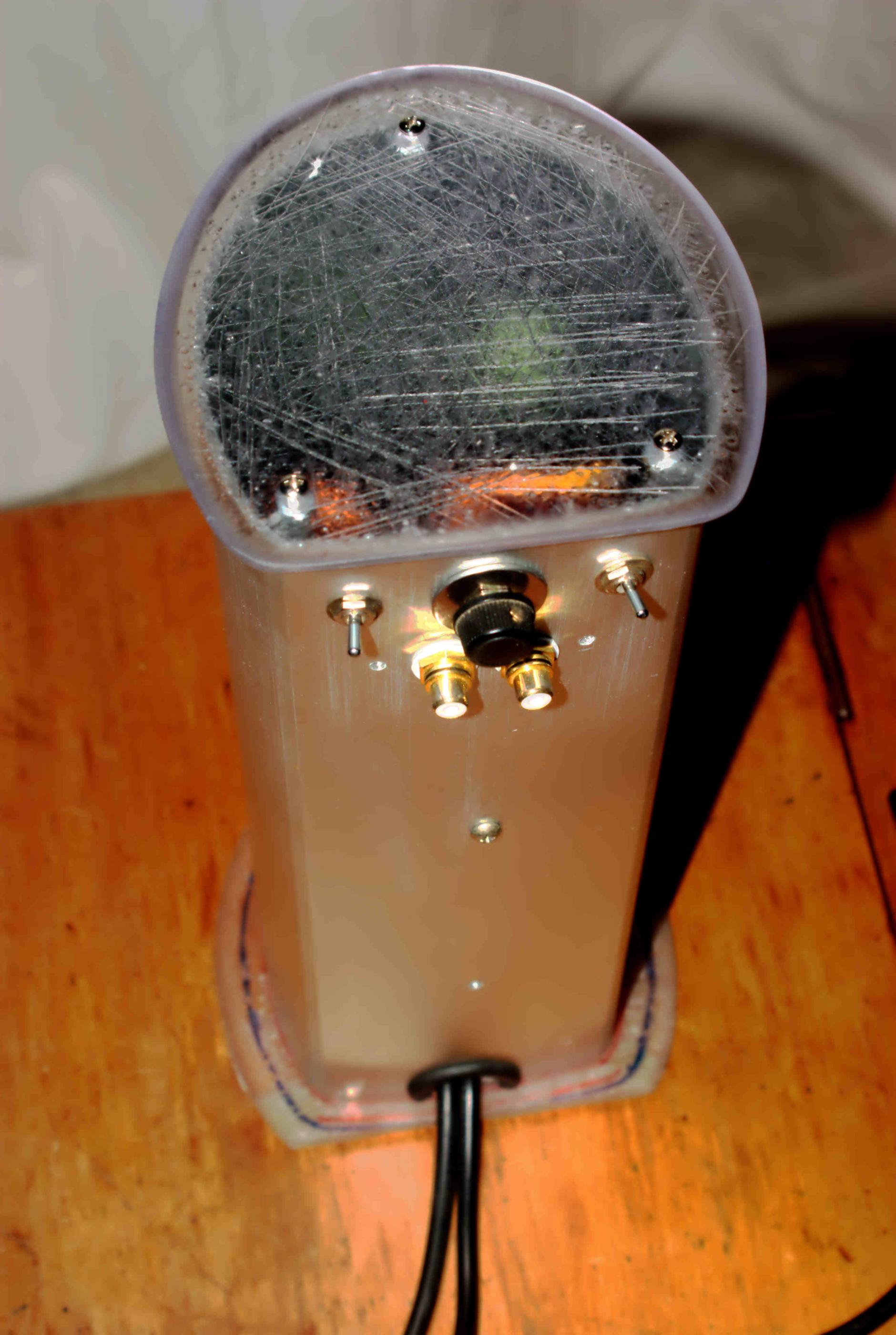

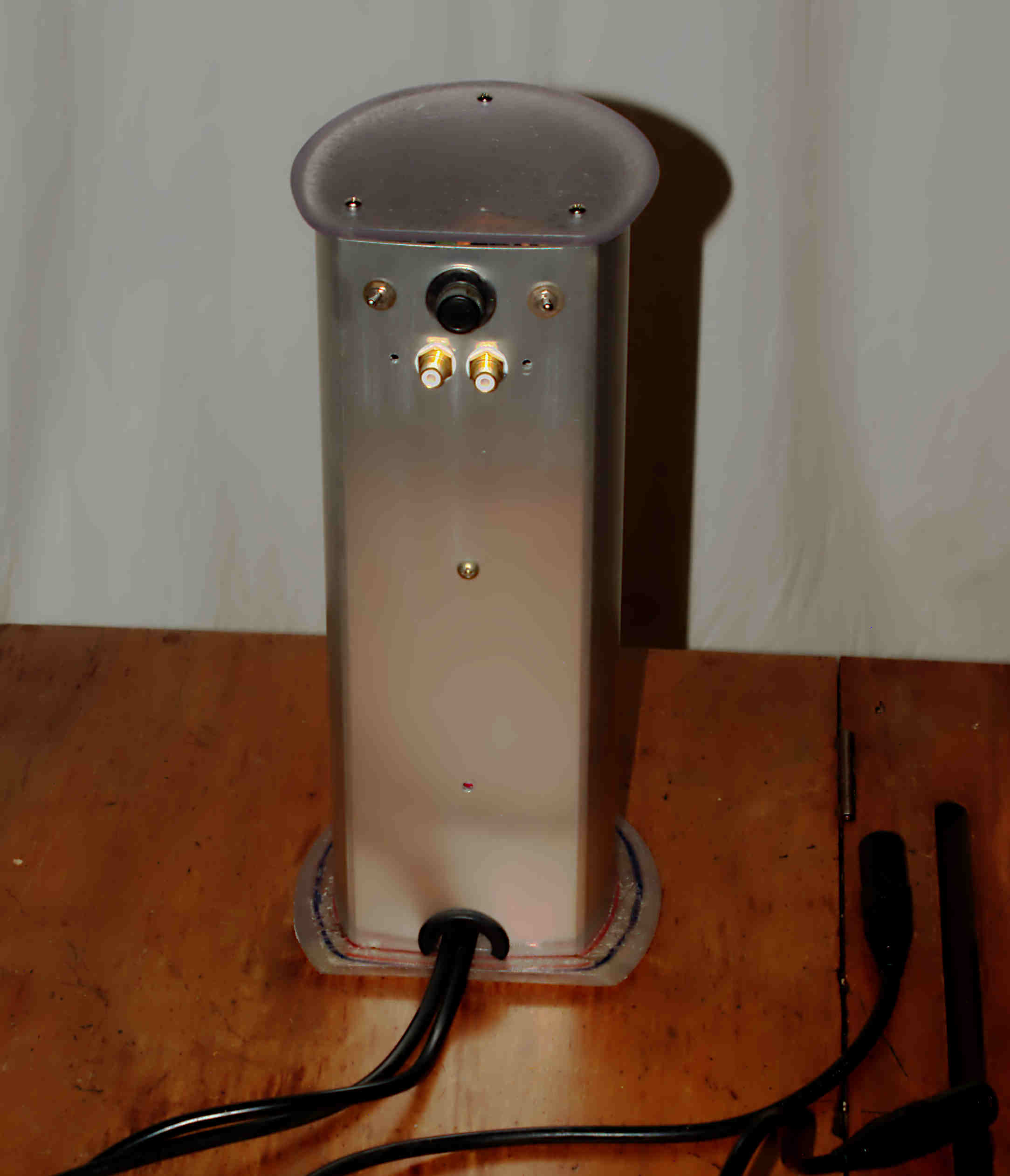

build the Sapphire in a 150 mm dia. pipe
Yes...that is my build too. 🙂

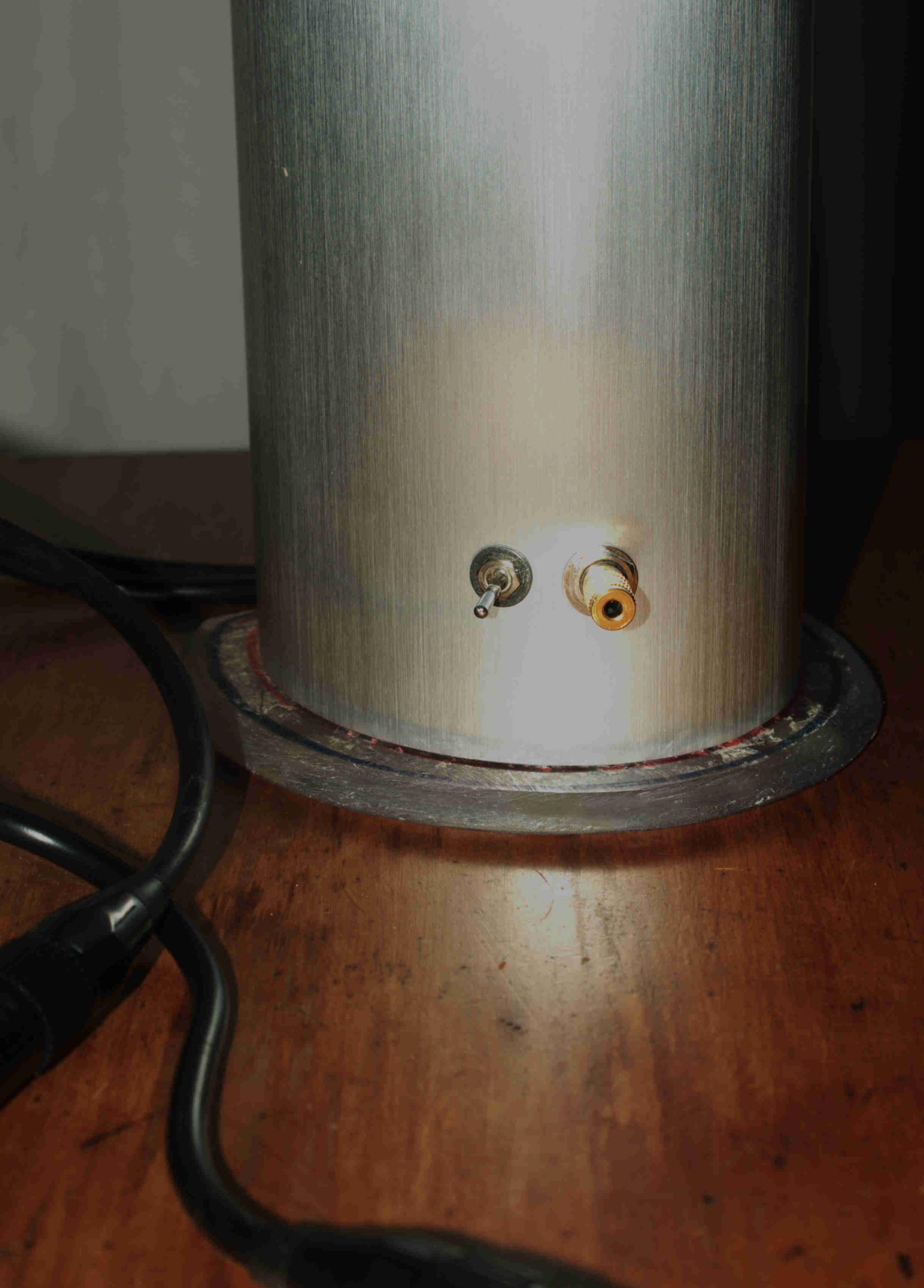

Using a d-section aluminium tube...and umbilicals. Only vertical.
Functional but still to finish appearance.
Front has H/P out and mute switch.
Back has inputs and toggle switches for direct or pot... balance can be made too by switching 1 ch to pot and adjusting.
Boards are mounted nose to nose on a slide-out plate as the 'tube' has a pc-board slot.

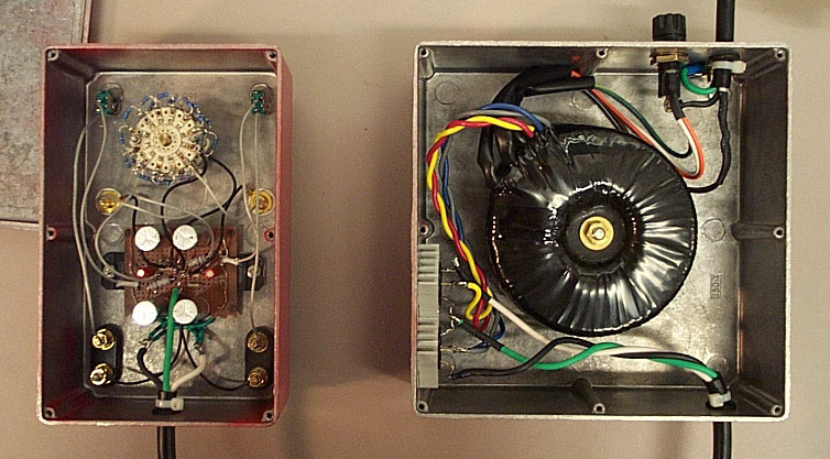

I'd put the rectifiers as the box with the transformer. Route V++, V--, and COM through the umbilical as per the standard Phonoclone/Emerald builds.
Thanks for the suggestion, will likely take this approach.
One other thought I had was to also add 2 bulk filter caps in the PS box to output smoothed DC. Then put potentially smaller caps on the board inputs. Thoughts?
On paper that works, in practice it's best to put all the capacitance as close to the amplifier as possible - and to not use more than you need. You won't need enormous amounts anyway, and there is room on the board for up to at least 3300x2 uF.

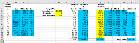

On post 18 there is an excel that is used to calculate the resistors values for the attenuator.
Do you think it would work? In case it does, how many db of max attenuation should I aim for? (I have my unit set with R3 10kΩ and R2A 2,21kΩ so it gives me 10db)

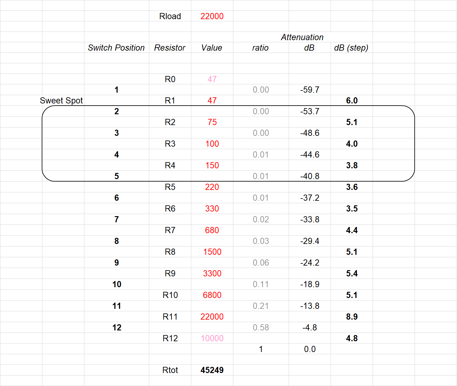

You may find this helpful. It's the excel worksheet for the 12 position attenuator I made back when I built my Gainclone.
@Kass

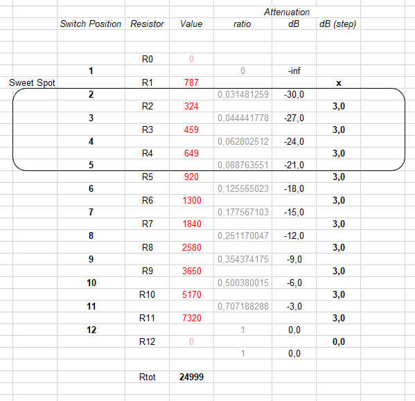

Thank you! I'm using the .xls right now, comparing the unloaded tab with the values I've found in another .xls.
I've attached the results so you can look at them, the values I have set are all avaiable as Vishay's RN55.

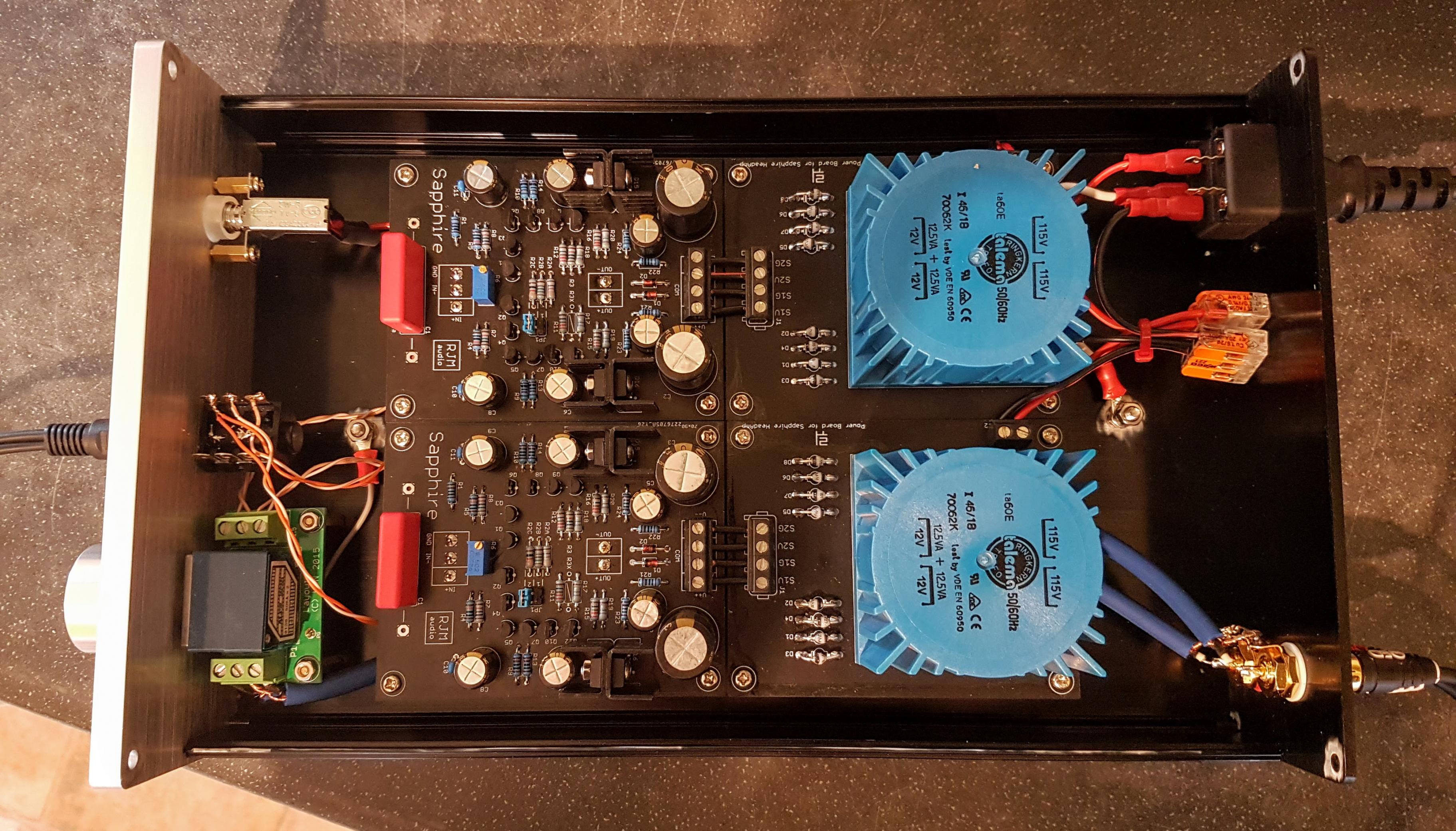

Just like to say thank you for making this available, I finished it last night. I built open loop and I've had it fed by a Samsung Galaxy S7 and TEAC UD-501 into Sennheiser HD650 and HD569. It's very enjoyable, perhaps a little brighter/more detailed/clearer ?? than my Ray Samuels XP7 clone.
The design manual is excellent, very helpful for novices like me!
@Kass
That's an awfully big jump from "-inf" to -30 dB. You can reduce the gain of the amp if you need to, though, so it should be OK. Personally I'd start at -40 dB, and keep some of the steps closer to 0 dB larger, at 6 dB or more. Getting the steps evenly 3 dB, or making the total resistance exactly 25k, are not important design goals.
@NealJ
That looks very neat and professional! I notice the matching custom power supply boards, a nice touch. Try listening to a few difference sources as well as the TEAC, to get a feel of what is the sound of the Sapphire and what from is the ancillary gear. I find the Sapphire a good match for the HD-600 so your two Sennheisers should likewise click with it.
@NealJ
Thanks Richard.
The power supply boards were uploaded to this thread by another member.
I will have a listen to other sources as you suggest before this makes its way to my shed/office.
I have tried all gain options and find the 15dB setting is a good compromise for the two 'phones I have.
