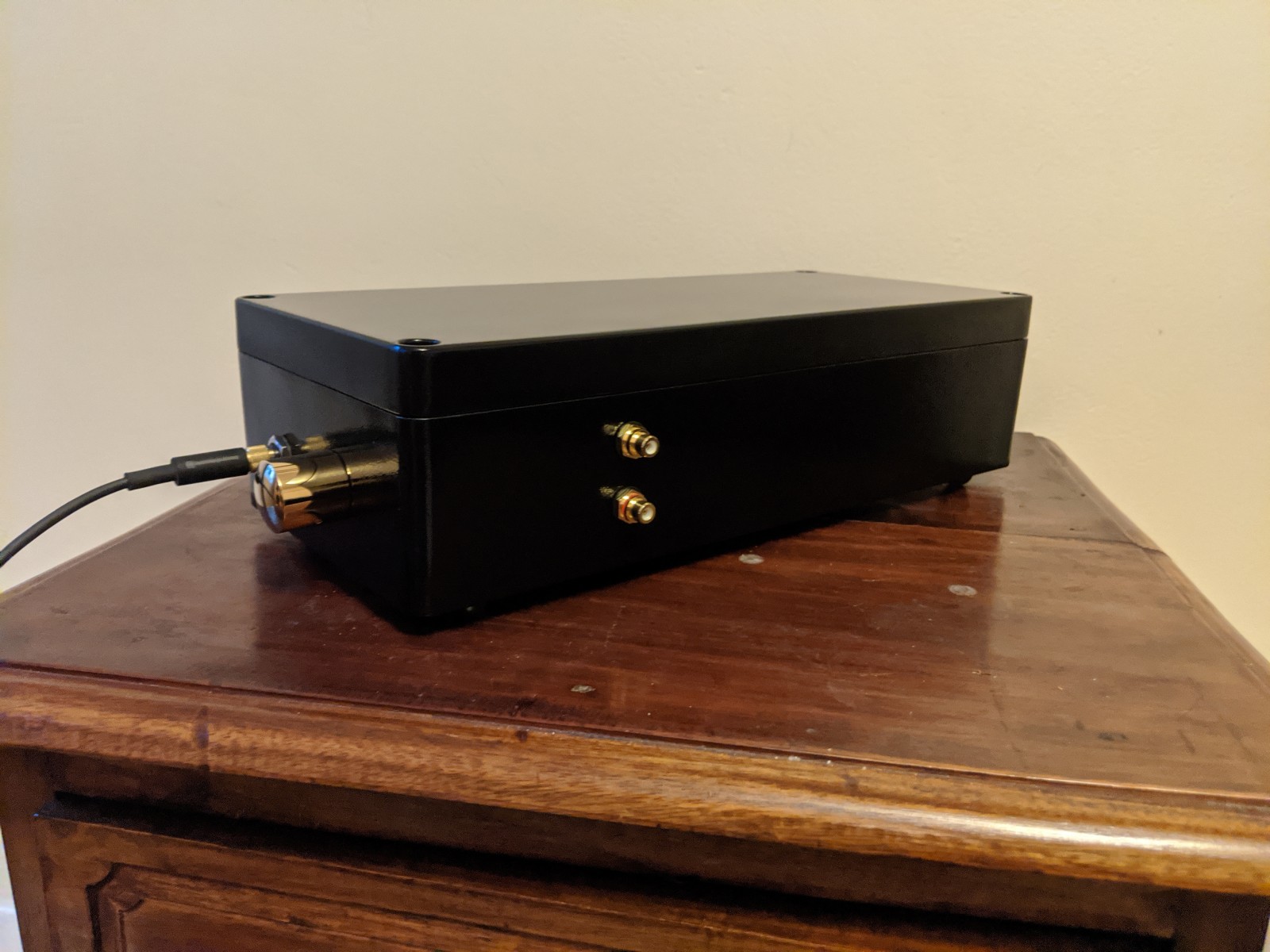

Nice finish on the case, btw. Very monolith.
Thanks Richard.
A can of black gloss is all it is. It's very moody looking though in the flesh 😀
I know I'm not the best example of your advice to use a larger enclosure than you think you'ill need but I couldn't resist this box. It will be a tight fit, adjustments will need to be done prior to fitting the boards and then there's the divider/shielding between power and audio sections to devise. I'm hoping the strays from using a larger transformer doesn't complicate matters any. Anyway we'll see... It all comes down to how accurately I've measured... but I have no doubt I will have a few moments for sure.

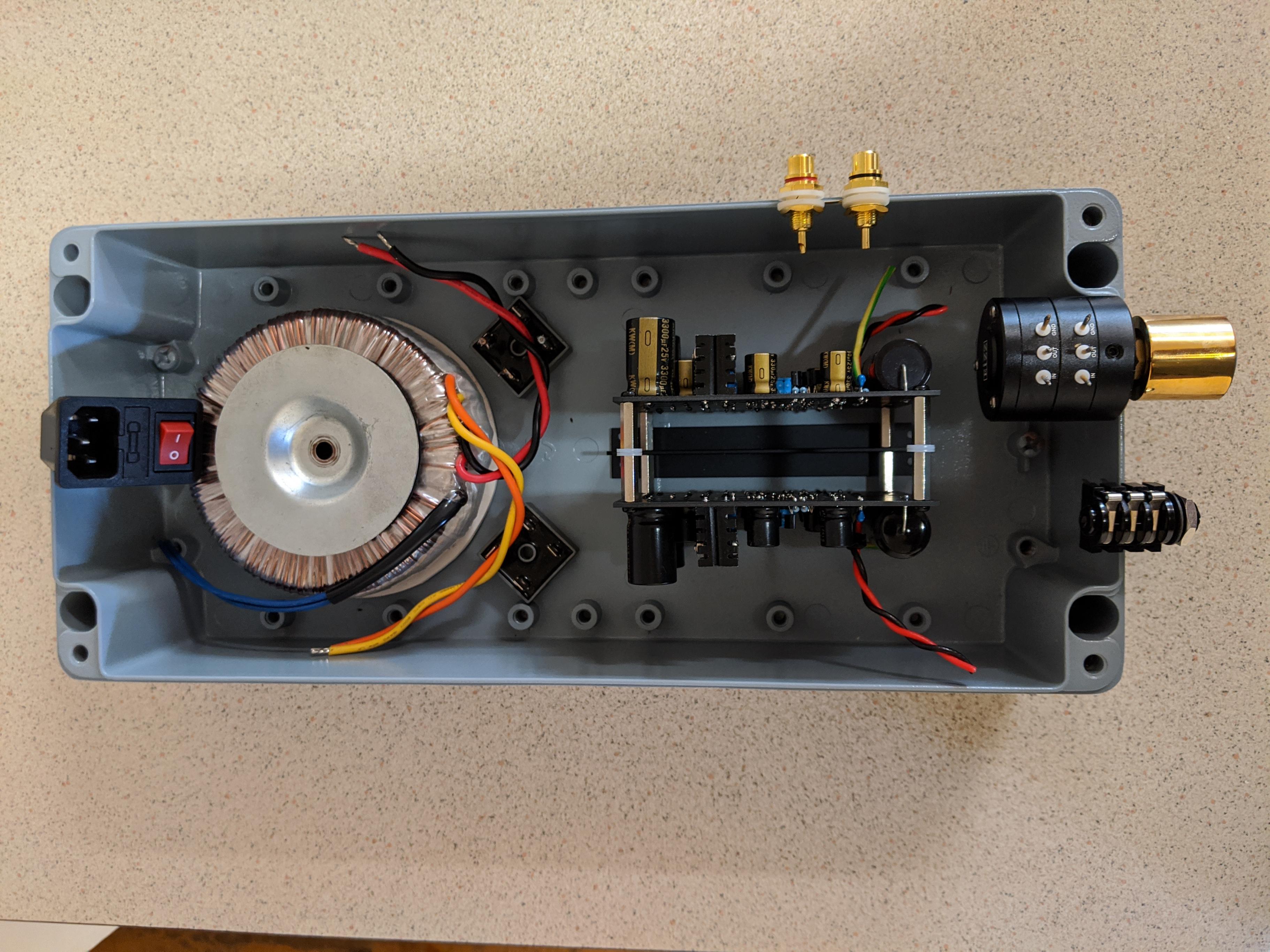

It looks fairly spacious, especially since you can stand the boards vertically.

The internal height of the enclosure is 83mm but I'm more concerned about the length. At 353mm (internal length), each of the components are still spaced close. For example I lose 9mm from that length for a separator panel (steel) but I actually lose closer to 22mm allowing for clearance either side of the divider. And so it goes.
In the end I'll just have to make it fit.

For my next build I was thinking of going with the stacked board approach as well and use a slim case.
The issue here is that the inputs from the rear pass right by the toroidal transformer....
How about housing the transformer alone in a separate small box and transferring AC via umbilical cord to the main chassis? The main chassis will house the rectifiers.
I'd put the rectifiers as the box with the transformer. Route V++, V--, and COM through the umbilical as per the standard Phonoclone/Emerald builds.
