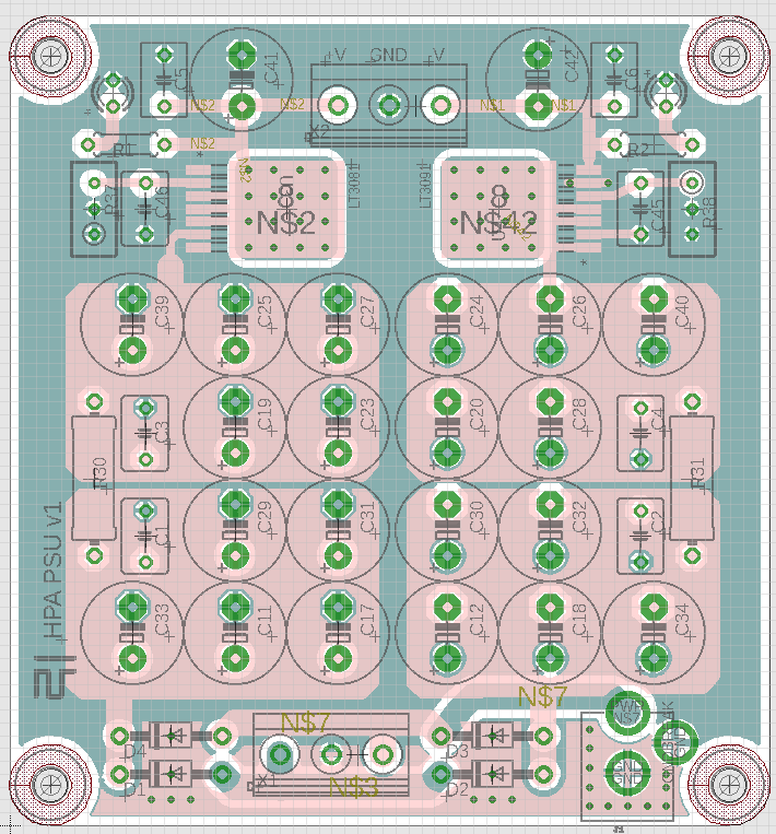

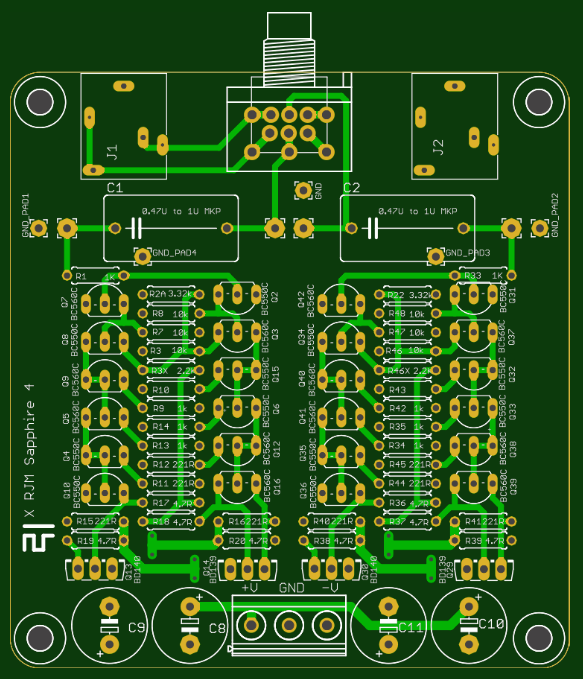

Mini Sapphire4 Board
@RJM,
I have designed small stereo board based on Sapphire 4 including small pot.
Board size is 75mm * 80mm to fit to Hammond Case, It will be used with LT3081/ LT3091 PSU that I built with previous diamond buffer project.
I would like to share gerber after building it if you don't mind.

@withmatt
Sure, go ahead. That layout looks like a pretty interesting take on the circuit.
My only request is that you post the gerbers to this thread, in addition to whatever else you have planned. Ideally the .brd files too.
One comment: Both our layouts relay on a wide area, shared ground plane for all the current returns. I never had any problem with ground loops or instability, but maybe I just got lucky. I would definitely recommend building and measuring a prototype first before finalizing the production layout.

Yes, I will share it to here also.
The power board has one wide ground plane, but amplifier board does not have big ground plane. I built two different ground plane for same circuit for previous project, star ground was better than one big ground plane.
Thanks. In principle a continuous ground plane is best, but in practice I have found that connecting the signal returns first before a shared connection to a power ground plane works better. This was based on tests with the Phonoclone, which is much more sensitive than the Sapphire due to the higher gain and smaller signal voltages however.

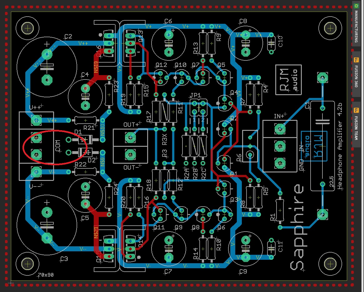

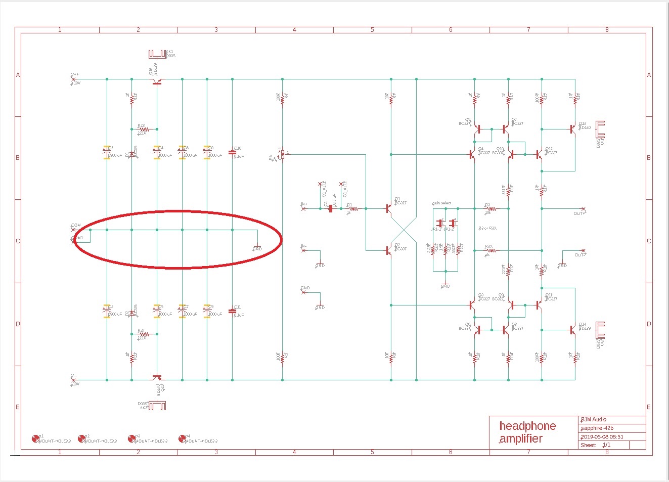

Hi
Maybe a silly question but i want to build ver.4,
i check schema and board in eagle. On schema tehere is nice ground path conencting gnd, zeneres, caps and etc.
But on board there is no connection. Is it right or something wrong is with my eagle ??
On print screens i shows what i worry about.

When you load the .brd file into Eagle the polygon fills are only indicated by a dotted outline. Click the "ratsnest" button to fill the polygons and properly display the Sapphire's ground plane.
Ok i do it, now it seems ok. But i just already ordered pcb from jlc, hope that gerbers will be fine ( i genereated these file wihtout cliking rastnest button).

The polygons are present whether they are visible or not, it does not effect the Gerber data.
