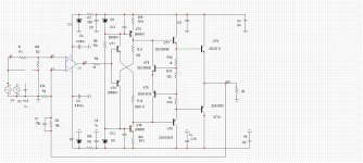

I made a powerful buffer
Congratulations on your "powerful buffer" design/simulation.
Not sure what your buffer has in common with RJM's Sapphire amplifier, though.
There is no shortage of people like yourself who have posted schematic/simulations of various types of amplifiers on this site, but few seem to have the layout skills needed to make a PCB for all their "new" design.
I'm not saying you're one of those that falls into that category since I don't know you.
When you can layout a PCB and post the Gerber files on this site for this "powerful buffer", then I may consider having a few boards made and trying your design.

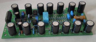

The project is completed.There are a few instances .Can be translated into a more suitable branch.sorry for the clumsy translation.
I can offer board files in Sprint-Layout50
That would be nice. I use Sprint-Layout 6.0 for all my layouts.🙂
The archive files in the sprint, MC-9, photo boards and PCB. As well as a schematic diagram
Thank you.

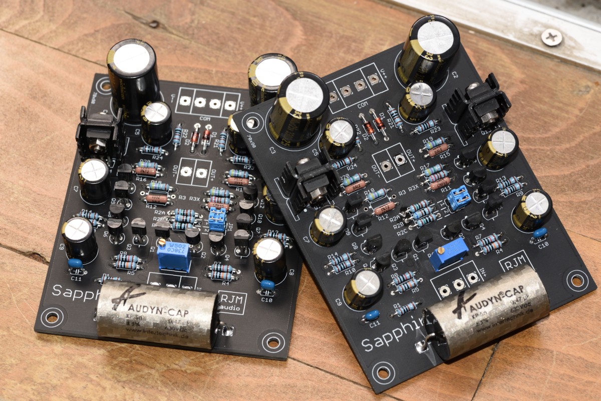

Sapphire 4.6g
Over the holidays I built a set of the new 4.6g boards, just to check clearances and so forth, as well as have some photos for the webpage and instructions.
R3X (closed loop config) 8-15-25 dB gain settings. Audyn Sn KP 0.47 uF coupling caps.
The completed boards are available, pls. inquire if interested.

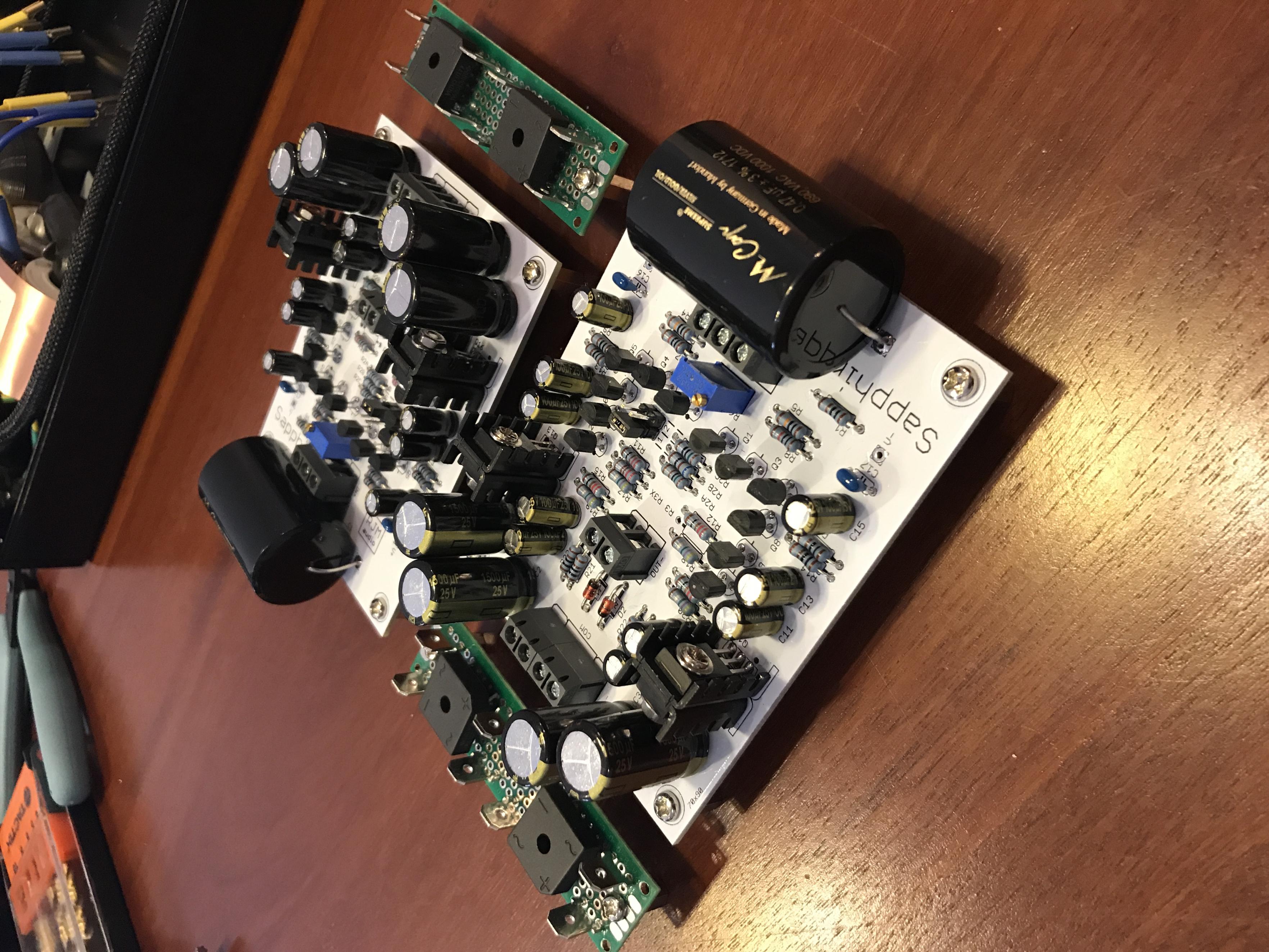

Nearly ready to finish this bad boy!! Got some drilling to do and wire up the HP jack (temporary one for now but will fit Neutrik NJ3FP6 eventually)
1500uf and 100uf Panasonic FM
Mundorf Supreme Silver/Gold/Oil
Elma A47 25k series attenuator
Case same as RJM
4.1t Boards fabbed by PCBWay - I thought white would be fun but regret it now - too many different colours happening! should have gone black as per RJM boards or green to match little rectifier boards. At least internal aesthetics will be moot once the lid goes on!!
I have enough BOM for a second set of boards which I'll do with NOS Elna Starget 1000uf (they're a bit big but I think I can make them work) and a Russian PIO for C1 duties.
I'll see you next week with final pics and help on the bias if needed. Looking forward to hearing this compared to my O2 and SSMH. Listening through Sennheiser/Massdrop HD6XX.
Cheers! RJM thanks for supporting this community.

Kewl. I think white+white works.
More importantly one thing I should really address is the way C1 blocks the input screw terminal strip. For the moment I recommend soldering the wires in directly.
Honestly for that case you are using I'd go with a shared power transformer and diodes. Dual mono gets too crowded, I regret going that route on my build. Think about it anyway, if you haven't already drilled the holes.
Yeah - it's tight/fiddly. At the moment I have the input terminals facing towards the variable resistor so I can get at them. However, once I am settled on which open/closed loop options; different C1 caps etc. I plan to remove the terminal strips across the board and directly solder inputs/outputs/rectifier. The Molex connectors will stay only until I'm done playing.
I've looked at yours plenty and I think the C-core trafos are generally smaller than your nice medical grade toroids so I think I will have more free space than you do. (I'd need to buy a more powerful trafo if I dropped dual mono). I stagger the alignment of the trafos and boards rather than align them through the centre, which means there is about 1 inch clearance passed the trafos for the input and the same on the other side where the AC goes up to the front switch. I'm using mini coax for the inputs so that should provide shielding if the physical separation is not great enough.
Hope to have time Sunday to finish up!!
No, really not. That single R-core shown in the photo is more than large enough. I assume it's 50 VA, but even 25 VA would be OK.
