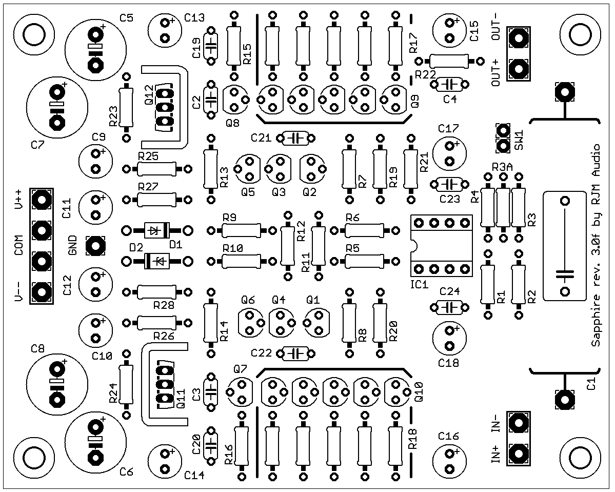

I've sold out of the first batch of Sapphire 3.0 boards (they proved relatively popular...) and will soon re-order.
I have the option of doing a re-spin [aka a new tooling of the layout], but there weren't any issues with version "f" except that C9,10 ended up unused. So unless there are things anyone else encountered I'll probably just go with a straight re-order using the previous tools.
Anything you want changed?

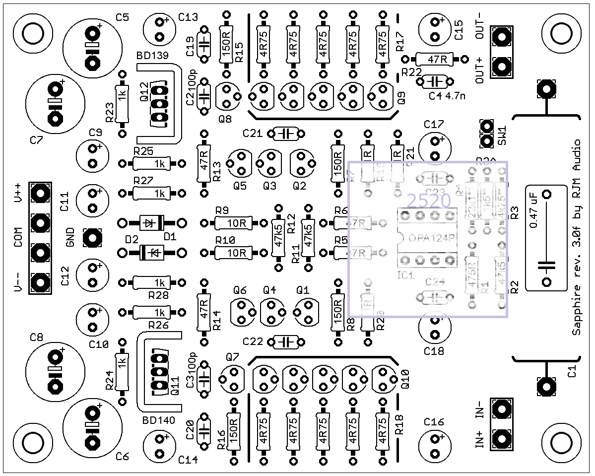

Personally, I'd like an API-2520 foot print aka - DOA foot print around the opamp with the option of raising the default voltage to +-15V so I could use my DIY JE-918, JE-990 and SG-SOA-2 discrete opamps (though most will work at +-12V). See Sam Groner’s web page or MNAT's web page for the opamps.

15 V operation doesn't require modification to the boards, you'd just change the Zener to 15 V, use a transformer with 2x15 V secondaries, and change the capacitors to ones with 35 V rating. (The value would be reduced slightly, but this is no problem.)
2520 footprint, as I understand it, is a square 1.1" (28mm) board. I sketched a rough outline below. Is there a standard pinout or package dimension you could point me to? Does it plug into an 8 pin DIP socket? C17,18,23,24 are not mission critical so if the module could be mounted above the resistors (or move the resistors or the module to the underside of the board) something could probably be done.
Best to refer to John Hardy's 990 pdf as there's an outline of the bottom with the pins labeled.. There are 6-pins, Input +/- on one side and Output, V+, Gnd, V- on the other side. The pins are on 0.1" centers. The jacks are 0.40" pins. The original footprint had one more pin - feedback, but it's not used in any of the current designs that I've seen, nor in any of the available kits.

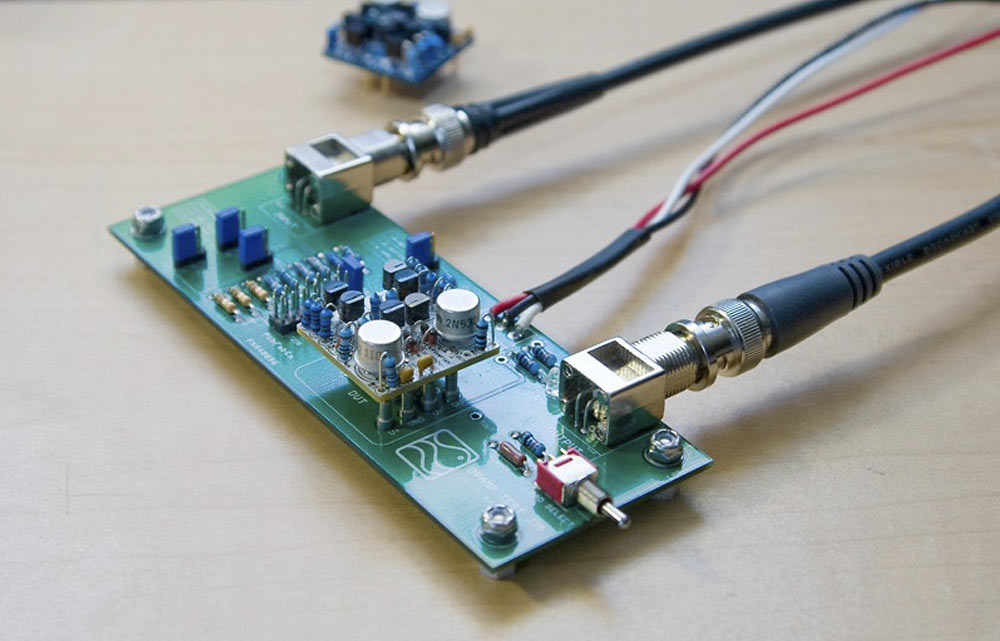

Here's a link to a discrete opamp test jig that shows the DOA-to-DIP relationship and pinouts -

So I'd do something like the Five Fish Audio test jig (photo below, courtesy of the web page). The op amp sits on sockets above the board, so in principle resistors could be mounted underneath (there is about 5 mm clearance). So all I'd need to do is add the 5 pads and perhaps rethink the capacitor positions.

There are a few that run the resistors under the opamp. If the height is the same as the opamp socket, it won't hit the bottom of the DOA. However, the DIY 990 has the SSM2212 mounted on the bottom just inside of the +- input pins.

On the capacitors - C23 and C24 are always on the DOA, thus would be a no-stuff as would the DIP socket. Even on the adapters, they would be present as would the de-comp capacitor for a NE5534.
