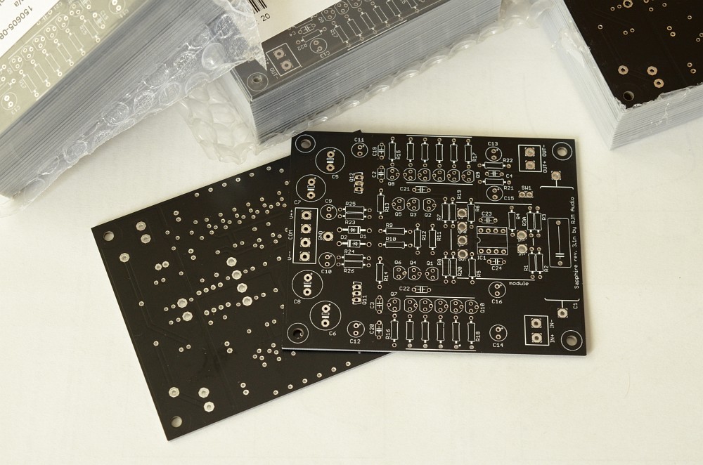

Hello,
where it says "download eagle files" on the Sapphire page, are they ready to be sent to a pcb manufacturer?
Size of the pcb?
Thank`s
Size of the pcb?
Thank`s
They are 8x10 cm. Some places will accept the Eagle .brd file, for others you will need to convert the .brd file into standard Gerber format.

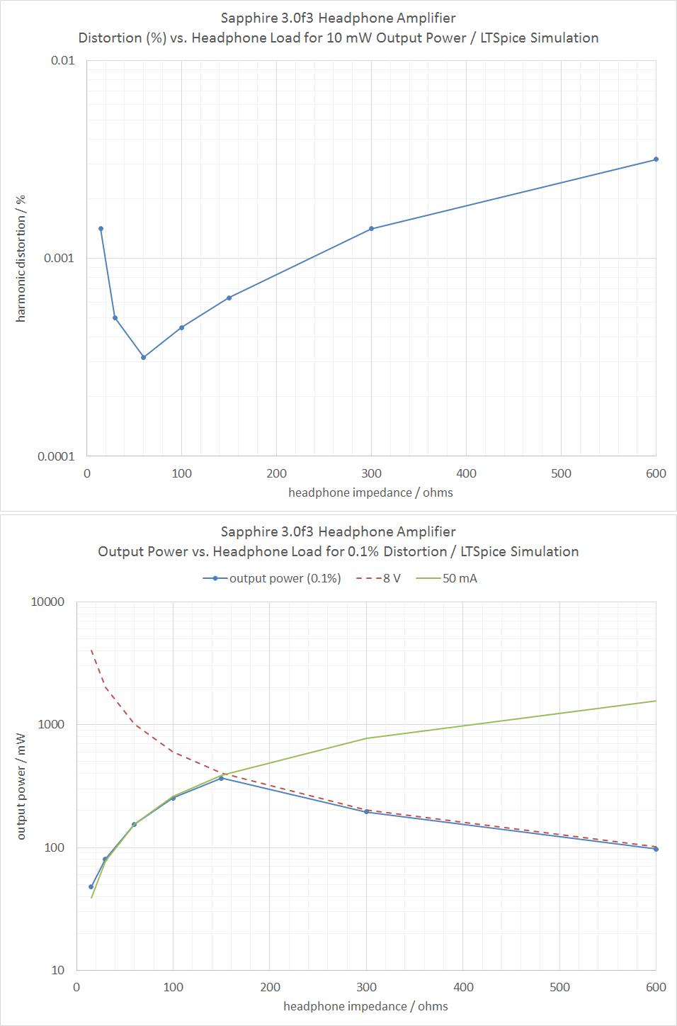

2. Performance characteristics at Rload = 600Ohm.
Basically all graphs are provided for the loads up to 300Ohm. It would be great if you could provide similar ones for 600Ohm load.

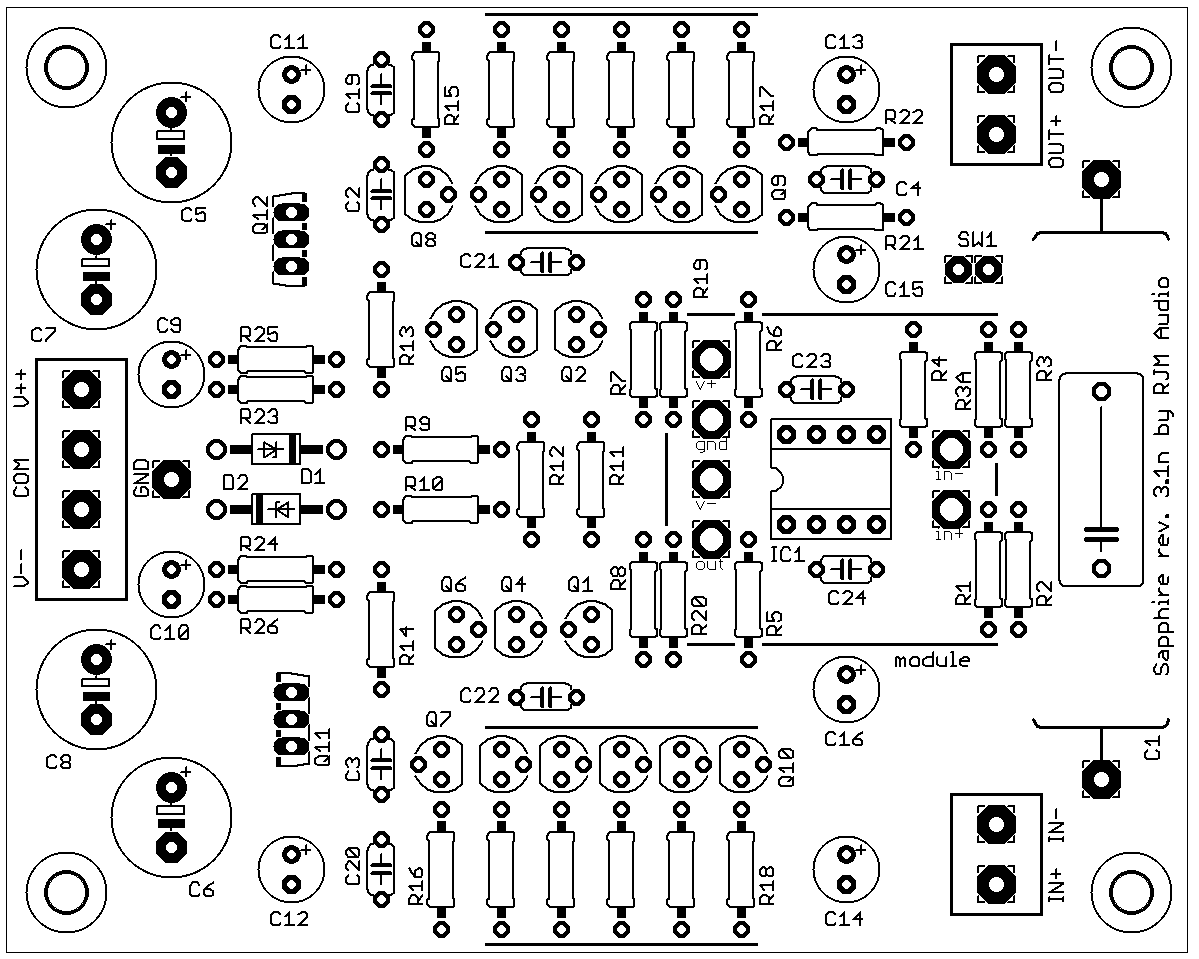

3. Removing C1 from signal path.
There is no DC offset at DAC output, so I presume I don't need the one. Shortening C1 pads would suffice? If no log volume control is used, input impedance of the amp as seen by DAC is around 47kOhm, isn't it?

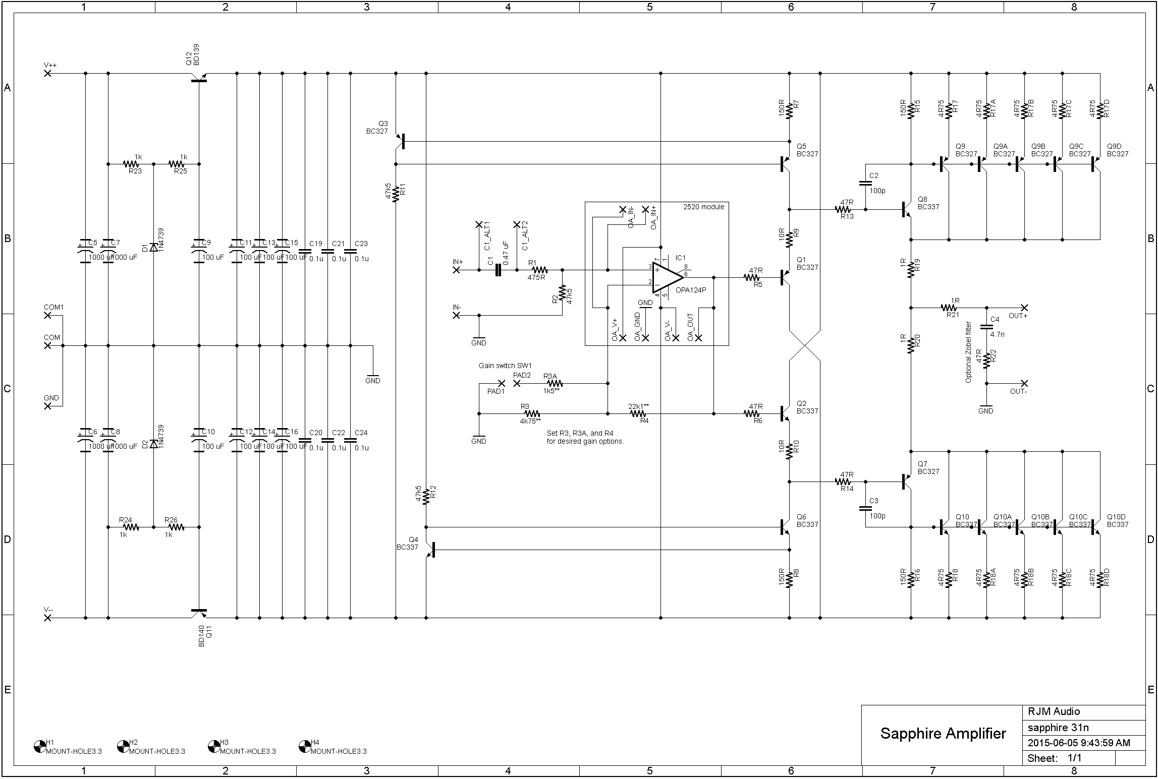

I'm happy to give advice, but many of your "questions" above sound to me more like statements of your own opinion and are therefore going to be difficult to answer without seeming combative. With that in mind, then...
1.
No you aren't. You want the right voltage gain to be able to comfortably listen to music with your headphones with the volume control around 9-11 o'clock. 600 ohms, 94 dB/mW are going to need about 30 dB of gain. For low impedance over-ear headphones, 10-15 dB is fine.
As you note, there are many different possible combinations of resistors you could use, but the idea is to keep the impedance of the feedback network (R3||R4 or R3A||R4) not too far away from 1k so as to balance the network on the noninverting input, and certainly not above 5k as that will add start to add noise into the circuit. There is a certain amount of compromise involved.
A suitable set of values for R3, R3A, and R4 is 3k3, 330 ohms, and 10 kohms, respectively.
2. Sure. See attached.
3. Don't short over C1. Removing the AC coupling will mean the output offset voltage will vary with the volume position. If you spin the volume fast enough you'll be able to hear it...
4. A circuit "ground" should make a connection to the chassis once and only once. So if you have a DAC and a headphone amp sharing the box, its up to you where you want to make this connection. You have to make it though. Whether you want to connect the chassis to earth or not is up to you, but its generally a good idea. If the power supply is shared, its best to make the connection to chassis to the power supply common before the split to each channel. For dual mono both channels of course are tied to the chassis, and you have more freedom about where you want to make the connection.
5. If you think it's overkill, use a smaller one.
6. If you want to use external Vregs, use external Vregs. If you want to bridge over and disable the Zreg section, go ahead. It's not my job to convince you that the Zreg is better than whatever circuit you want to use. You are welcome to discover that for yourself. I will however suggest that there is little point putting a regulator before the Zreg. If you are going to try a different circuit, it's best to cut the Zreg out and replace it with your latest and greatest.
The Z-reg is not the best performing regulator out there, but it does its job and it does its job without feedback and without any of the problems this introduces. With no sampling, and no error amplifier, it is utterly "unfussy" about the load it is attached to. I think that's the reason it sounds as good as it does.
/R
Either I've misunderstood schematics or I was misunderstood. If C1 pads are not wired together, there is no closed circuit between IN+ and IN-.

"Either I've misunderstood schematics or I was misunderstood. If C1 pads are not wired together, there is no closed circuit between IN+ and IN-. "
I mean, you should use the capacitor C1. Do not remove the coupling capacitor from the circuit.

115 dB output from 95 dB/mW headphones is 100 mW power, and for 600 ohms equal to 8 V rms. So if you want this to be obtainable at 100% volume setting from 1.4 V source the gain is 8/1.4= 15 dB.
That is something similar to what I've calculated. Good news.
Why not? The output of the DAC is DC coupled.

If you remove the coupling cap, you make a DC connection from the op amp input to the upstream circuit. The output offset voltage depends on the DC resistance seen by the op amp inputs, and - since you will not use a volume control - now this will be variable and depend on the the input impedance of the source since there is no blocking capacitor. In practice this will mean large "pops" and "thunk" sound when you plug in or unplug sources, for example.
Re grounding: yes, in certain cases where there is a problem with the grounding the circuit will be quieter when isolated from the chassis or the chassis is isolated from earth. That is the exception, however. Lifting the ground is done as a quick-n-dirty fix or when all other options are exhausted.
There is only one source. R-2R ladder with low-pass filter at the end (Zout = 625 Ohm).
