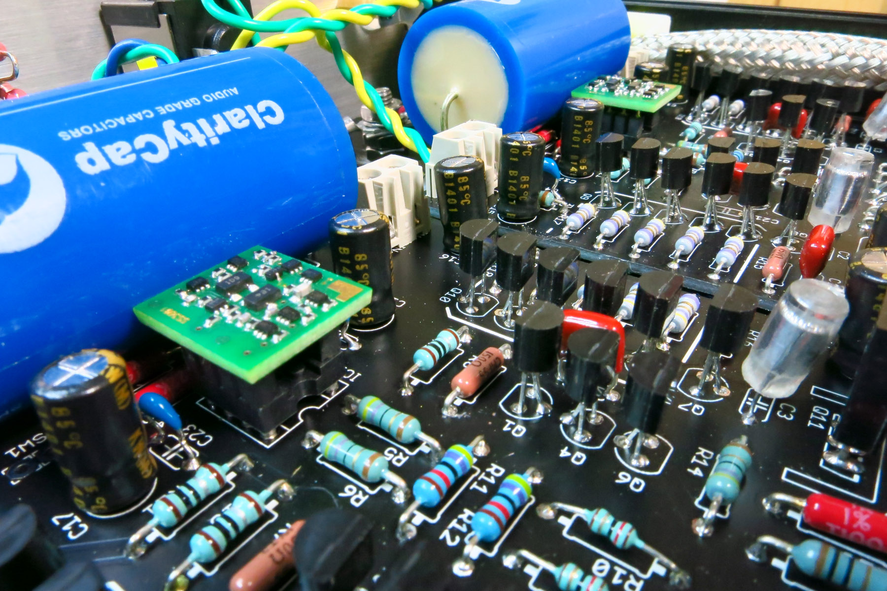

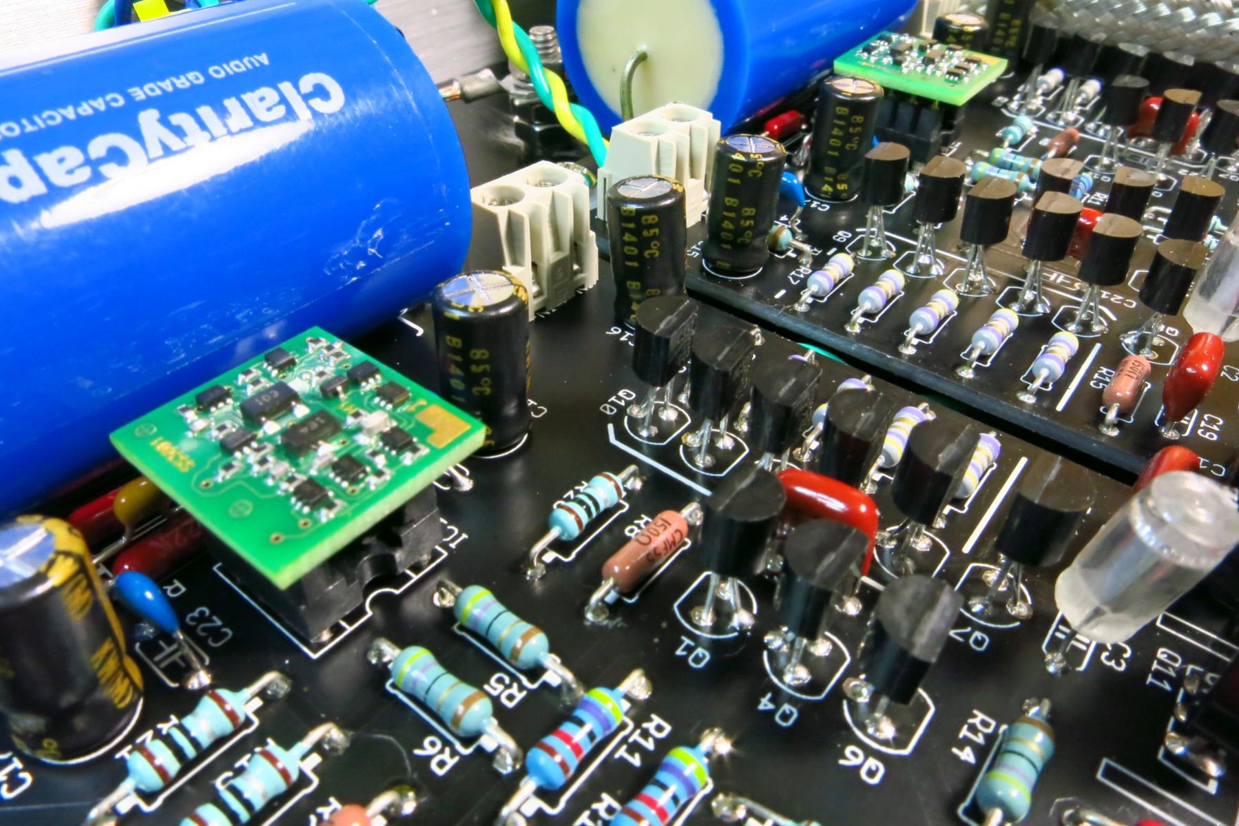

I popped in Sparko Labs' SS3601 discrete op amps in place of the OPA134's. Theoretically a drop-in replacement, or so I thought. Disappointed! They are so far unlistenable. Output is down, and turning up the gain I'm getting noise over the music signal. Haven't done anything more than scratch my head and make sure the OPA134's work again in the circuits - and they do, perfectly.
I'm wondering if these little boards need to be shielded.
The specification open loop gain of the SS3601 is 140dB to 600 Hz. According to the OPA134 data sheet, the 134 gain spec is 120dB. On completion of the boards, my test voltages were very close to expected values according to the build sheet. I probably have at least a couple hundred hours or more on the boards with the kit op amps.

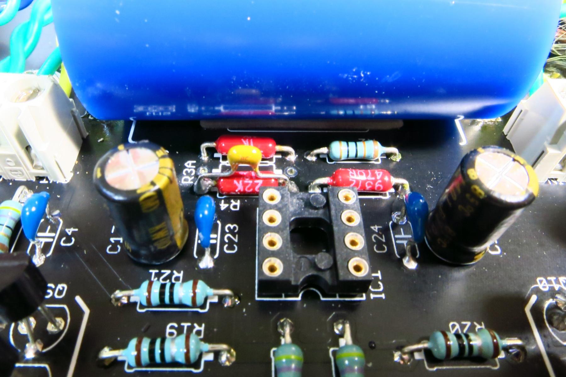

Pretty standard stuff and no reason why it wouldn't work in this application. I suggest following the advice given in the datasheet and try adding 22 pF in parallel with the Sapphire feedback resistance R4. As you note, its also worth checking the DC offset at the op amp output pin 6 (should be <100 mV) to make sure nothing really odd is going on.

The upper limit for the compensation capacitor Cf depends a little on the feedback resistance, for R4=22k is about 47 pF, R4=10k about 100 pF, R4=5k about 220 pF.
Much smaller than that and the effectiveness is compromised. Much larger and the audio frequency response suffers a treble cut.

I had already soldered in 22pF caps by the time I saw your last post, Richard. My R4 is 22K, so I should be using a higher value. I did not take any measurements before putting the new caps in. I popped in the SS3601's and powered it up and it still sounds crappy, no change. With my DMM I measured V++ to V--, each channel is just a hair under 37V. Input offset is zero, both channels, but output offset is 9.6V, both channels. Yikes, it should be a few mV. Voltage across pins 4 and 7 is 21.24V (left), 21.14V (right).
I powered it off, pulled out the discretes and put the OPA134's into the sockets. Output offsets have settled right down to 3mV left and 18mV right. Voltage across pin 4 and pin 7 is 21V each side.

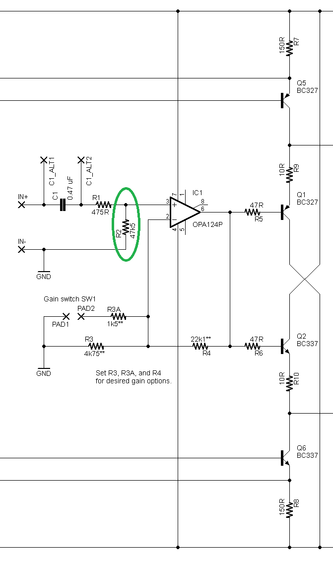

9.6 V!? Slammed right up to V+ in other words. So, yeah, OK .. now we know what why it doesn't sound good, but what caused the op amp to do that?
We are looking at DC gain of 26 dB. (20x). So for +9.6 DC output the input offset (voltage difference between inv and noninv inputs) must be at least +500 mV.

I suspect there may be an input bias current induced offset.
Looking at the schematic of the amplifier, the + input can only bias through a 47K resistor. The input bias current is around 5uA, so the input will see a DC offset of a couple hundred mV, amplified by the gain, it could be causing the offset.
You can try putting a 2.2M resistor or so from the + op amp input up to the +12V supply rail to supply the bias current. The value may need to be played with to get an acceptable offset.

I see now your module's input offset current is 4.5 uA typ. Compare that with the NE5534A's 10 nA and the problem comes into clear focus. With R2 47k or higher, anything over 50 nA is going to be a problem.
The workaround would be to add a 22uF capacitor between R3 and ground. This sets the DC gain to unity, lowering the output offset voltage back to value seen at the inputs.
That said, 4.5 uA is too high for this circuit application even then. I think it would be a good idea in addition to change the volume control to 10k, and reduce R2 to 10k to match. Only then will you get output voltages down into what I consider the "safe zone" of 50 mV or less.
4.5 uA x 10k x unity gain = 45 mV.
Take home: if your are going to use a discrete module for the Sapphire, JFET inputs will be a nice feature. Failing that, pay close attention to the input offset current and keep R2 and the volume control as low as impedance as possible.

Yep, sounds like a classic example of trying to use an op-amp whose input bias current is too high.
Unfortunately, this is usually the case with a lot of the better sounding bipolar op-amps.
In addition, the higher the gain, the higher the offset. No surprise that you're getting 9V at the amp's outputs.
Any op-amp with a input bias current specification in micro-amps probably isn't going to work very well unless you can equalize the impedances "seen" by the + and - inputs.
