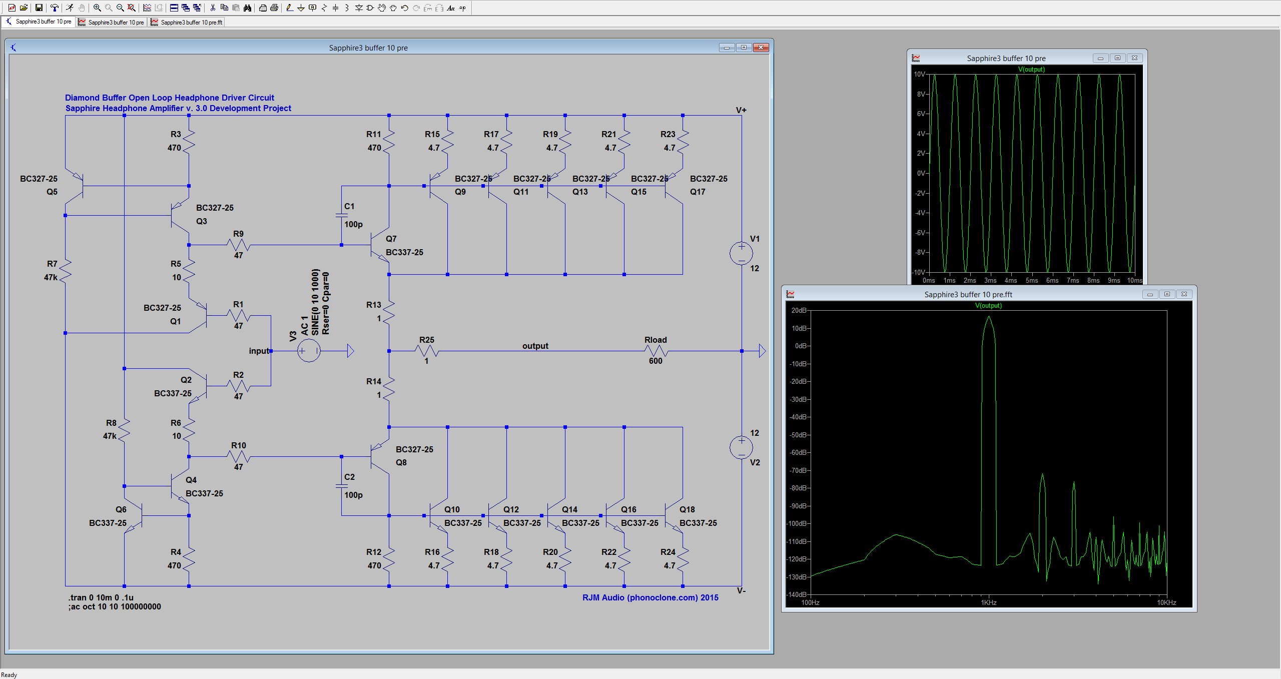

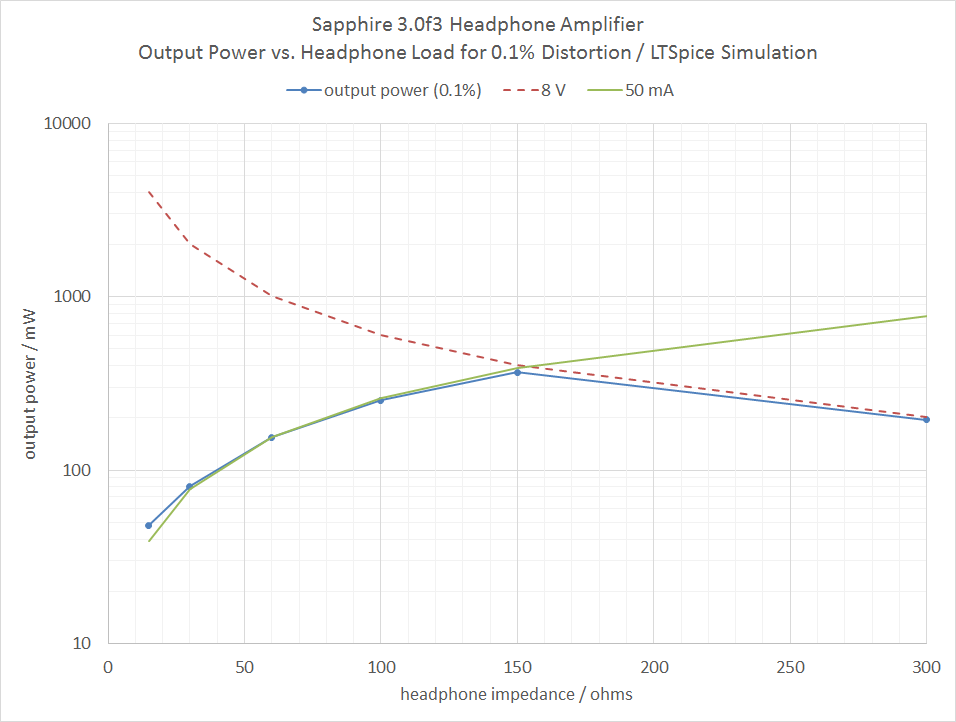

One more plot for today, this one is the traditional power output vs. load plot, with "clipping" set at a relatively strict 0.1% distortion.
Basically, the Sapphire buffer can put 50 mA rms into your headphones for any impedance 16-150 ohms. For higher loads the output is voltage limited. At 300 ohms the output can get up to 1.2 V from the voltage rails with minimal distortion.
If you are thinking "wow this would make a great preamp" .. yes, it would 😉
The preamp mod is to change R7,8,15,16 from 150 ohms to 475 ohms. It will still drive 600 ohms to +17 dB at <0.005% THD but reducing the bias currents like this means the input impedance goes up and heat/power consumption goes way down. I'd go back to using a 50k volume control and R2 100k.
Anyhow, returning to the headphone amp version, you can see from the graph that the "quotable" power output depends on headphone impedance and for 16-300 we must say "50 mW" For 60 ohms and up, however, its more like 200 mW. Totally academic, but formally the Sapphire output is therefore 50 mW.
P.S. The buffer circuit is what I'd like to call "super class A". It runs at 33 mA bias, so formally class A output current would be limited to about 20 mA rms. Because it's a push-pull output however, it actually pushes 50 mA rms before crossover distortion starts to bite. Since there's no feedback, this distortion creates a hard limit, and power output tracks the bias current just like a class A amp ... only slightly in excess of it rather than slightly under it as it would for a single-ended topology. Thus "super class A". I think Technics have already trademarked that one, though. 😀

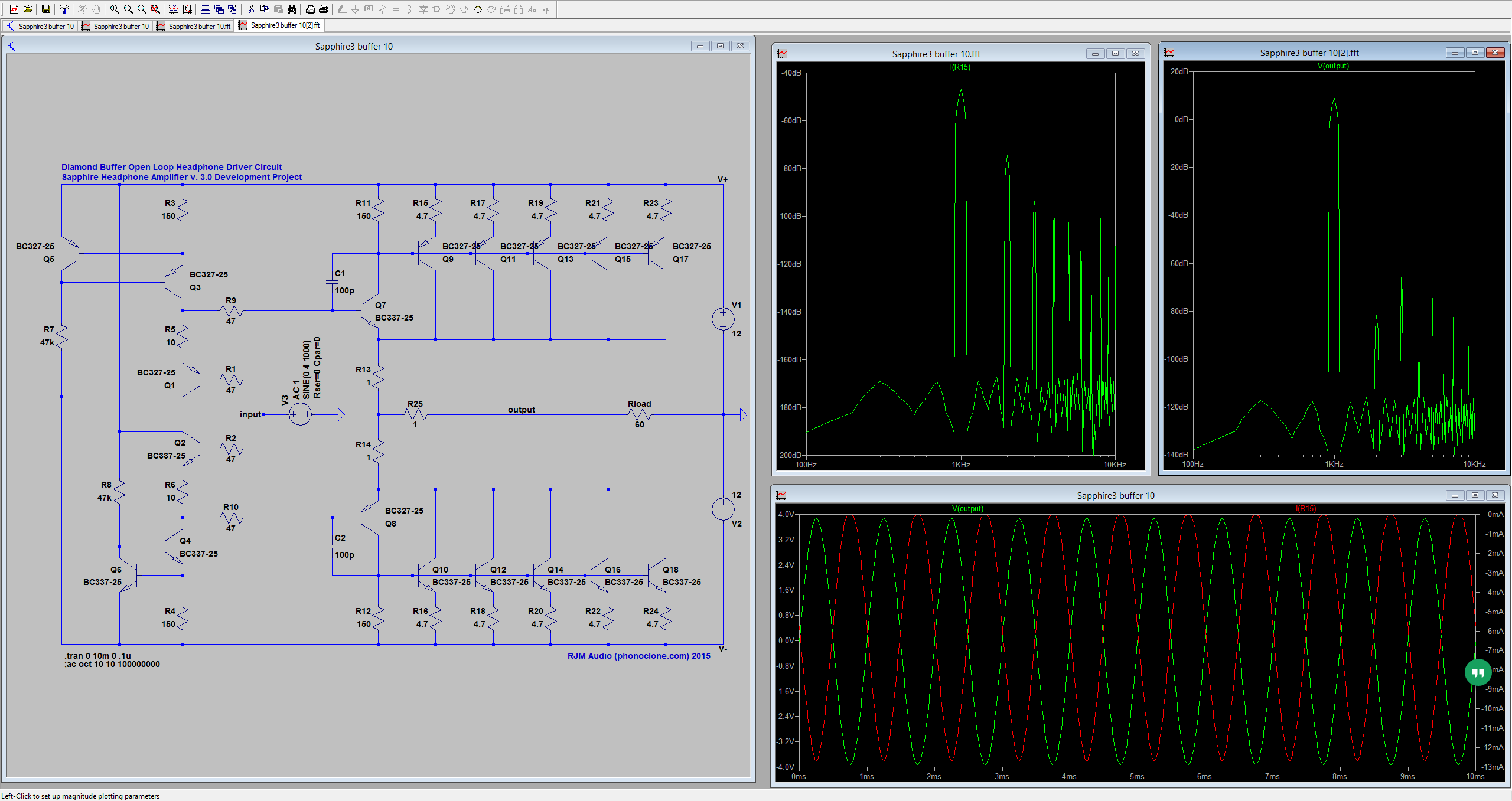

It's possible to watch what happens in LTSpice. As the output runs out of current the waveform clips, but before the output transistors run completely to zero it's more like the top of the sine wave is filed down rather than lopped off. In a single ended circuit it would be terrible 2nd harmonic distortion but push-pull they still cancel closely and the distortion stays low. Once the transistors turn "hard off" then it's a nasty mess.
Nothing unusual here, but in most SS amps the transition from class A to AB operation is just the midpoint, barely worth a mention, while for the Sapphire it signifies the end of the road. The Sapphire's working power envelope is defined by the class A power, with a 6~10 dB overhead.
The attached image shows the LTSpice circuit running 135 mW into 60 ohms. This is just at the edge where the transistors start to turn off completely but the current waveform is tangential to zero rather than hard up against it. The output shows about 0.02% harmonic distortion (3rd), while the current waveform in one half of the output stage (R15 in the circuit below) has 3% 2nd and 0.6% 3rd.
Classic, textbook stuff: push pull gives you lower distortion but proportionately more 3rd harmonic. This is why I love LTSpice: it makes it all real somehow.
