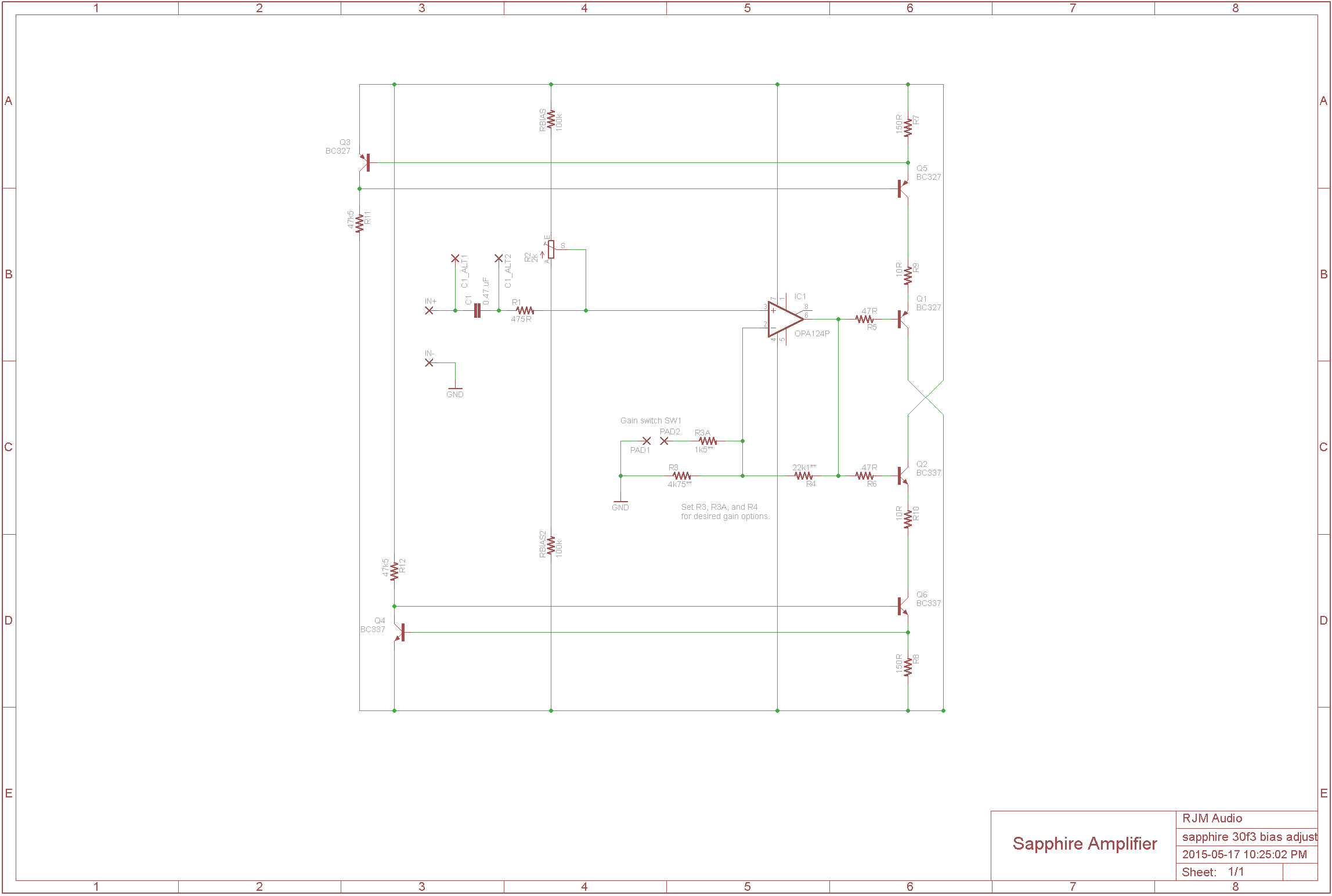

Thinking about it further, this trim pot only adjusts the offset DC voltage, not the bias current. The latter is a bit difficult to fine tune. You'd have to add a tiny trimmer to R9 or R10. The root problem - the fact that transistors in the circuit are miss-matched - is best addressed by reducing the transistor parameter spread, i.e. binning, sovling the output offset and channel balance in one definitive swoop.

1) Can I use a small sliding switch on the bottom of the case to switch from hi to low gain?
kffern
Richard,
I've been thinking about this idea and wondering if installing a panel mounted gain switch would be a doable useful idea. I'm currently populating the boards and have not yet installed any of components involved - r3, r3a, r4, sw1 jumper; and I'd prefer to plan ahead now rather to have to de-solder later.
I assume it would be.necessary to join the sw1 on both boards to a common switch. The current pin header and jumper might be adaptable, but there are probably more suitable components - probably some kind of plug(s) that would permit the panel switch to detach from the boards. And, I suspect there are some electronic considerations as well.
I'd appreciate your thoughts.
Warren
The two pads "SW1" were intended to be for not just the jumper (included in the kit / BOM Mouser 517-647-01-02, 649-71363-202LF) but also for soldering wire leads to a DPST or DPDT panel switch or DIP unit.
Come to think of it I'm pretty sure there are press on connectors for the pin strip header, so you could use that to make the switch unpluggable from the board.
The gain switch is designed to have minimal impact on the circuit operation ... though it would be good practice to keep the lead wires reasonably short and twisted together.
