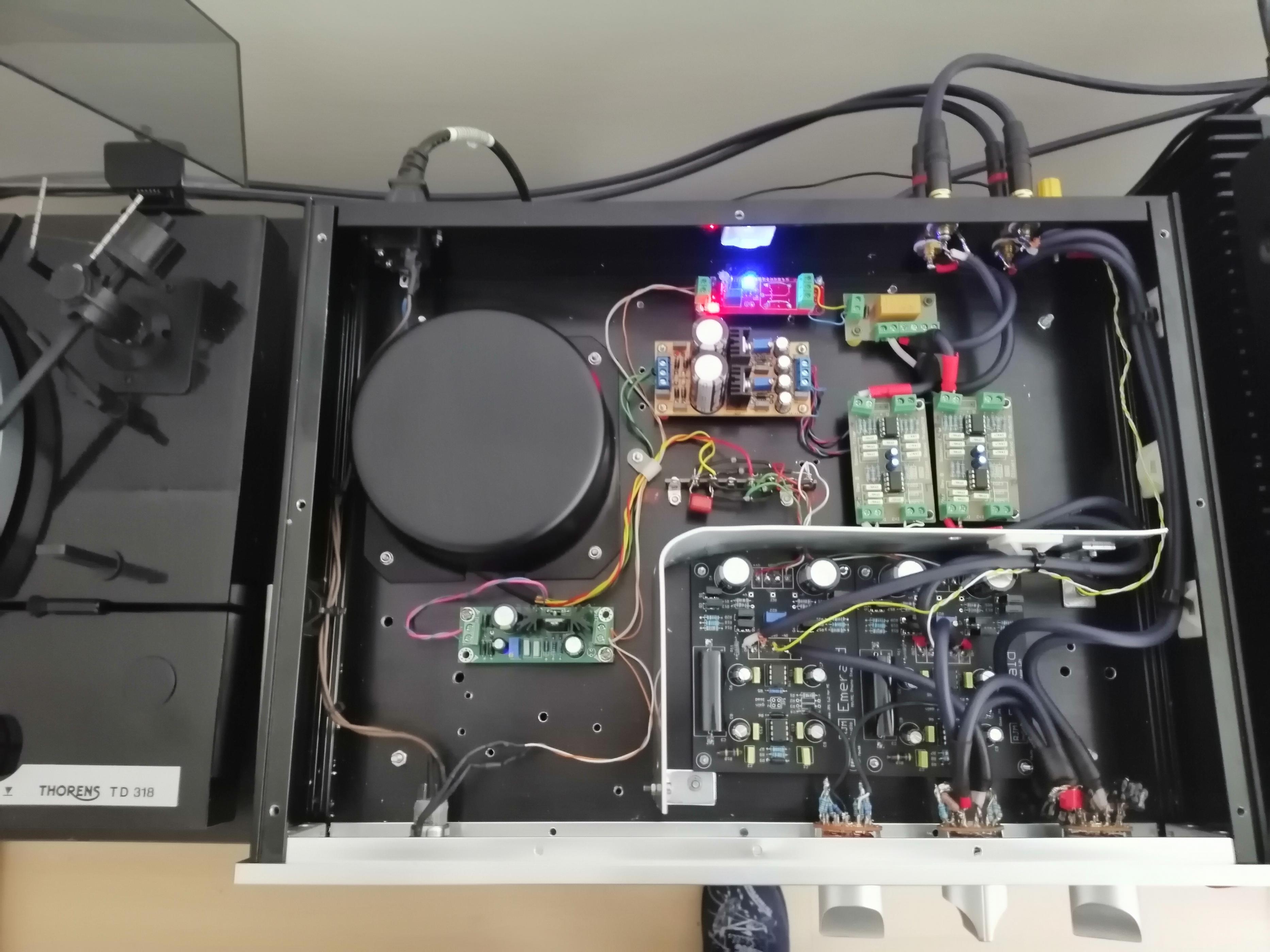

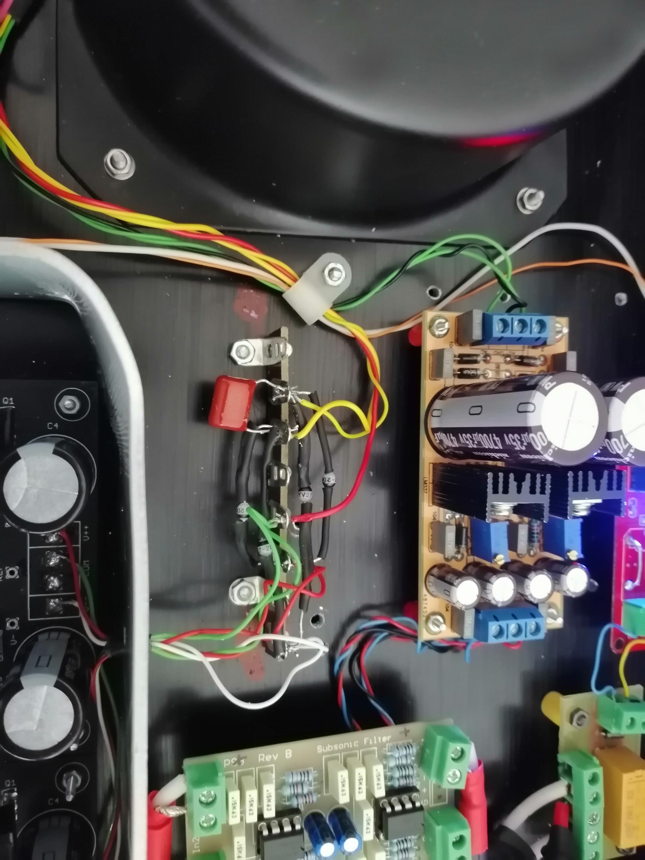

Hi all,
a while back I built my emerald preamp with great success, but I have noticed excessive woofer movement to my loudspeakers due to wrapped records or tonearm - cartridge matching, even though according to my tonearm's mass and cartridge compliance I should be at the 9-11 Hz range..
Anyways, I built two sub sonic filter circuits (one for each channel) which require +/- 15 V DC which I am getting from a regulated power supply connected to the bridge rectifiers that supply the emerald pcbs (see diagram).
Thick red lines represent V+, thick blue lines show V- and thick orange lines are the common 0V. Thick black lines are shielded cables for the signal, and green lines are the ground wires that attach to the chassis where the tonearm's ground wire connects to the chassis.
The problem is that I am now getting nasty hum which is caused most likely by some ground loop.
Any thoughts on what did I do wrong?

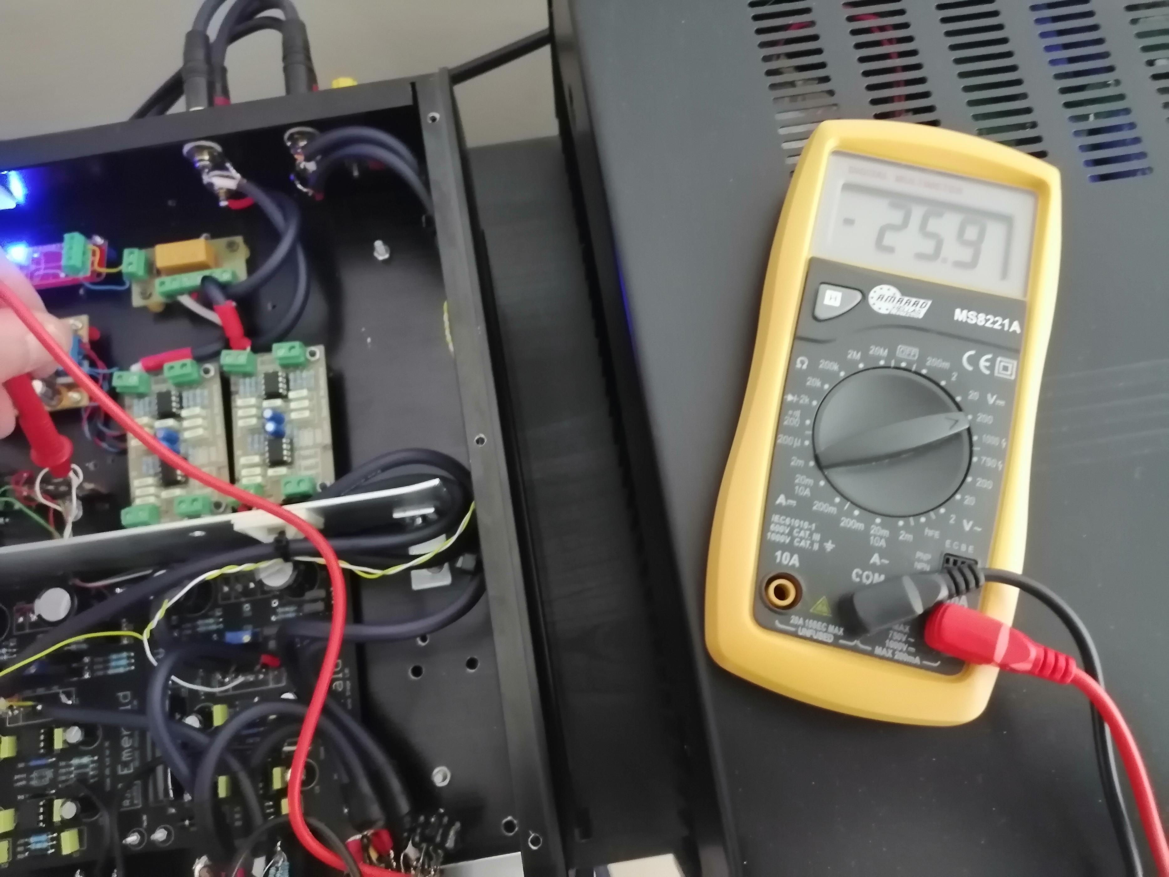

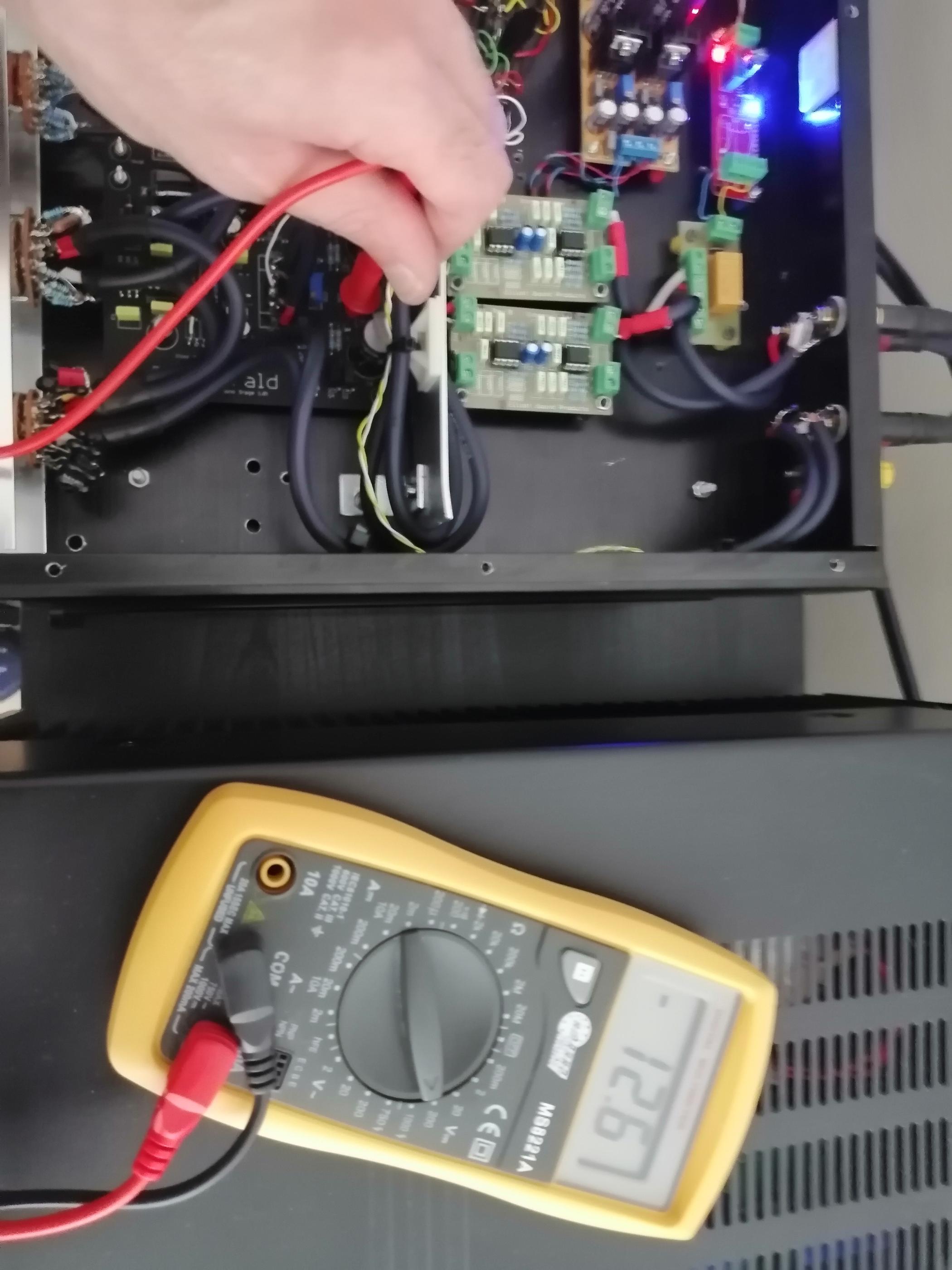

Success!! The S-reg is solid as a rock providing +/-12.5V from a +/-26V DC source.
Q3 and Q4 are barely warm to the touch after I played a whole lp, so no heatsinks needed for the time being at least.
No excessive woofer cone movement or hum any more with the use of separate transformer secondary windings.
I looked at the S-Reg design and it holds up nicely to higher voltage. That is, it is a pretty good regulation circuit. The problem is that as you increase the voltage Q3 and Q4 will dissipate more power, and there isn't anything you can do to change that really. So just use 35V caps for C4,5 and maybe put a small heatsink on Q3 Q4 and you should be good to go.[/QUOTE]

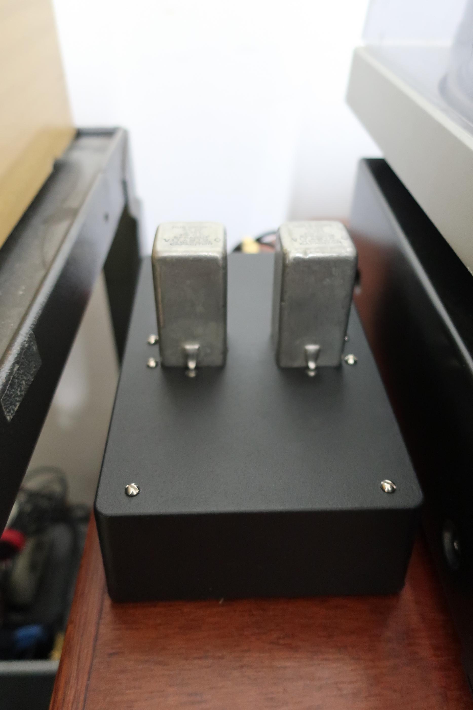

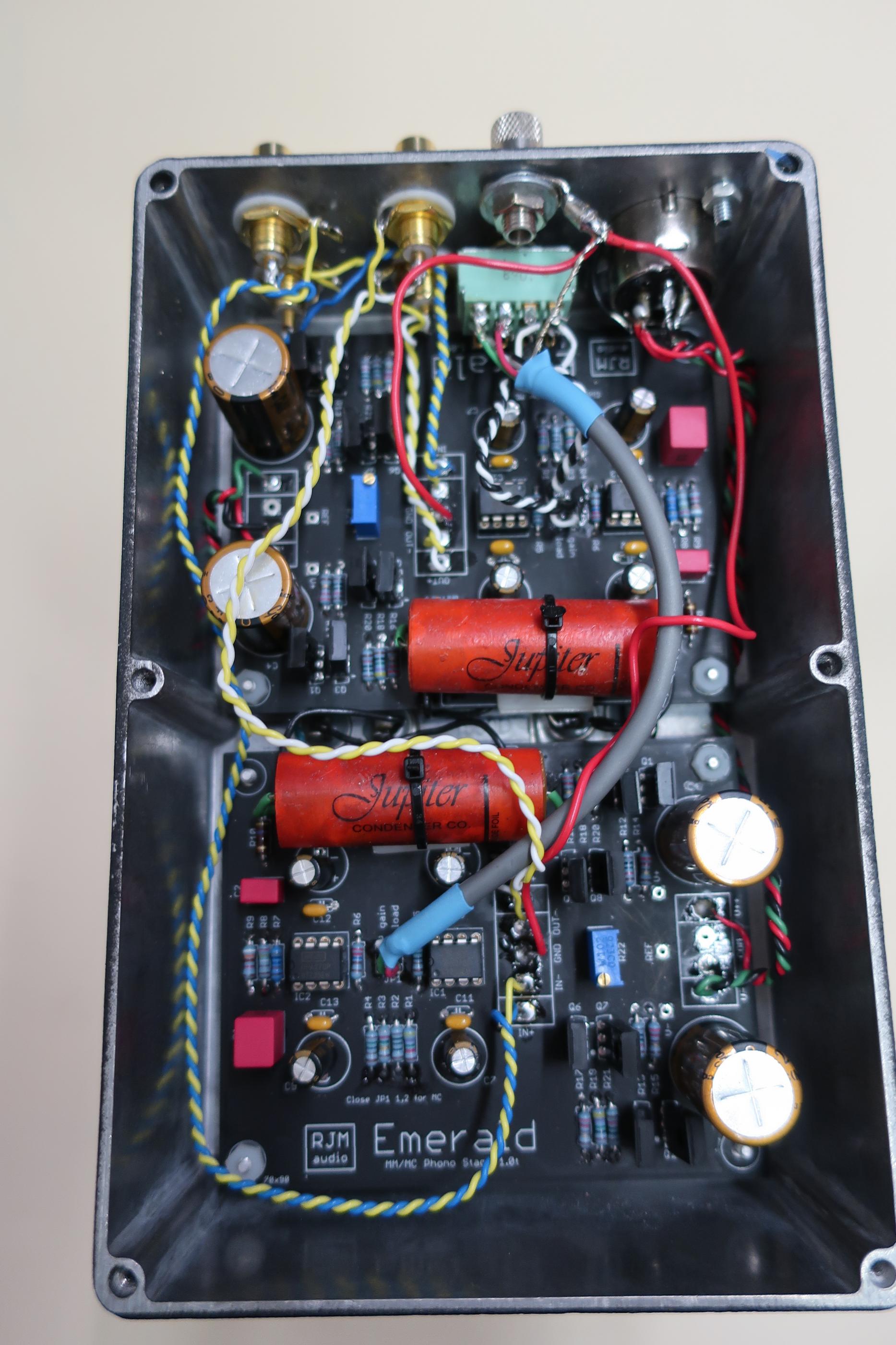

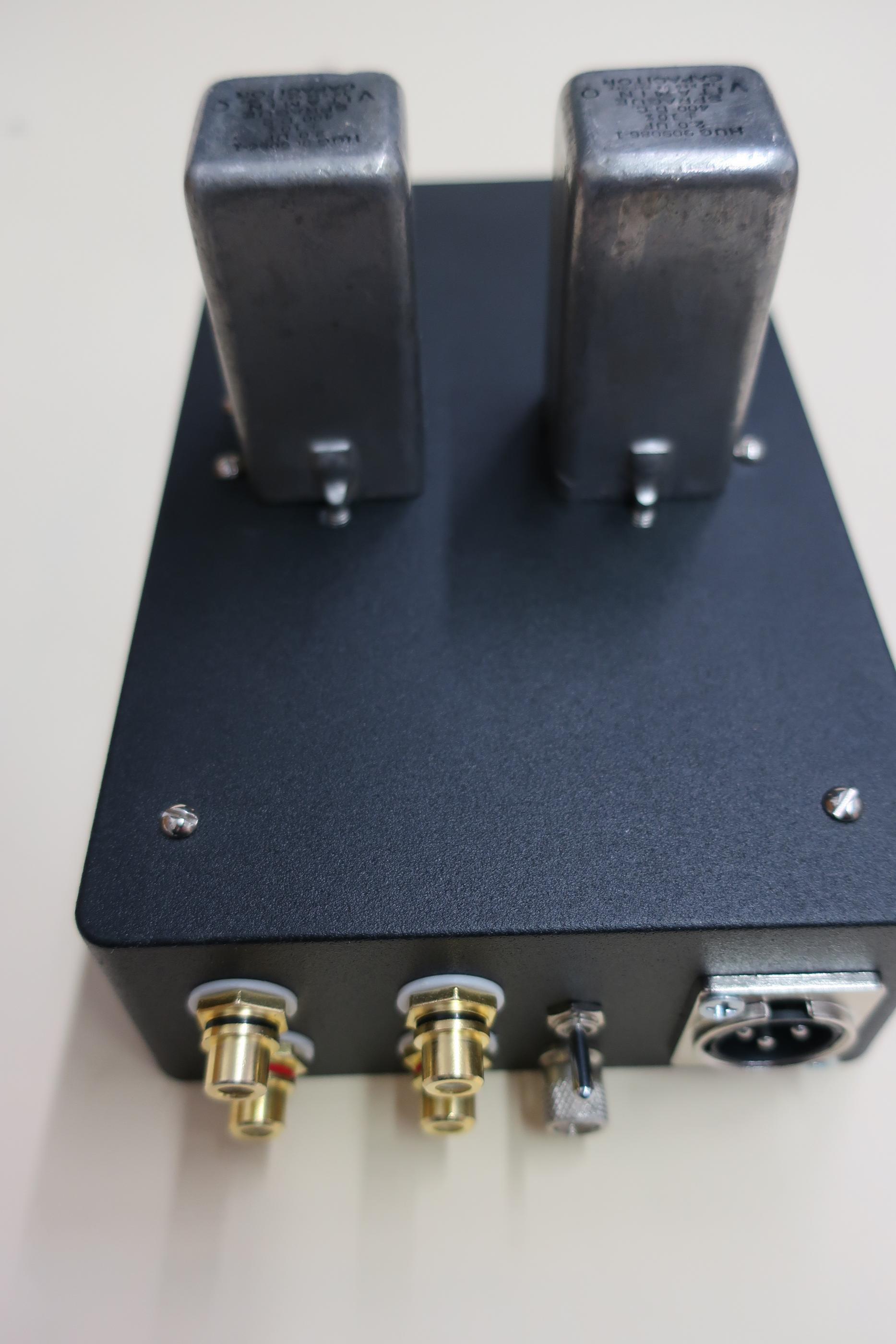

Just finished my Emerald, standard build and BOM, but I thought I include some photos of a slight variation; I used some cool giant 2.0uF Vitamin Q's mounted on top, bypassed with some Jupiter 0.22uF wax caps underneath. I also added a switch for MM/MC. so far so good!

@fiftyfivefilms That's some big capacitors! At first I thought you had some transformers mounted on the top there!
