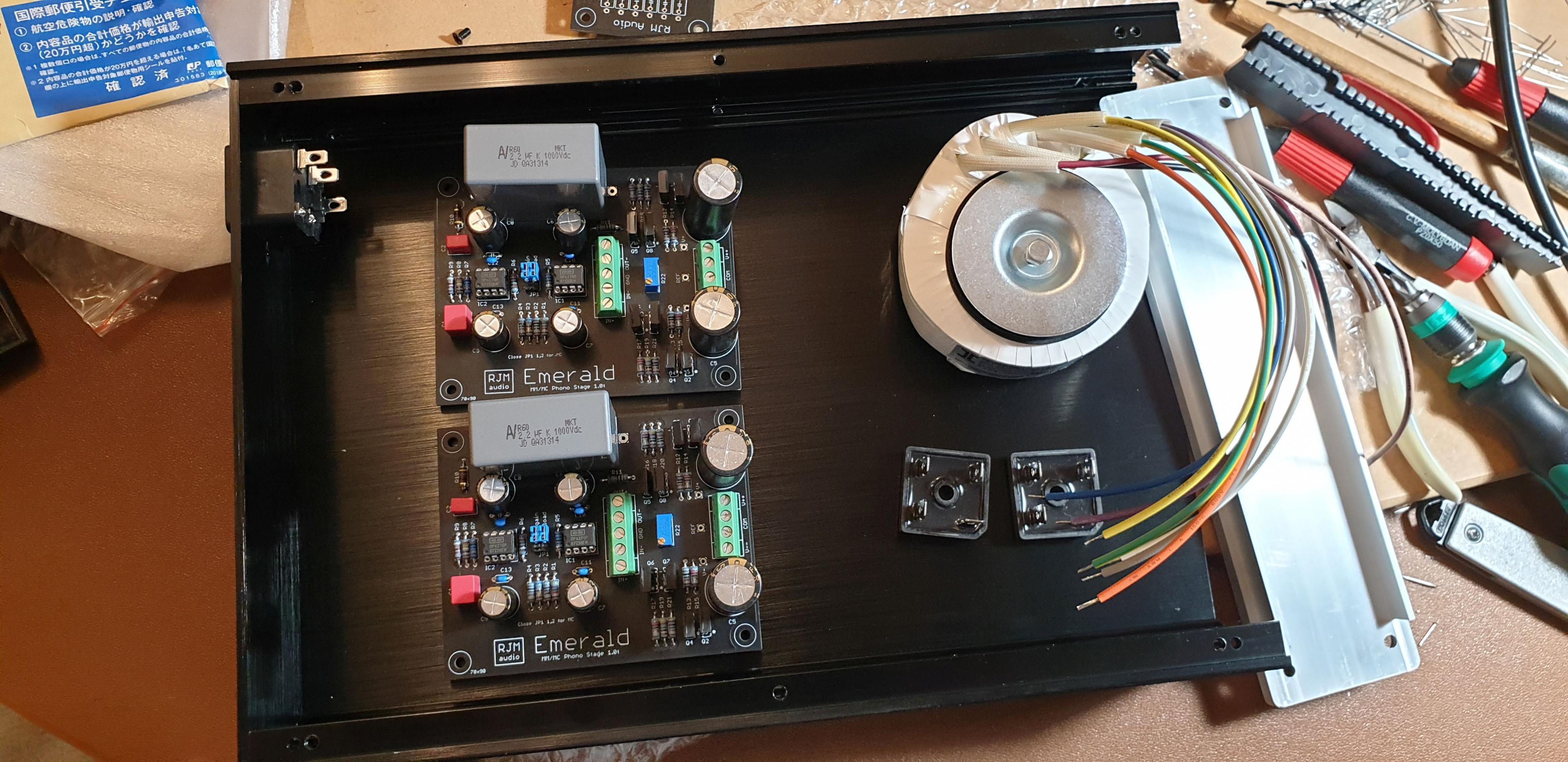

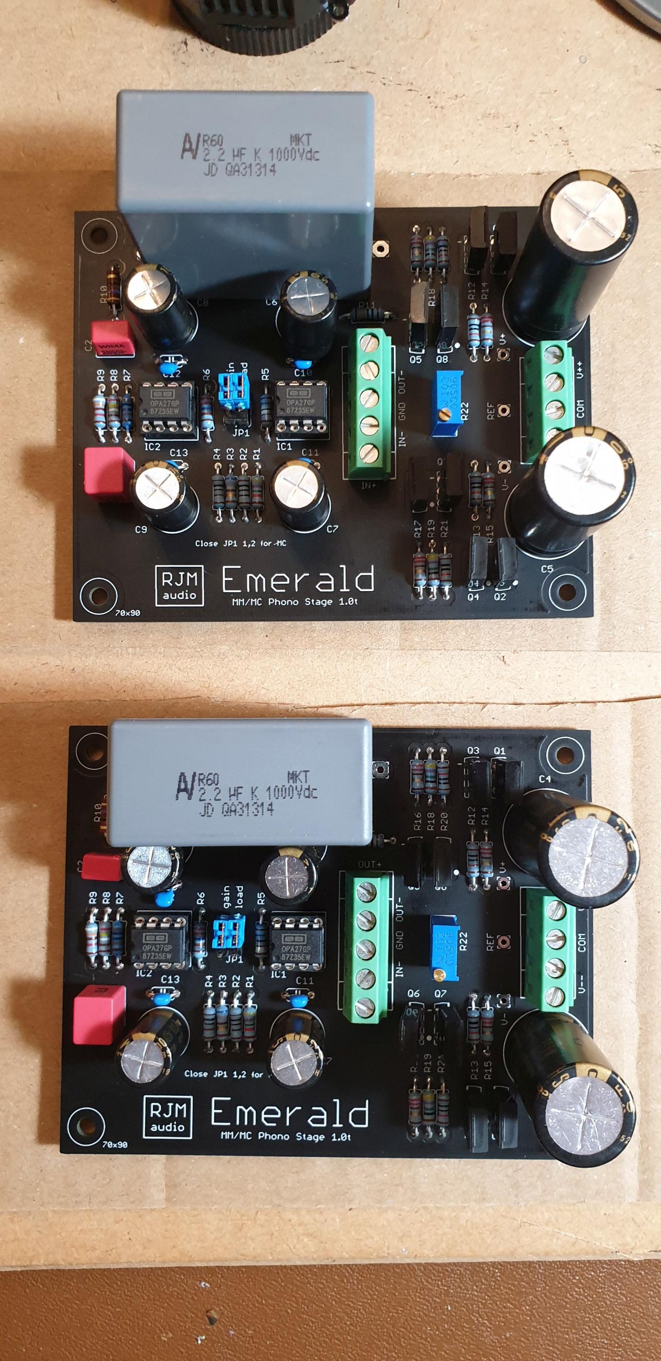

Well that was fun, 1st part done, populated two boards.
Used a square 2.2µF capacitor for neatness. Doubt I'll notice difference
KEMET Part Number: R60QW42205030KR60, Film, Metallized Polyester, Automotive Grade, 2.2 uF, 10%, 1000 VDC, 85°C, Lead Spacing = 37.5mm
"Typical applications include blocking, coupling, decoupling, bypassing and interference suppression in low voltage applications"
I have some audio ones as well to try/compare. do let me know if these are totally unsuitable and/or others that are square
I had to bend the pins for 2 of the Nichicon KZ Muse 100µF capacitators as per photo 2 so they fitted properly
Um.... need to change them then?
Here are some numbers for dissipation factor (DF), smaller is better:
Polyester (PETP) .5%
Polycarbonate .05%
Polyphenylene sulfide (PPS) .05%
Polystyrene .05-.02%
Polypropylene .025-.01%
Teflon (PTFE) .025-.01%
These numbers were culled from over 100 documents on the web.

The box capacitor that fits exactly into the space for C3 is the Wima MKP
Mouser #:505-M102.2/400/10P
Mfr. #: MKP1G042207E00KYSD
though I normally end up fitting an axial type, which is why there's the second set of wirepads outside of the box outline.

Enclosure layout
I have found a nice sized box(whd 215x55x308 external, 203.5x48x297 internal), not ideal to have transformer in same box but is neater. I worry about mains hum, so....
Two choices now, Put Transformer furthest away from the rear and the mains input, and hence shortest phono connections or vice versa?
picture is where the transformer is furthest away, putting phonos on same back panel as the mains input.

@keland
A long thin chassis will always present this dilemma. I recommend to keep the standard position of the connectors in the back, bringing the AC line from the rear socket to a front power threading the wire down the side of the chassis and keeping the transformer and diodes in the front, with the PCBs at the rear close to the input RCA jacks. A metal divider or box enclosing separating the AC power line from the PCB may help with noise pickup, but a lot of the coupling is inductive, so it won't be a definitive solution.
