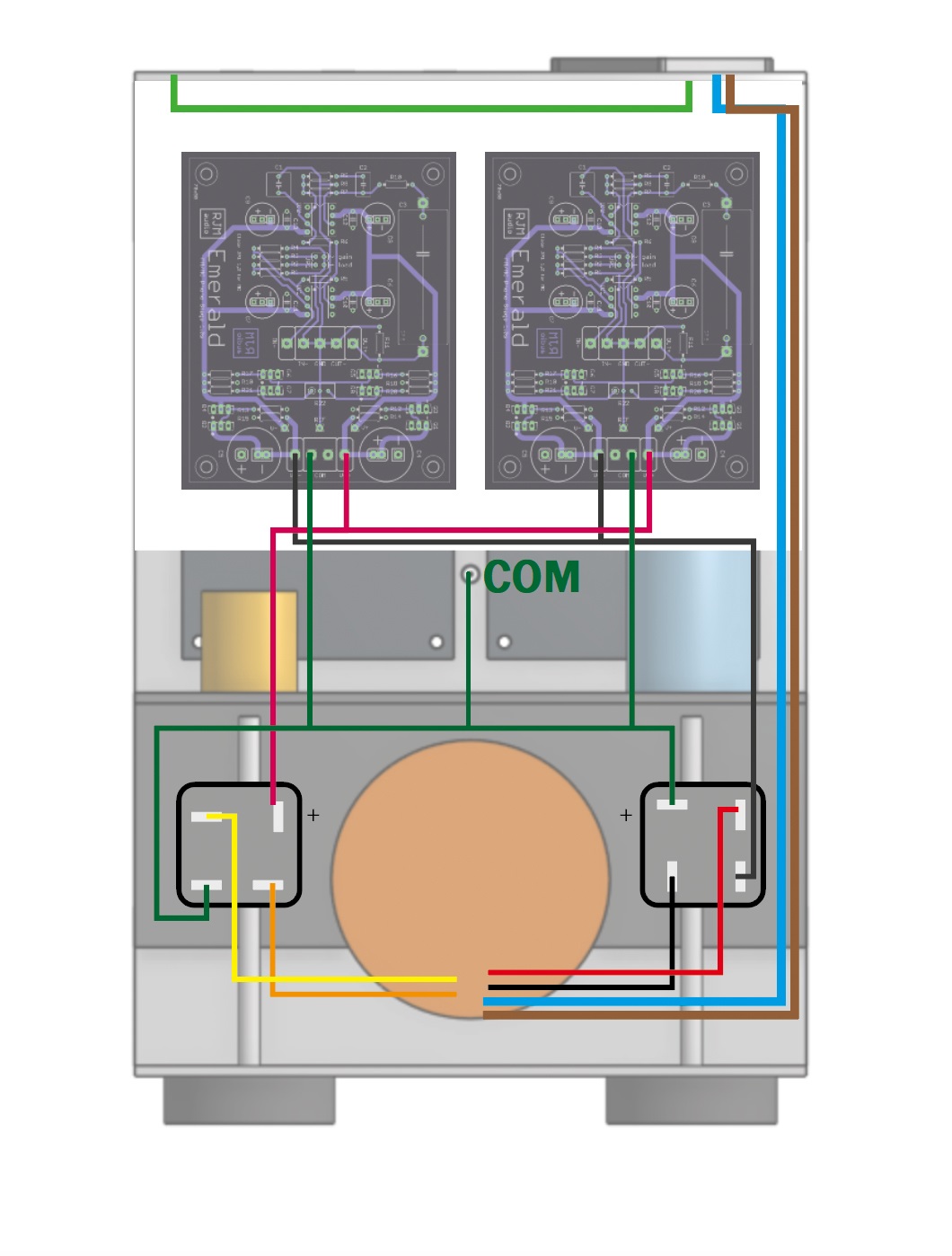

The wiring diagram shown in post 577 is correct. The voltages at the op amps may be a little less than 10 V, though with R20,21 at 10k ohms this is a little surprising.
What is the voltage measured at V++ and V--?
So I've rewired as per the diagram in post 577. I'm now getting +/- 12.65V on one board, and +/- 12.05V on the other. Should I be concerned about them not matching?

Yeah, you'll want to keep the COM wires off the PSU chassis, just wire to COM pads of the boards.

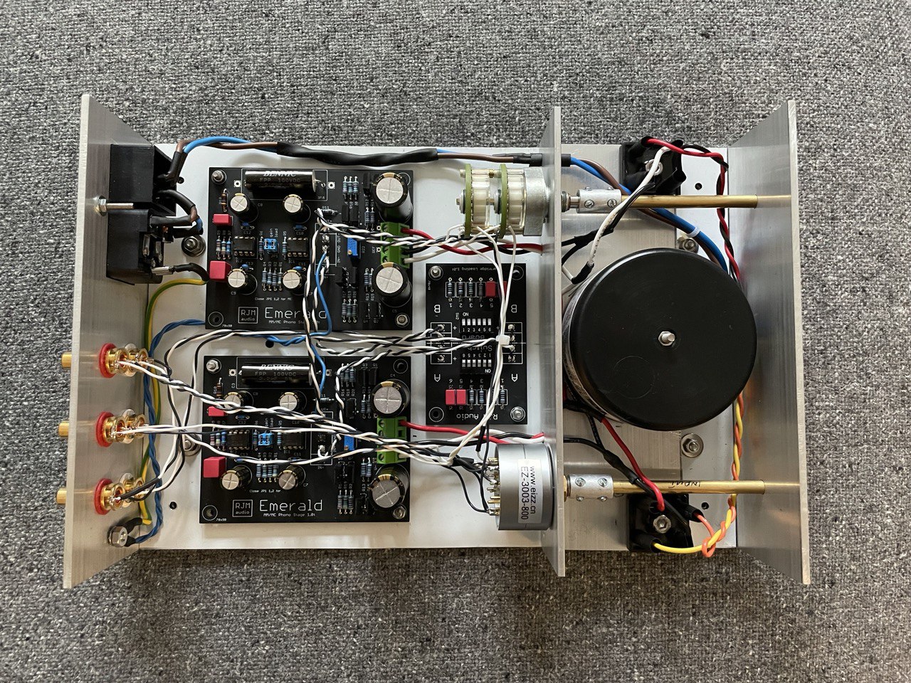

This is how it's looking with the revised power supply wiring. Since I took this photo, I've also connected both the GND points on the Emerald boards to the same chassis ground that the mains Earth is connected to - as per post 571. Unfortunately, that doesn't seem to have made any difference to the hum.

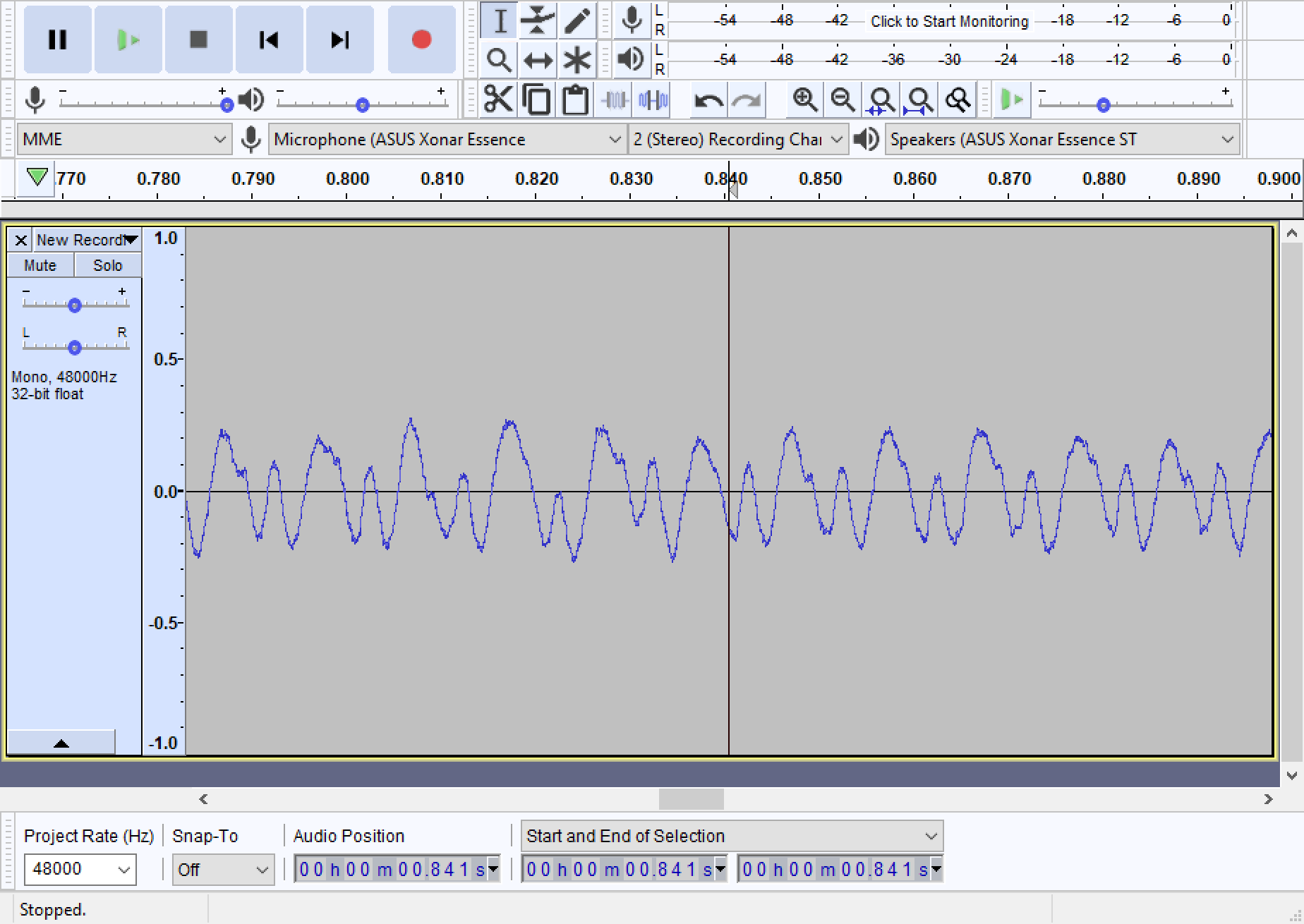

I made a recording of the hum, with my phone right up against one of the speakers. New Recording 2.m4a - Google Drive
As I say, that's what it's like with the stepped attenuator all the way down, and it doesn't really change until it's run nearly wide open. As soon as I switch power off, or switch to another input (with the power still on), the hum completely disappears.
I'm wondering if I have the stepped attenuator wired incorrectly? Currently, I have the Emerald OUT+ to IN, OUT- to GND then Goldpoint OUT and the same GND to separate pins on the input selector.
I've tried moving the Switchboard, Input Selector and Stepped Attenuator towards the rear (away from the toroidal), but couldn't hear any difference.

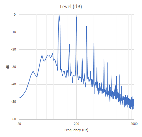

The noise is predominantly 100 Hz, i.e. rectified AC, but doesn't look much like the ripple normally seen on the Emerald power supply.
So I suspect a ground loop, and that what you are looking at here it are noise currents sourced from outside the Emerald chassis.

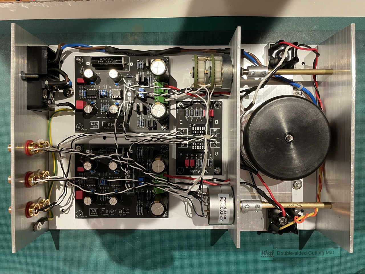

Here's a better pic of everything right now.

Ok, so I tried the following:
- disconnected the V++/V-- from the R board, but left the COM in = hum still in both channels
- same as above for L board = hum in both channels
- then I removed the COM connection as well from the L board = no hum!
So does this mean there's an issue with the COM loop?

What I suggest is you disconnect the GND pad of each board from the chassis, and connect COM back to the chassis instead, tapped at some point where both channels share a common wire.

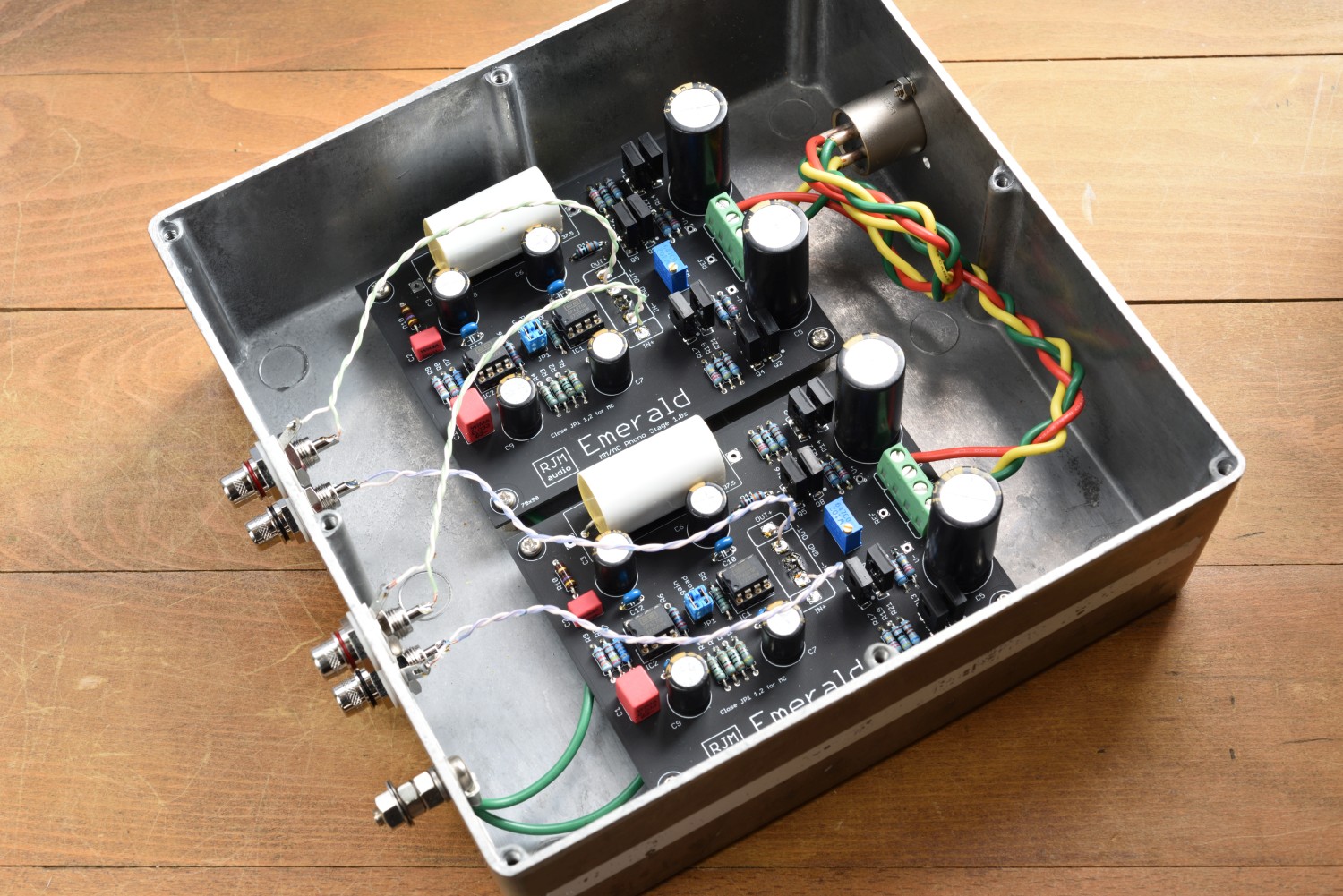

As for wiring, please see the attached image, which shows my most recent Emerald build.
I just tried detaching the board grounds from the chassis, but connecting a wire to the spare COM terminals on the Left board and touching the chassis at the other end. It didn’t seem to make a difference - I’m guessing ‘tapping’ point between where the COM wire splits is critical?
It shouldn't matter, as long as it's COM (i.e. behind the Emerald circuit).
But I'm confused. You reported that simply connecting COM to both Emerald boards induced hum, but connecting to a single board was silent, even with both boards powered down. That second connection should change nothing ... but if it does it could only be, I would have thought, because each board is separately connected to chassis (and earth) through the GND pad. If COM is earthed, and the boards are floating and isolated from each other, I cannot imagine how any kind of ground loop is induced by connecting COM to the second board.
For the sake of completeness however, I recommend connecting COM to chassis as soon after the rectifiers as possible.**
(** not general advice, but for troubleshooting here where GND connection on the boards is not being used)
