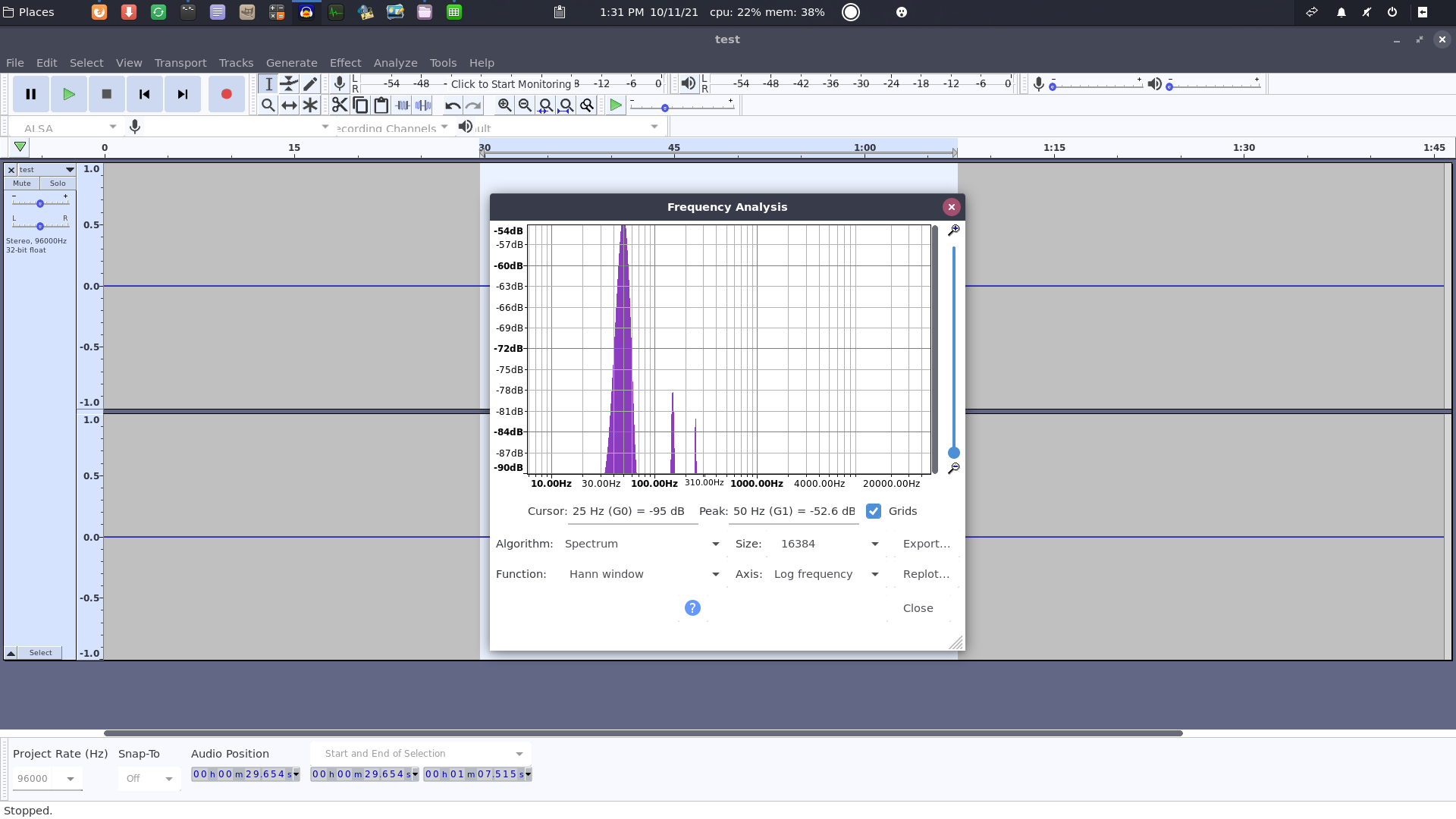

Is a -52 dB 50Hz hum to be fixed or accepted ?
Not sure if I am trying to track down something that matters not or matters...🙂
My Emerald is connected to an RME sound-card for recording.
When I test the sound-card with nothing connected the noise level is lower than I can measure.
When I test it with the Emerald connected and the Emerald inputs shorted the noise level is lower than I can measure.
When I test it with the Emerald connected and the Emerald inputs open there is a 50Hz spike @ -52dB and harmonics at 150 and 250 Hz.
When I test it with the Emerald connected and the Emerald inputs connected to my MM phono cartridge there is a 50Hz spike @ -52dB and harmonics at 150 and 250 Hz.
Screenshot attached.
I have tried all I can think of to reduce the 50Hz but perhaps I am chasing insignificance ? 😱

I'd normally measure the noise of a circuit with the inputs shorted, or with a dummy load. This can be considered the true output noise generated by the circuit.
With the inputs open circuit it's not too surprising to get some hum, as the input circuit has an impedance of 47 kohms so easily picks up electrostatic interference from the power supply.
With a cartridge connected the impedance drops to 500 ohms or so, but on the other hand you have an electromagnetic transducer (the cartridge) and several feet of wire attached to the input, providing additional points for interference noise pickup.
To confirm that the VSPS itself is blameless, you can connect a 500 ohm dummy load to the inputs instead of just shorting them. This gives the input section the same opportunity for noise pickup as in actual use with a cartridge.
If the hum is gone, the problem exists in front of the VSPS inputs: the cartridge/phono cable is picking up noise. If the hum remains, there is strong interference getting into the input section, so it will be necessary to distance the circuit from the source of the interference, or shield it.
-52 dB measured at the output is not terrible, not great. Definitely more than I'd be happy with, but low all the same.
I'm going to guess it's an interference issue. Ground loops are usually omnipresent regardless of whether the inputs are shorted or not.

With a dummy load of 470 ohm the 50Hz peak remains but is reduced in amplitude to -63dB....
So..... it seems that both options need pursuing... ?
I have made considerable progress.
1)Shortened and braided the leads from the remote power supply...no change.
2) up-rated the on-board supply caps from 1000uF to 4700uF... slight improvement.
3)replaced the twisted pairs of input and output signal cables with twin and shield, fixing the shield to the ground on the board...much worse!
but that was a big hint ! and after checking the grounding of the boards I found an error in my assembly and corrected it.
Now, with 470 ohm shorting plugs on the inputs the 50Hz peak is at -80.7 dB which would appear to be acceptable.
With the cartridge connected instead the peak rises to -64.3 dB so I have some more work to be done on cables between the cartridge and Emerald... (though Grados are known to be 'hummy' so I may try another cartridge just to check)
Thank you Richard, for pointing me in the right direction, and the useful comments as to expected behaviours and sources to investigate.

That's great! -80 dB sounds about right, and yes, Grados are "hummy" in my experience, so nothing abnormal there.
What was the error that you had to fix?
😱 I had moved the boards to a new case recently and must have been in a hurry as I forgot to connect the Ground point (between the In/Outs on the board) back to the earth on the remote power supply case.

That's interesting. Normally the GND connects to the chassis of the VSPS, it doesn't route back to the power supply / earth, unless it's a one box build. I say that because in my experience making that connection increases hum, but here it's the opposite. Good to know both possibilities exist.
I have re-routed cables and placement of equipment.
Now I have around -70dB @50Hz peak at the start of an LP and -54dB at the end with the Grado cartridge.
This would appear to be the best that the Grado can achieve and in the coming week I will sub my Nagaoka which should be more immune to fields and more consistent across an LP.

Those numbers seem about right. Grados are simply more prone to hum than other brands, at least that was my experience way back before I started using the Denon.
