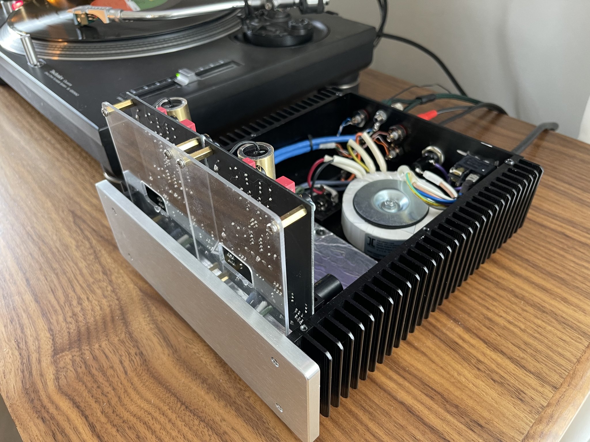

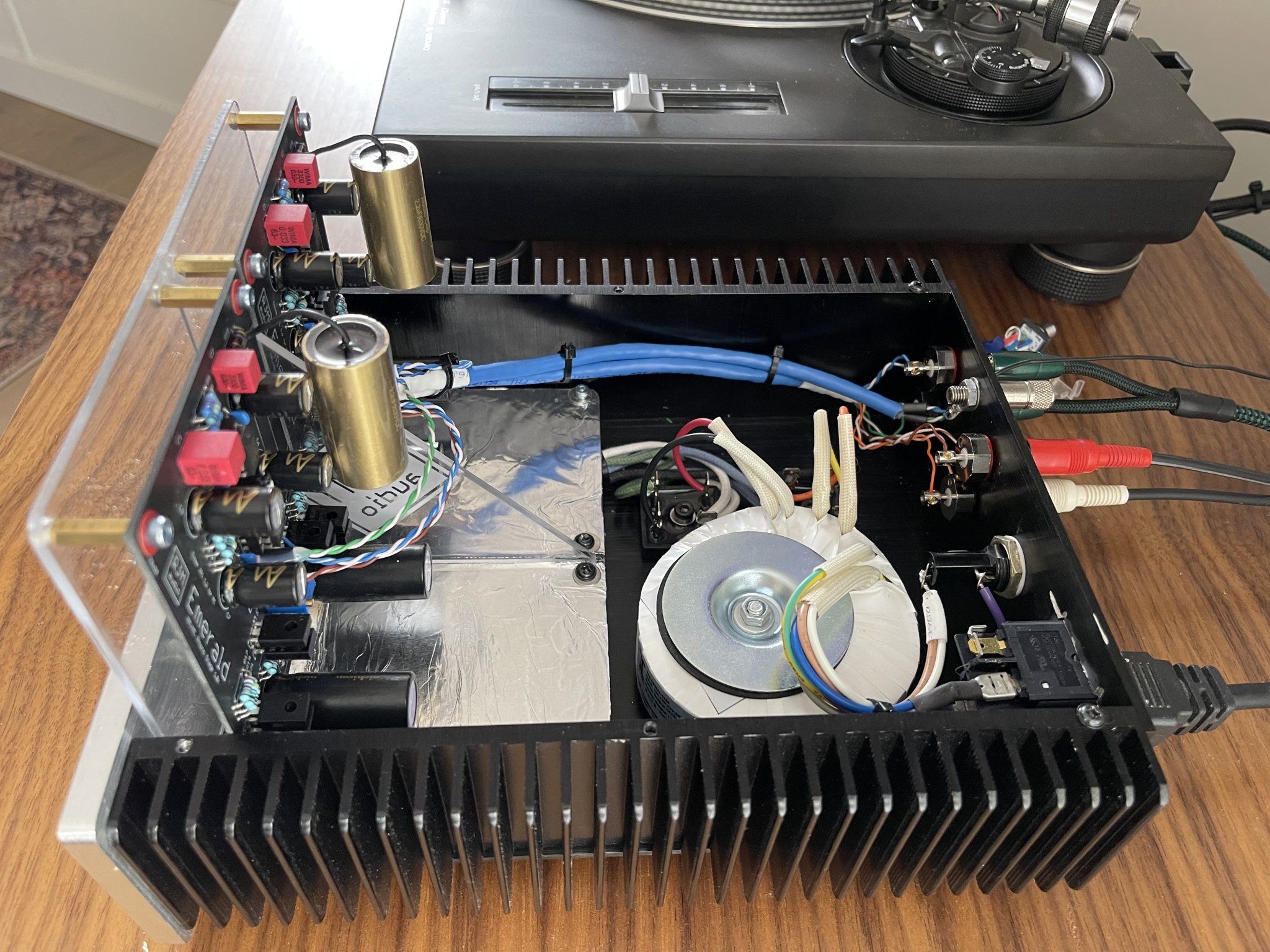

Thanks for the quick reply, turns out my compromised single enclosure “everything jammed way too close together but it’s what I have to work with” solution worked fine for MM but introduced some noise when I swapped over to MC. Separate enclosures are on the way from Ali express for a more permanent solution but this janky fix to get the boards further from the rectifiers and toroid has gotten that noise from “legitimately annoying” to “barely audible” and will totally hold me over for a month while I wait for the other enclosures to show up.
The diode can radiate out noise which is picked up by the big coupling caps, so moving the caps away from the diodes (and transformer, and AC wiring) should fix things.
Also, those black anodized cases are notorious for having bad electrical contact between the various metal pieces. Some sections can therefore end up disconnected from the earth unless you are careful to scrape off the anodized material at the joins.
You’re absolutely right about the anodized coating, I thought I was pretty thorough with my scraping and when I was trying to figure out this buzz I found two things that should have been grounded that were showing like 500ohms to ground.The diode can radiate out noise which is picked up by the big coupling caps, so moving the caps away from the diodes (and transformer, and AC wiring) should fix things.

its basically just going to look like a weird science experiment until my pair of new enclosures arrive but I kinda dig the aesthetic for now.

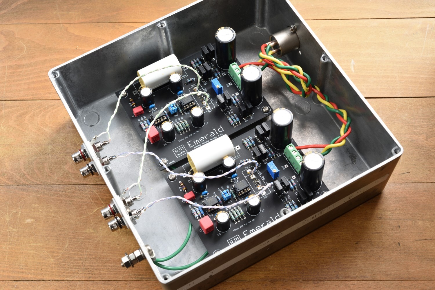

Hey Richard,
I'm looking to build my first Emerald stage and wanted to build it similar to the one you built in this picture. I'm going to build the power supply and phono stages into separate housings.
I understand that you prefer to use solid core twisted pair cable from ethernet / LAN cable for the signal connections.
Can you tell me what cable you are using for the DC connections?
Do I have to use anything special for the DC interconnect cable or do most people just use 3 core mains cable?

To reply to the above,
1. I use unsheilded 3-wire AC cable for the umbilical, with an XLR connector at the phono stage side, and the power supply side hardwired.
2. V+ should be 9-13 V range, and yes, using 22k instead of 22 ohms would disable the S-reg circuit and cause V+ and V- to both fall to zero.
