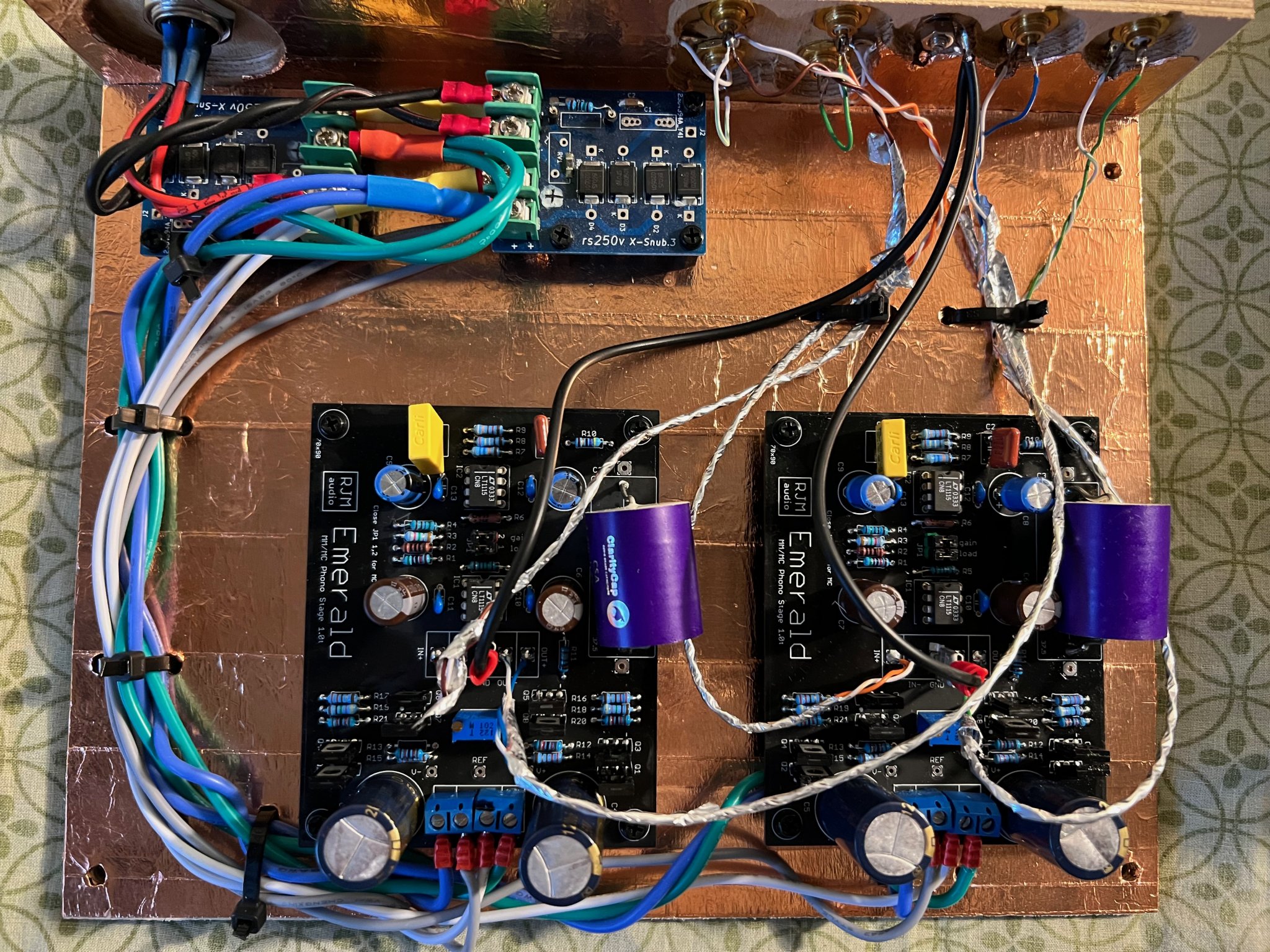

My humble contribution -- a dual mono approach [shortly with two PSU] -- using what I had handy.
https://photos.app.goo.gl/z7AMP1SV7gsjXpmy6
I always like being 'first' -- thanks for the feedback. Q: Have you ever listened to the Emerald with MUSE03 op-amps?Thanks for the pics. While I had designed the possibility to cut the Switchboard in two, to my knowledge you are the first person who actually went and did it!
