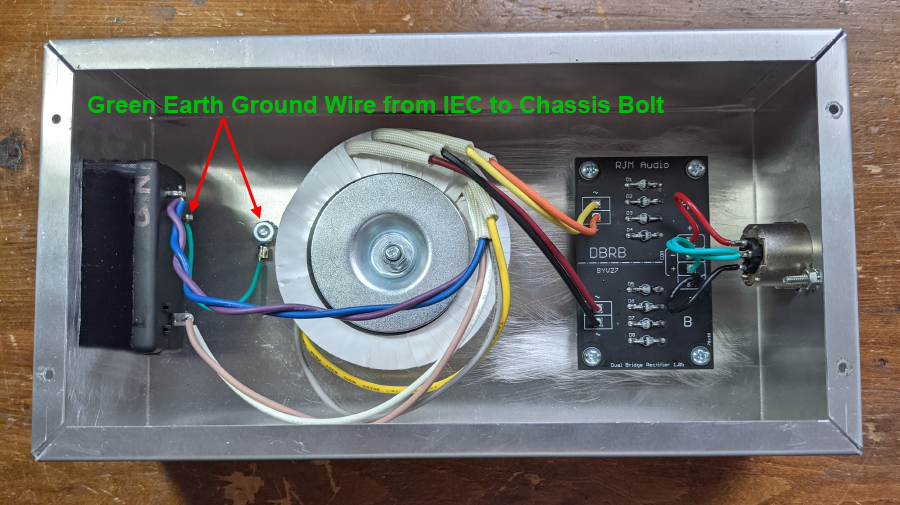

@Dwinstonwood; do you have any psu image as well, if built as Richard intended?
In this photo I had not yet connected the power transformer shield wire (green/yellow on the Triad VPM24-1040) to the ground lug.
But, aside from the PT shield wire there is only the one short green wire from the IEC inlet Earth Ground tab to the chassis bolt.
I sorted out the psu cables and have now tried a two case version and the hum is down to negligable. Too much volume equals hum, but that is way too much volume
When I first turned it on, there was as much hum as before but it was reduced significantly when I also connected the turntable. I never thought that would make a difference. Then I switched back to a single case again with a jumper between psu coms. Everything connected and switched on... satisfaction. The same amount of hum as with an umbilical, which is almost none except for when going loud.
Conclusion: build is done and I will order a single case for both psu and phono. Will post pictures when complete.

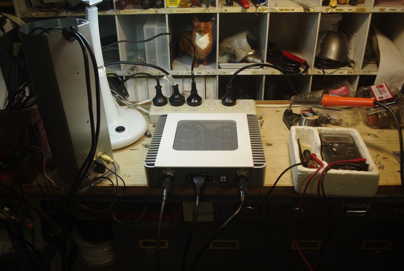

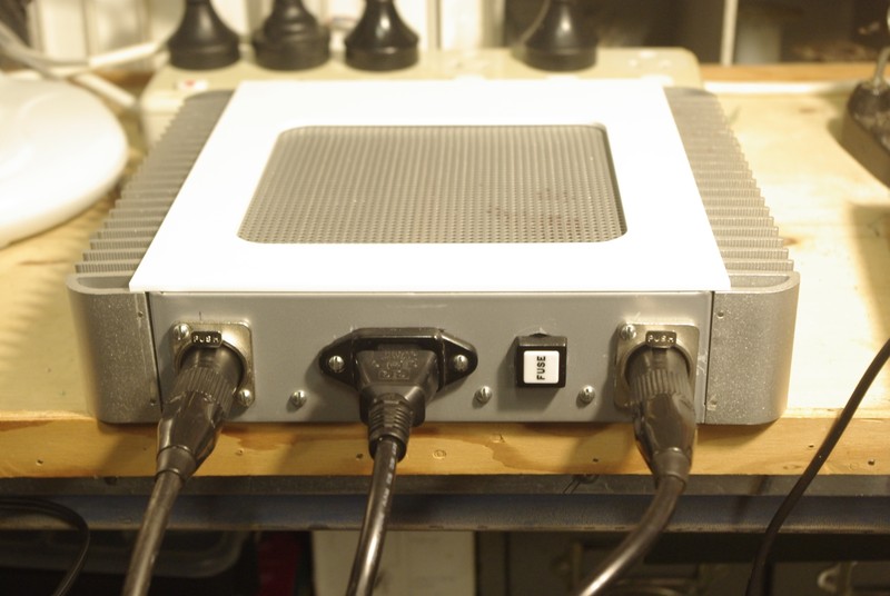

New power supply for Emerald (Tested )so that I have two...one for the Emerald and one for the Sapphire.
Next to try Turntable>Emerald>Sapphire (as line stage)>M-Audio Audiophile 192 and recording !
Yes the box is a little odd but there were two of them for $5.00 the pair....at the recyclers and they looked ideal for an Emerald and its supply

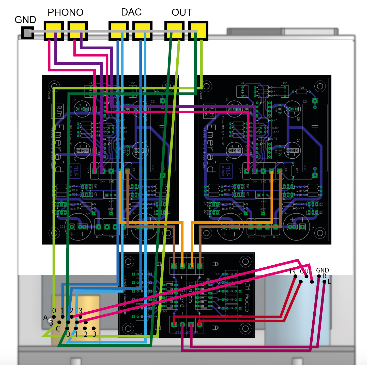

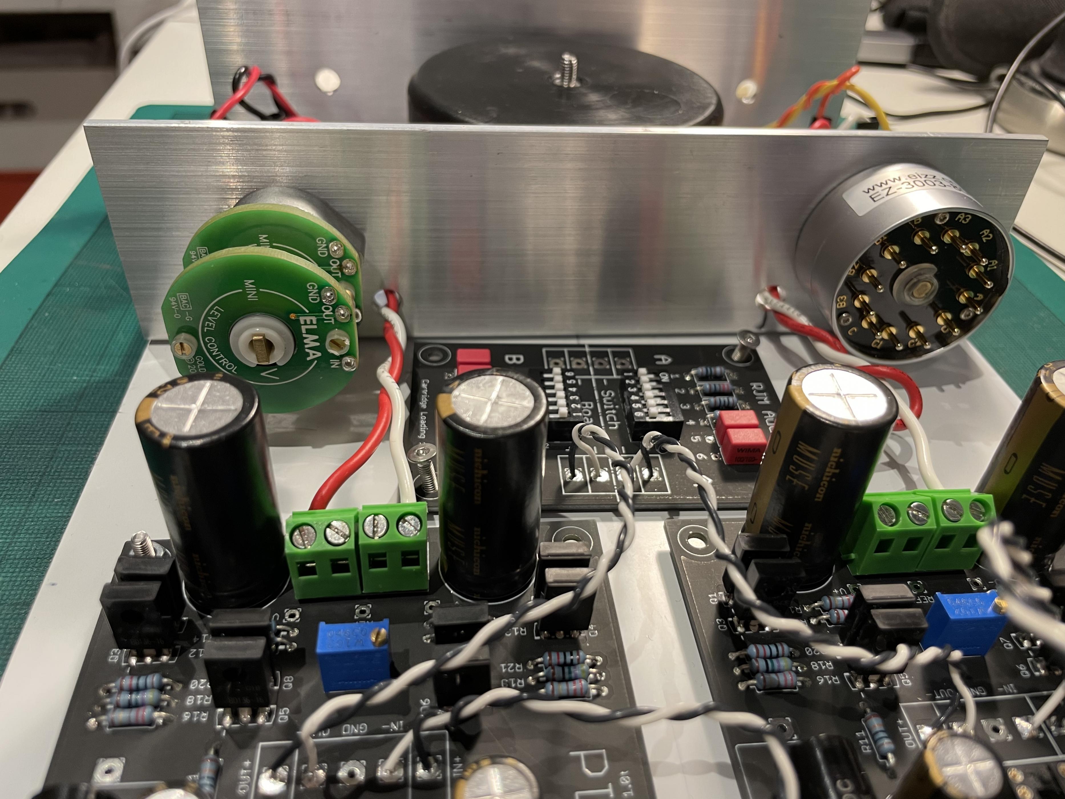

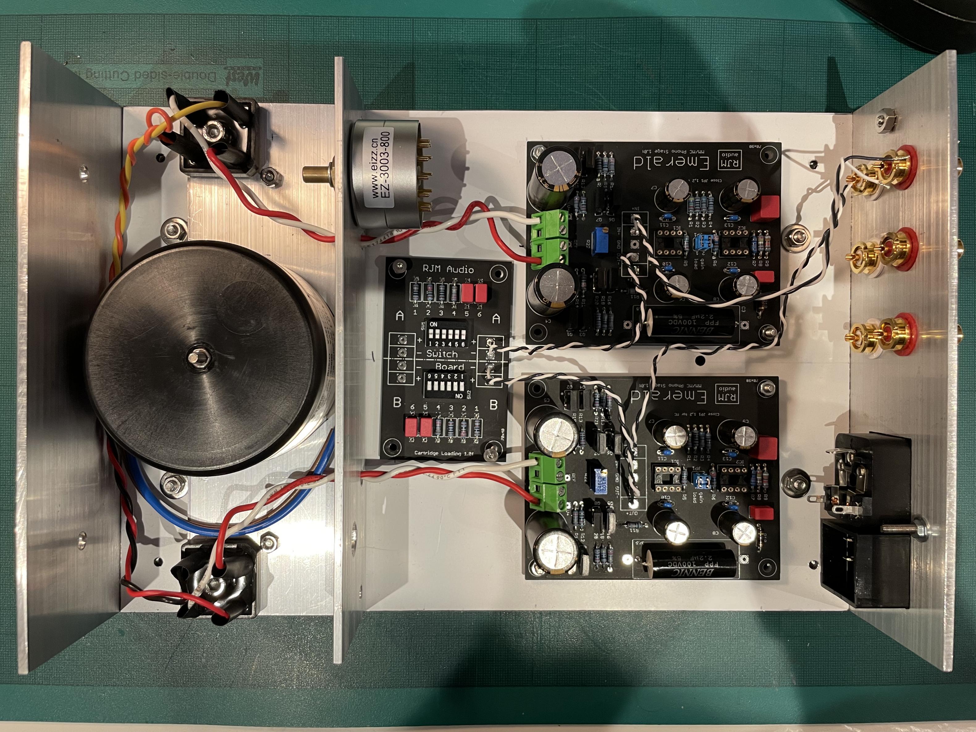

Hi all, my build is hopefully nearing completion, but I'm going round in circles trying to work out how to wire up the additional input selector and stepped attenuator. Images below.
I've cobbled together this 'schematic' to show what I'm currently thinking. The bit I'm unsure about is the lack of ground connection between the attenuator (bottom right) and the input selector (bottom left), and whether I actually need to wire the ground from each phono socket to the input selector? As per the schematic, and based on what I've noticed from other input selectors, it seems fairly typical to tie the grounds together at the sockets, so could I do away with the ground connections between sockets and input selector?
Any other comments/corrections, very much appreciated.
