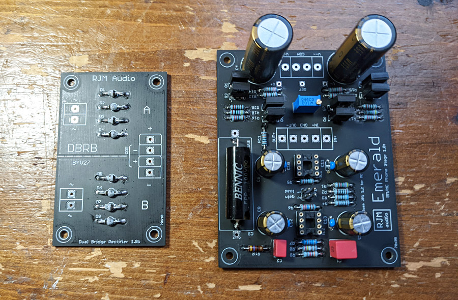

Funny, I always build both boards in parallel, step-by-step, rather than complete one first then the next.
That makes sense. I was concerned about making one mistake, not two, I guess, i.e., I'd have a correct assembly to check the second one against.

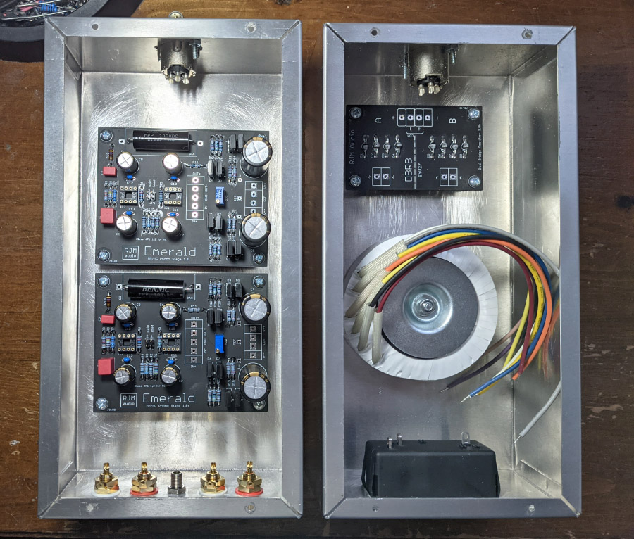

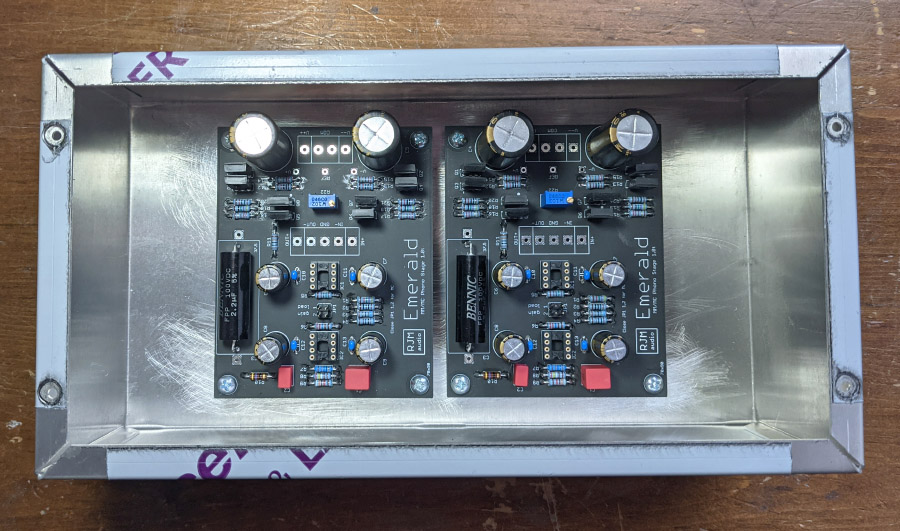

Here's a test fit with the standoffs in a Hammond 1444-9553 aluminum chassis (9 1/2" x 5" x 3"). Yes, this is a budget build. These chassis are only $13.40 each from Hawk, and can be painted. My initial plan is to make hardwood lids and laser engrave an "RJM Audio Emerald" logo on them at work.
The boards fit good with plenty of room on the short sides for the jacks and wires.

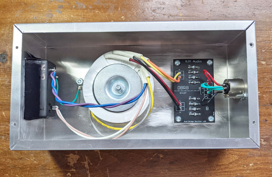

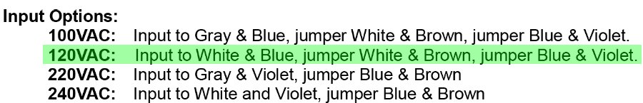

I'm confused about the Triad VPM24-1040 primaries. Looking at the 120VAC instructions from the Triad datasheet:
Is it telling me to twist the White and Brown wires together and the Blue and Violet wires together and then connect the incoming Line to one pair and the Neutral to the other pair for 120VAC?

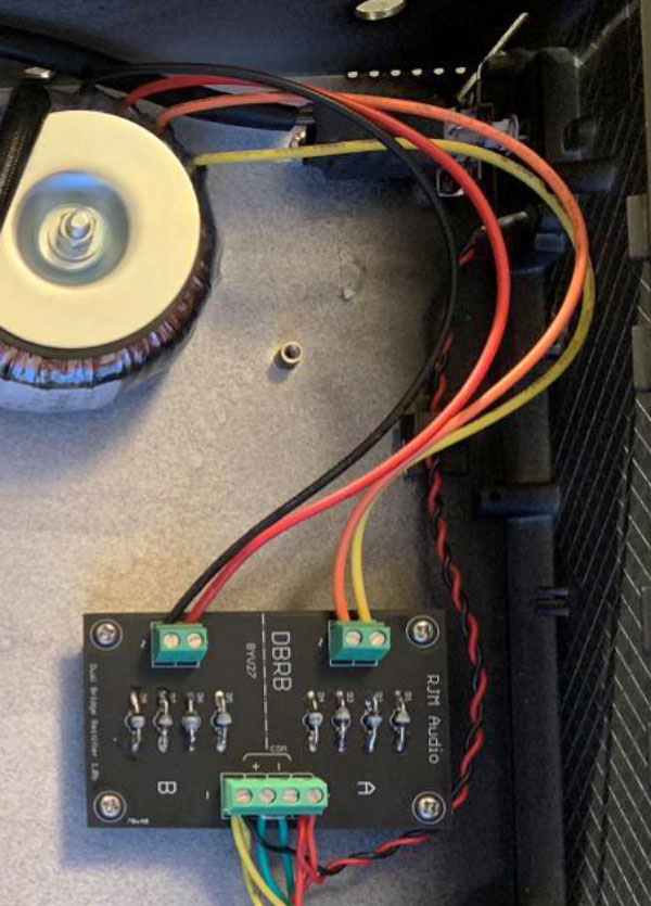

I assume the secondaries are wired like the photo below; Red and Black to one bridge and Yellow and Orange to the other bridge.
Thanks for the help with is. Transformers with multiple windings always confuse me.
The datasheet doesn't make it as obvious as it could be. For 120 V connect the primaries in parallel. Blue/violet to live, Wht/Brn to neutral for example.

Thanks, I didn’t see it was also 240vac. It’s settled thenWhy not use the Triad from the BOM? It's 110-240VAC input.

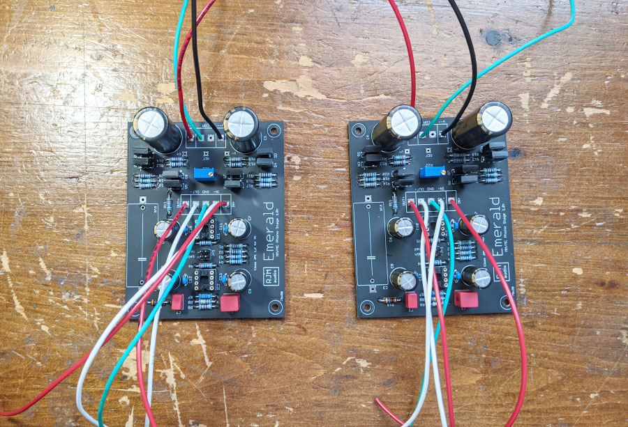

I've added the wiring to the boards (soldered from underneath).
