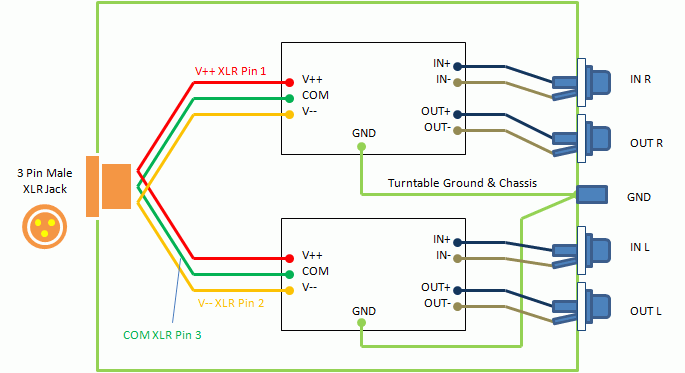

I think 3pin should be sufficient (unless you're building dual PSU's, one for each board).
You take the +/-/COM through the 3 pins, and then wire in parallel in the Emerald box.
If 3-pin, you could use standard XLR. Female at the PSU output and Male at the Emerald input.
Something like this: https://www.neutrik.com/en/neutrik/products/xlr-connectors/xlr-chassis-connectors/dlx-series?c=audio

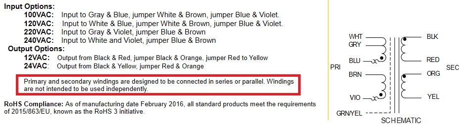

Quick question on the transformer connection (using the TRIAD suggested on BOM).
Do I just blatantly ignore the intended use and run each secondary to their own bridge, or do I jumper them - potentially just running all wires to one bridge, then to the other from there? What would be best?
Do I just blatantly ignore the intended use and run each secondary to their own bridge -
Yes. 🙂
If you prefer to wire up both secondaries to a single bridge (and of course you are welcome to do that) then you'd connect the secondaries in series and connect the center tap to COM. The top and bottom of the secondary winding connect to "~" on the bridge.
Great, thanks for clarifying! I already have 2 bridges fitted in the cabinet, so no reason not to utilise both of them 🙂
btw I confirmed with Triad that this connection is safe. While technically "separate" the two windings are tied through the diodes so there is only ~1V between then.

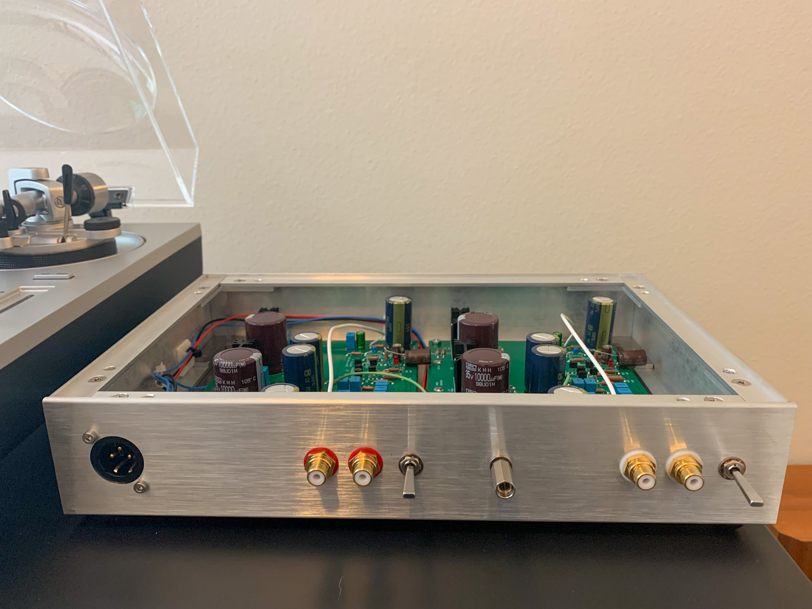

So I finally got the Emerald finished a few hours ago.
And now we're listening with renewed enjoyment of our records. I guess we will sit here until late in the evening.
We're experiencing great frequency response. Especially low ends are much more present.
Separation is also heaps better.
Unfortunately we didn't get our GyroDec/Quintet Black combo yet. But we feel the RIAA is ready for it.

Thanks for sharing your initial impressions. Please leave the newly finished unit powered up for a few days to allow the capacitors to break in. The sound will change quite a bit.
What enclosure
What are the enclosures you have used? Looks really great!

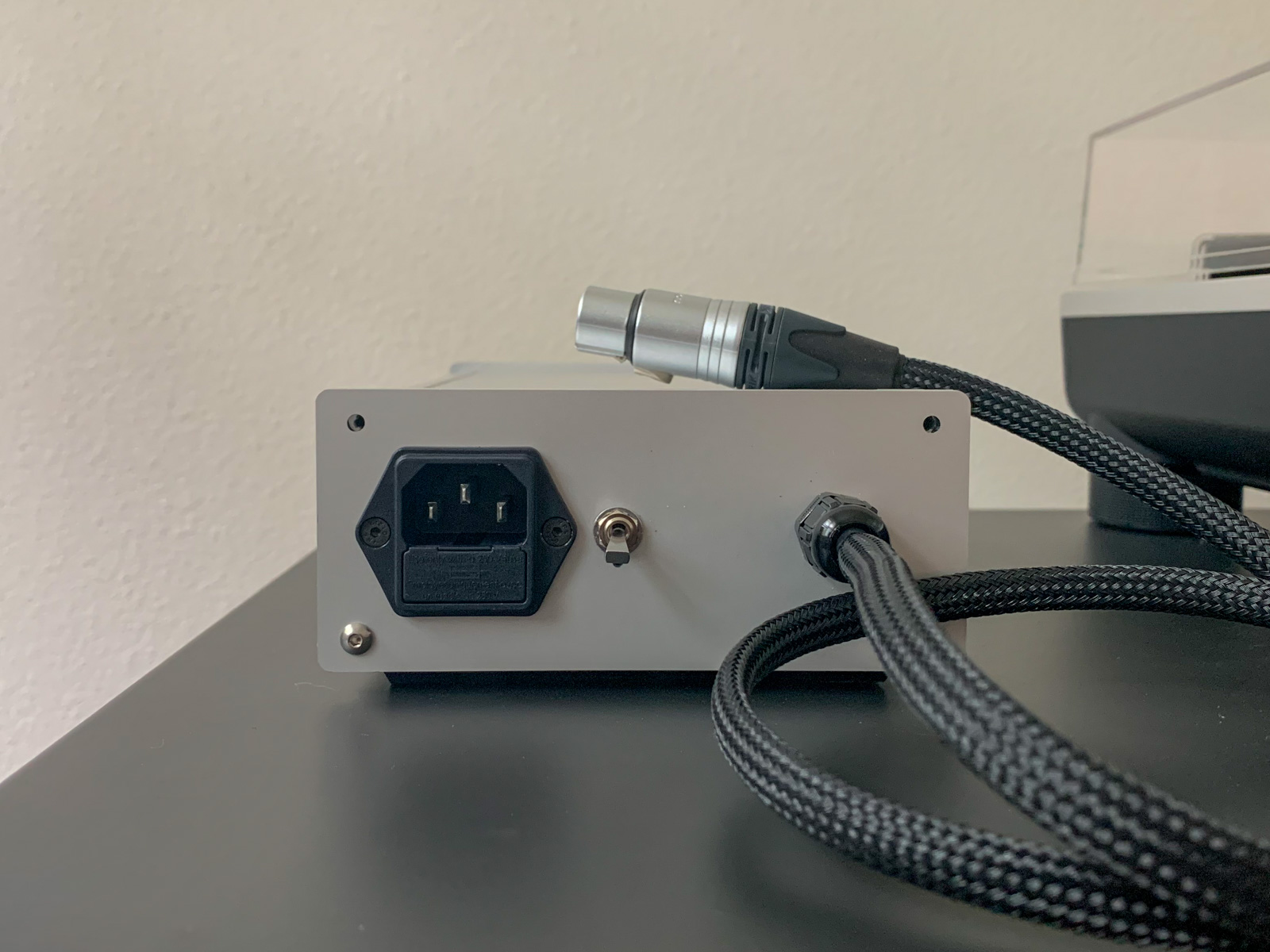

Great! Quick note is that you can save on connectors if you hard-wire on the PSU side and use a cable "cinch".
Picture attached
Thank you!!
I use Hammond 1455 series for the PSU.
The amp itself is in a custom chassis by Landfall Systems (BTW, those photos were from a Pearl build, not Emerald, but its the same idea).
I've also had success using the Par-metal 12x8x2 with panels from Front Panel Express.
These aren't cheap approaches, but end up really nice.
