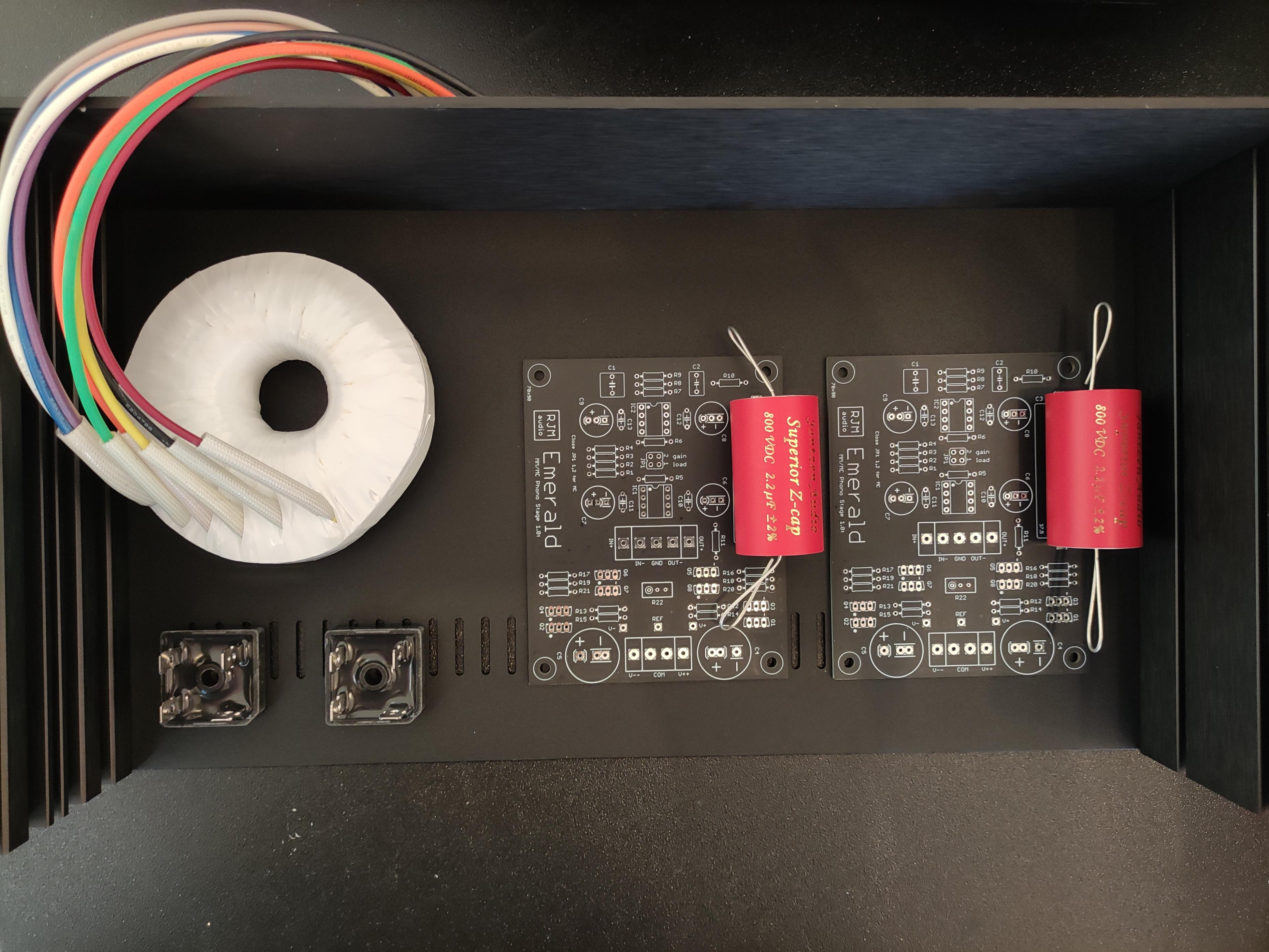

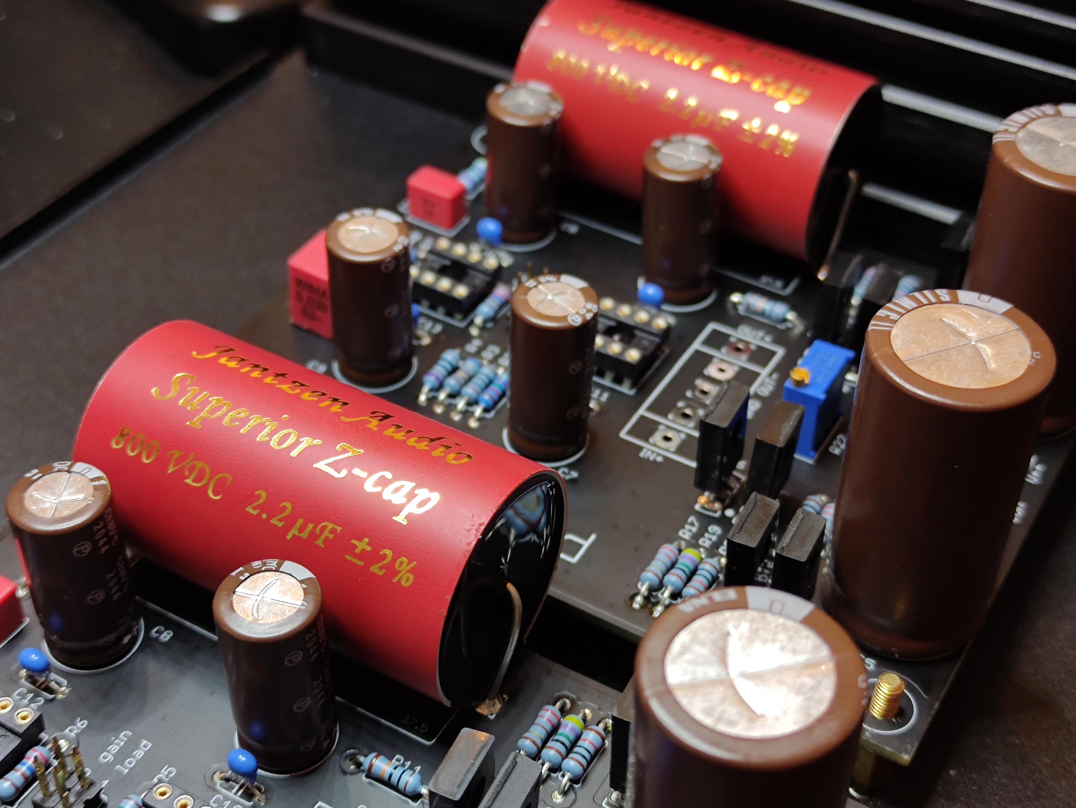

I finally completed my first Emerald project. After a few initial issues and with Richard's help I got there eventually. The result is quite impressive, the Emerald has replaced a Linn Linto phono stage in my system featuring a Dynavector XX2 cartridge. I have to say the Emerald performs really well and my first impressions are that it is superior to the Linto. Probably needs a few weeks of settling in before I can make final conclusions. The only changes to the original spec are: Mundorf MCap ZN Capacitor as a replacement for C3 and Van Damme balanced cable for the internal signal wiring - this helped with some RFI I was experiencing

I'm so inspired by all the beautiful work being done here.
The mailman better hurry up and deliver.
Hifi2000 enclosure and silkscreening equipment is ready to go.

Not sure if this has been asked before - but is there any particular reason for R10 to be Carbon Composition, and not Metal Film like the rest?
@brinker
Carbon composition are noisier than metal film, but are less inductive. The noise contribution from a 47 ohm resistor on the circuit output being negligible, I prefer to use carbon comp at this position.

First order from Mouser is placed. Only items missing are the Nichicon KZ capacitors which were out of stock and the C3 capacitor were I'll probably go for a Mundorf M-Cap Supreme.
The psu will be next, and I'll probably look for an enclosure to fit both, maybe a Hifi 2000 Galaxy GX383 330x230
This will be fun... maybe not so much for all of you when I start asking stupid questions. 🙂
