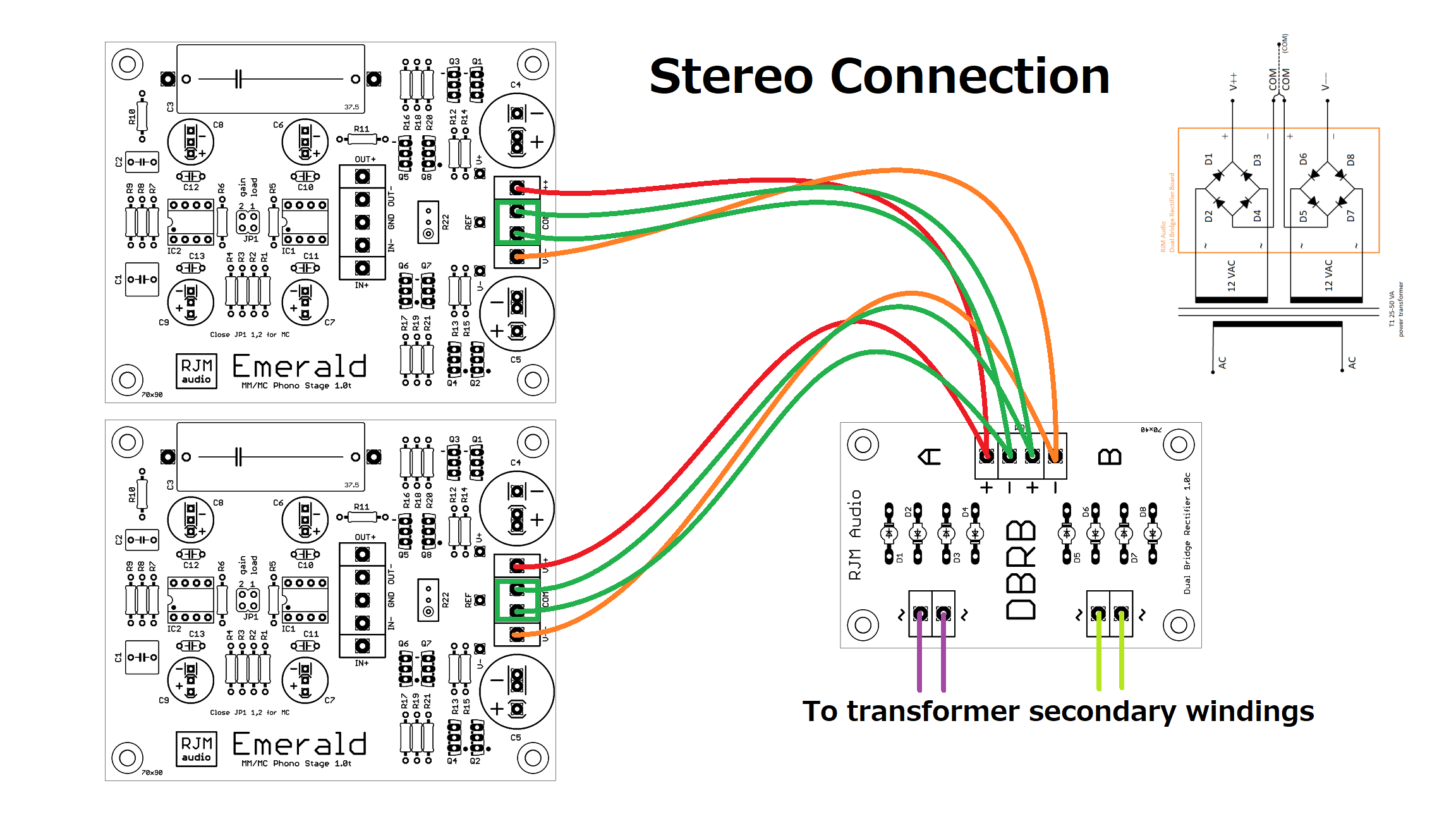

Hi Richard,
I built my first Emerald. I am trying to adjust the internal voltage (V+, V-) with R22. On one of the boards I am getting a reading of 12.92V centered. However, on the other board I am unable to bring the reading below 16.96V centered. What am I doing wrong?

Here I need to break and explain a little bit about the DBRB board. It does the job of two bridge rectifiers, holding 8 individual diodes in two independent and identical groups of 4 (A, D1-4, and B, D5-8). Key point is "independent". To keep general purpose functionality, I do not wire the bridge rectifiers together internally, and the diode connections (~~+ -) and (~~+ -) are electrically isolated. When used with any of my boards the "-" of bridge A and the "+" of bridge B are normally both connected to the circuit common. This is indicated (somewhat confusingly, I now see) by drawing a white box around the outputs and writing "com" next to the box. That was meant to stand in for me saying "Please connect these two to the two COM pads on the Emerald/VSPS/Phonoclone/Sapphire boards"
It did not mean "These two pads are connected together internally", even though on the Emerald boards etc., two pads enclosed in a white box means exactly that. i.e. the two COM pads are literally just two pads connecting to the circuit common (ground).
The difference is critical. On the Emerald you can use both or either COM pad as you like, it makes no difference. On the DBRB, you have to ensure that both pads are wired together somehow. You can jumper across at the board and take a single wire back to one of the COM pads on the Emerald (&c) or, as I had intended, you can run two wires, one from each pad, back to the two COM pads on the boards, where they join up anyway.
It's a textbook build, two emerald boards share a spacious (recycled) case with a single power transformer, DBRB, and switchboard. All nice and neatly put together. Nothing suspect. Normally these kinds of builds work perfectly from the outset.
The symptoms were just plain weird. Inconsistent and unusual voltages in the power supply, strange whine or rumbling noises on the output, lower than expected signal.
In this kind of situation, you should normally target the power supply. Once verifying that the regulator circuit is functional, that leaves the transformer, diodes, and connections.

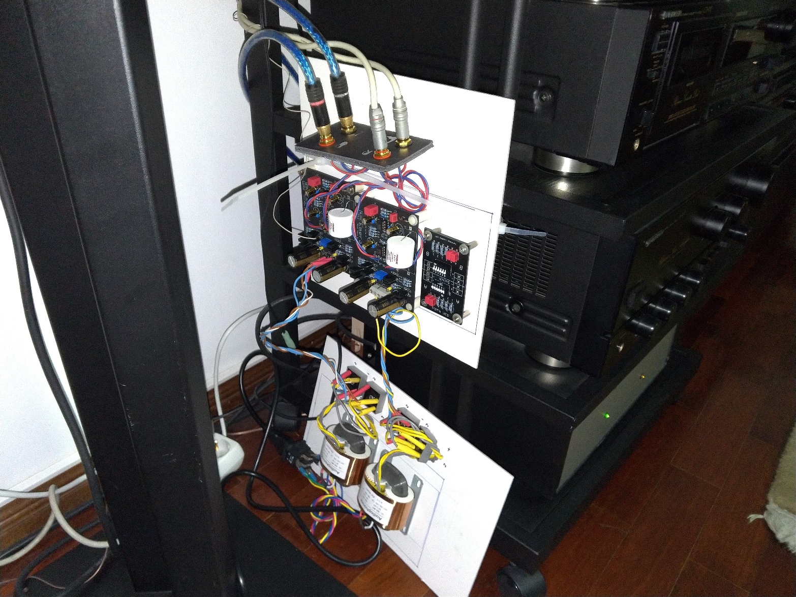

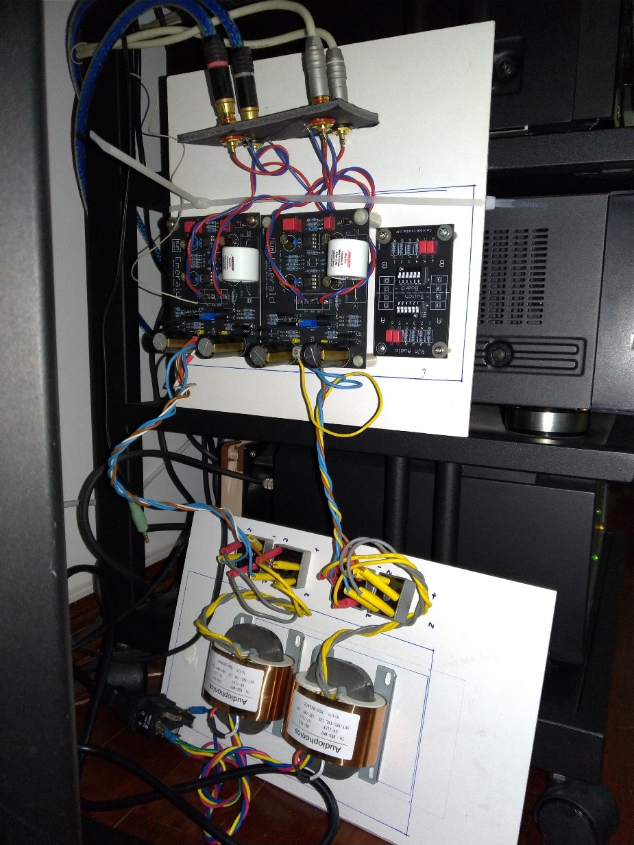

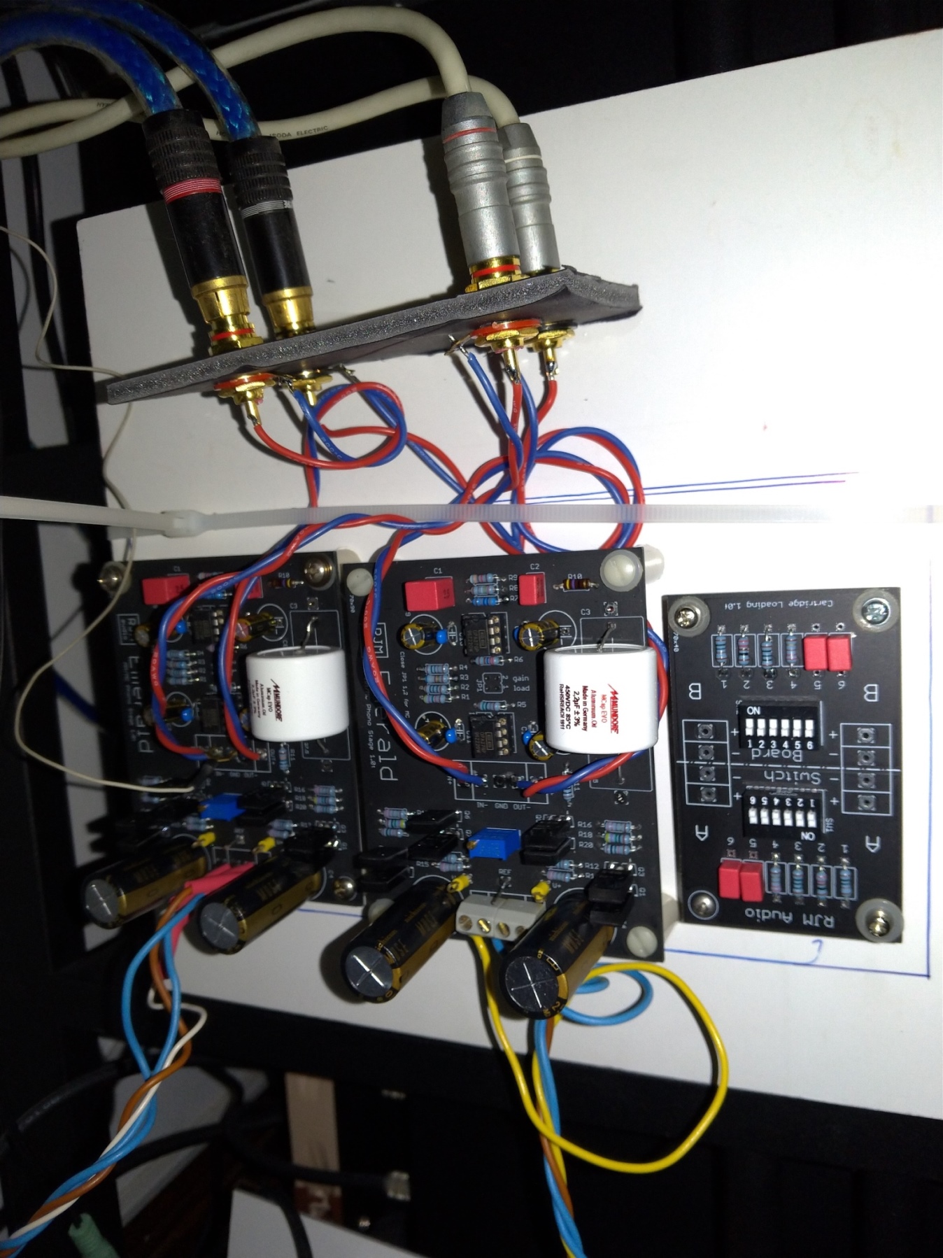

Hello all
After an extended period of time, I managed to finish the first phase of assembling the emerald boards.
They are connected in double mono mode and the switchboard board is currently off to be connected when it is the final assembly in the chosen chassis.
The first connection attempt did not go very well, the place where I put the plate with the assembly is not the most suitable (obviously), there was no sound from one channel or else there was a high-pitched hiss, from the other channel the sound did not have the volume expected ....
Where did I read a post recently regarding symptoms similar to these ???
The most important was the assembly of the plates, now it is to discover the mistake I made somewhere and then the final assembly on the chosen chassis.
Here, too, I had a doubt to solve, a chassis or two? And after having solved myself for two chassis, another question, identical or of different dimensions? I have decided, the chassis of the power supply narrow and deep, the one of the plates wide and less deep.
Now that I have made the first presentation and if you want to make a comment or ask any questions feel free.
Now I have to try to solve the problems of the emerald and the Pass pré BA-3 which now seems to be well on its way (a bad welding discovered by pure chance).
Best regards.
Carlos
