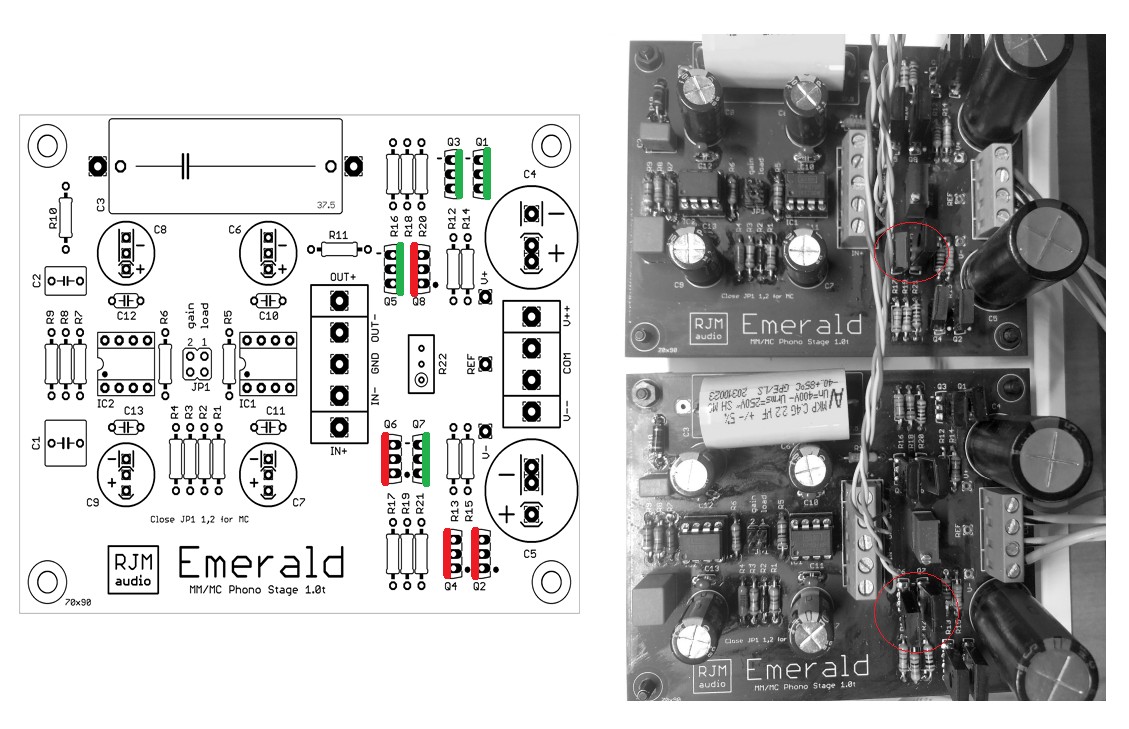

Right, so that tells us the S-reg circuit is not working. Some of the transistors were installed incorrectly, most likely mounted the wrong way around, possibly BD335 swapped for BD336. It's not a fault as both boards are the same, it should be an installation error.
Not that it explains the low gain exactly, but it's a clear place to start.
EDIT: from the photos you posted earlier, it looks like both Q6 and Q7 are flipped 180 degrees.
This diagram may help you to troubleshoot.
Looks to me that while Q5,8 are correct, you have Q6,7 flipped.
You are correct I fixed both 6 and 7 and now I get good voltage measurements on both boards, I should have know not to build both at the same time. You have eagle eye, I looked at that darn thing over and over. getting old I guess.

Pin 1 and 8 are unconnected to anything, don't worry about that.
Pin 7 should be about 13 V, pin 4 should be about -13 V ... those look fine so we can conclude the S-Reg is working properly. Pin 6 of IC1 should be almost zero, and a small offset is expected on IC2, as you have.
So it seems to me the electronics is all on point. Weak bass response could indicate an error in the RIAA circuit (C1, C2, R6-9), error of R1 (smaller than expected) or some problem with the configuration of the output coupling capacitor C3. Let's say R11 and R2 were switched by mistake, so R11 was 100 ohms and R2 (which are aren't using) ends up 100k.
success
Richard, with your eagle eye and your guidance I got it working its sounding pretty darn good now. 100r in R11 instead of 100k stupid mistake, times two.

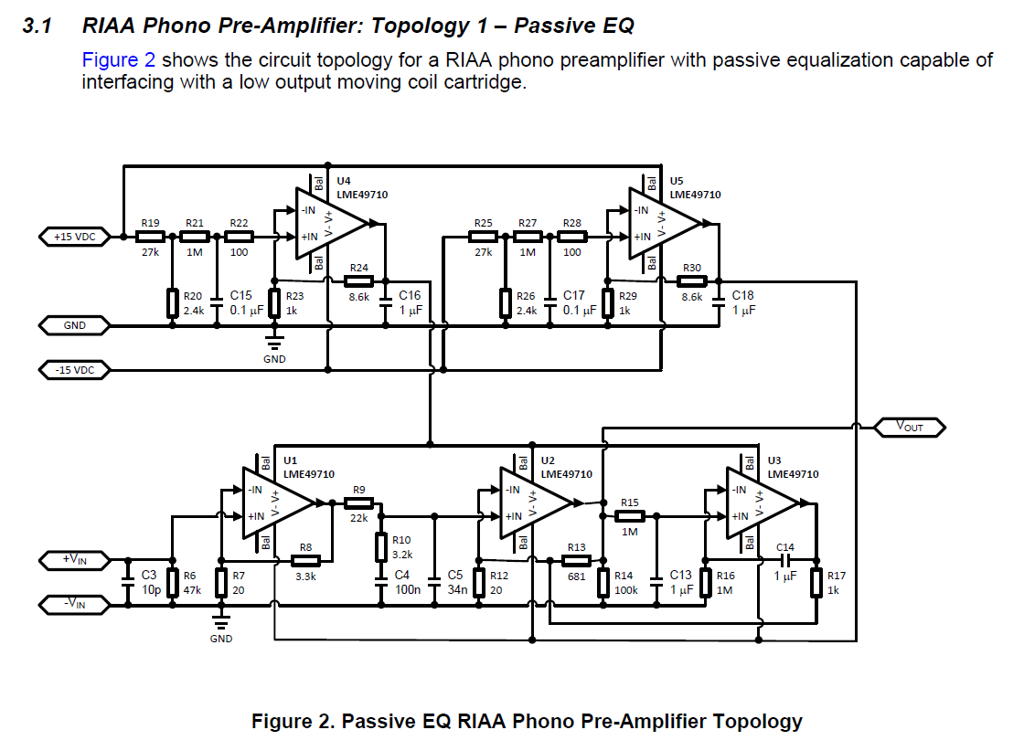

I was trying to design by myself an op-amp based phono stage, reading some TI application notes. Then I found this simple and interesting project which is inspiring me a lot. I was wondering, have you @RJM ever tried to remove C3 using the technique you can see in SNAA046A, page 4 (bottom)?. If I'm not wrong, this servo amp low pass filters the output signal (extracts DC...), then it supplies with this output the inverting input of the last stage, in order to get 0V at the output. Isn't?
The power supply is very similar to the X-reg, then there's a classic passive pre )U1, U2) with a DC servo (U3) on the back to replace the output coupling capacitor.
Of course a coupling capacitor is simpler and more reliable. For me, the capacitor - while you can hear it - doesn't impair the sound so it's not worth the effort to remove.
I got it. I knew it is a different approach amplifier, anyway thank you for your opinion on the decoupling technique .
