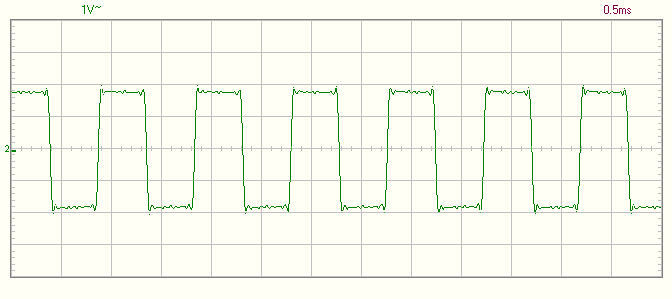

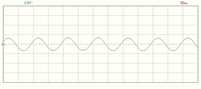

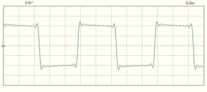

I have measured 100, 1000 and 10000 Hz with the resistive load. I think it looks as expected considering I should be unable to see a square at all at 10Khz. Notice there is some ringing. But as stated earlier this ringing is exactly the same as the ringing when measuring directly in the dac.
8594 is the 100Hz. 8595 is the 1Khz. 8596 is the 10Khz.
The amp was set in UL mode with NFB on while measuring.

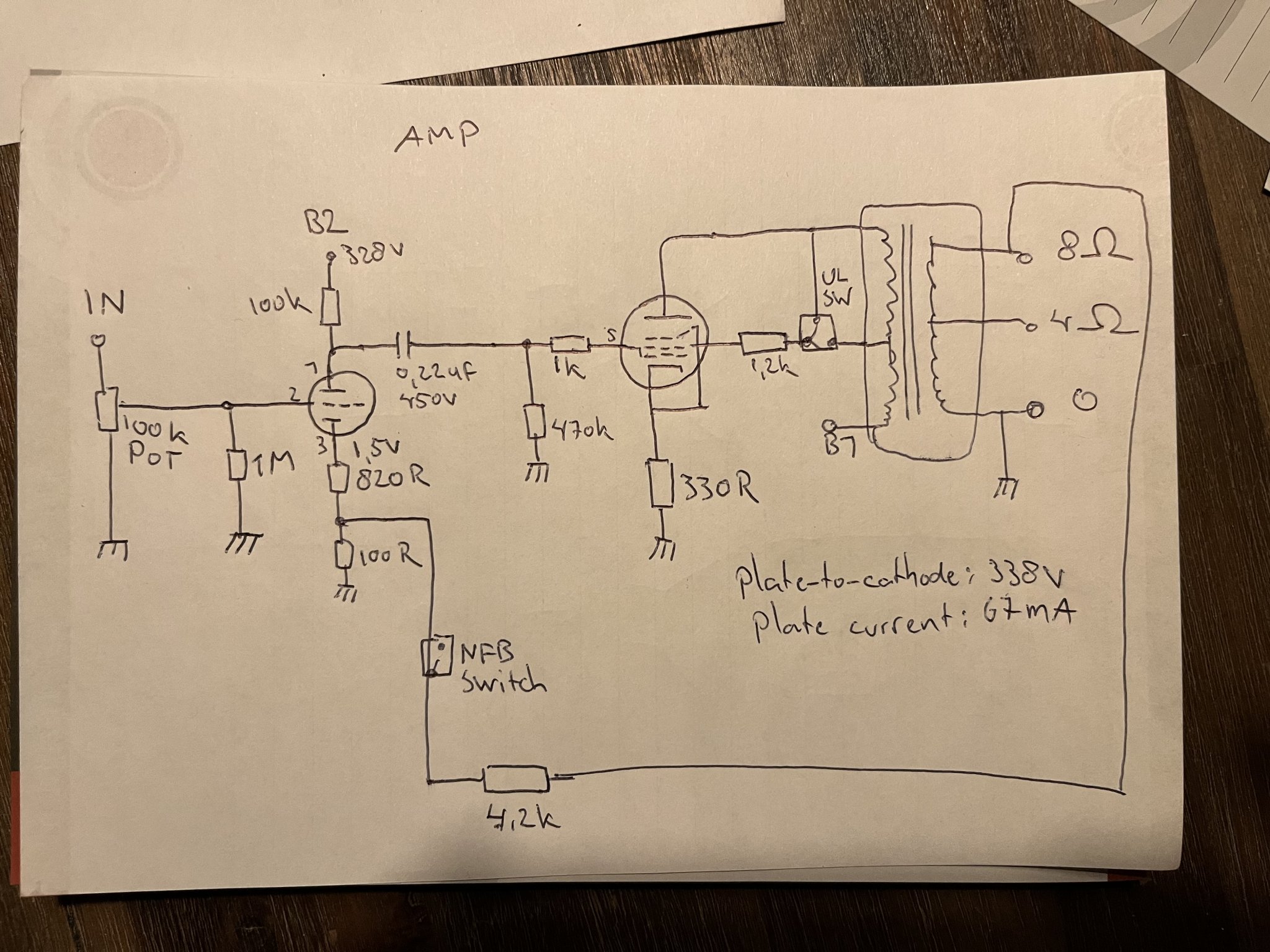

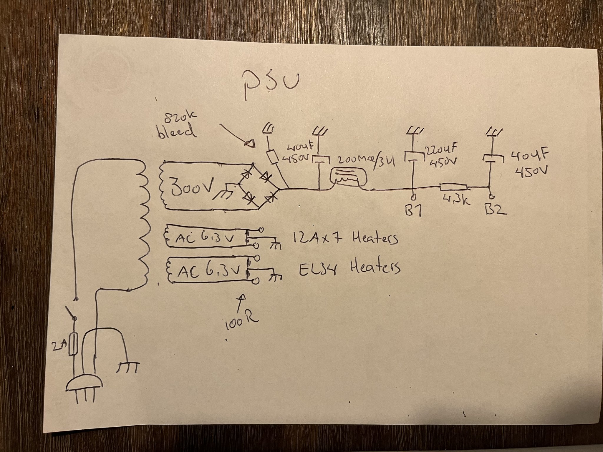

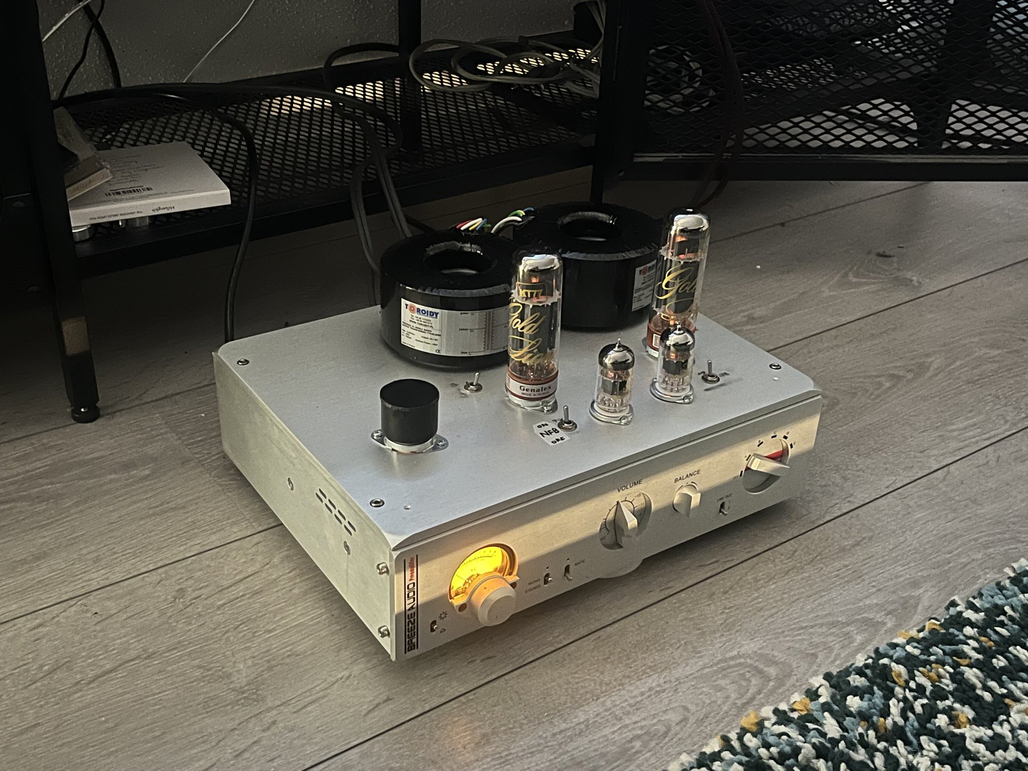

I also made a schematic which should give enough insight. It is. A schematic of the old school paper and pen type, but it should be readable. It is a single ended EL34 with Solid state rectification.
Please note: the amp has the option to take out the SS rectification and out a 5AR4 in it. For ease of drawing I left it out of the picture. I use the SS all the time anyway.
The amp also has a Triode / UL switch and switchable negative feedback going from the 8Ohm tap to the cathode of the 12ax7.

wg_ski,
It is not amplifier overshoot, it is not amplifier instability.

Why is there no bypass capacitor across the EL34 330 Ohm self bias resistor?
Could make things better.

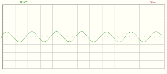

Does your 10kHz square wave from the signal source look like a square wave, or does it look like the 10kHz sine wave from the amplifier output?
Where is the 30kHz 3rd harmonic of the square wave?
What is the model number, and manufacturers of your output transformer?
Is it rated for 67mA in the primary?
What is its rated primary impedance?
To be honest: I like the sound better. I did extensive testing with bypass capacitors of around 470uF. I just notice the sound is less "accurate" and more fatiguing. It just does not resonate on my eardrums in the same way as it does without. Without the capcitor I get the tingling sensation in my ears in the same way I do when I play live with my band. This is especially noticeable with heavier rock types like Punk and Metal. With the capacitor in place the music becomes more mudded / compressed and instrument seperation is not the same as without the capacitor. With the bypass capacitor the sound is more fattened up and has more gain though. I figured this is since the bypass capacitor removes any local feedback.

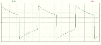

Please see the attached image. This one is taken directly from the DAC output.
As you notice the ringing pattern looks identical. So I dare to say the ringing as seen on the scope comes from the DAC.
I have a Toroidy OPT. It is reted for up to 100mA and the primary impedance is 3.2K Ohm.

I have never understood one of the specifications of the Toroidy output transformers, the large amount of the primary capacitance rating.
Your model's primary rating is 3.2k Ohms.
But its rated primary capacitance is 11.2nF.
The capacitive reactance, Xc = 1/(2 x pi x F x C)
Let F = 30kHz, and C = 11.2nF.
Xc = 474 Ohms at 30kHz.
30kHz is the 3rd harmonic of your 10kHz square wave.
474 Ohms of capacitive reactance is in parallel with 3.2k Ohms, to me, that seems like a severe low pass filter, so the 30kHz harmonic is very rolled off.
If you roll off all the harmonics of a 10kHz square wave, you get . . . a 10kHz sine wave, just like your screen shot.
Xc of 11.2nF = 3.2k Ohms at 4440 Hz, and the primary impedance is 3.2k Ohms. So the -3 dB frequency response is 4440 Hz.

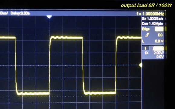

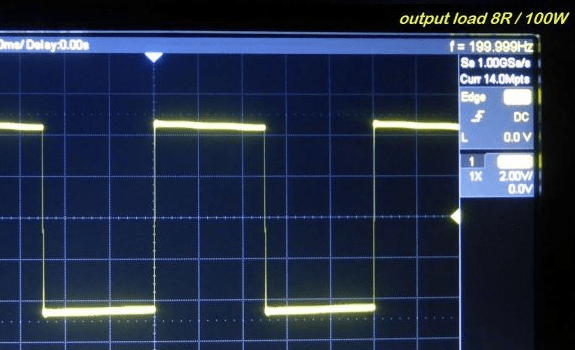

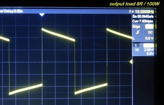

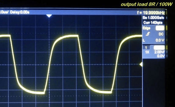

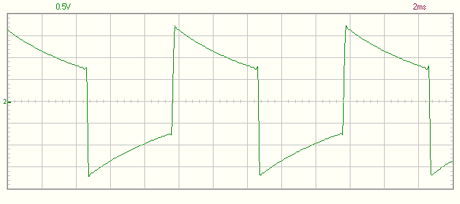

Just for the occasion, here are the waveforms of my U-KT120 single-ended amplifier at 12.5WRMS / 10.00V output / 8R resistive load :
20Hz
200Hz
2kHz
20kHz

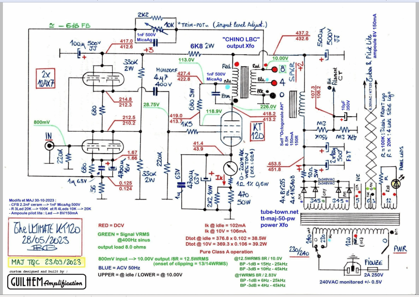

The measured bandwidth @12.5WRMS/8R/10.00V is :
15Hz-25kHz @-1dB
10Hz-45kHz @-3dB
The measured bandwidth @1.0WRMS/8R/2.83V is :
6Hz-25kHz @-1dB
4Hz-45kHz @-3dB
Oscilloscope : SIGLENT SDS-1202-XE
Signal Generator : SIGLENT SDG-810
The matching schematic :

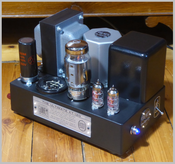

The build (one of the two mono blocks) :
And nonetheless, these amps do sound very fine too... 😉

That looks just like one would expect. Monotonic (not curved) tilt at low frequency, still pretty square at 2k, and rounding at 20 KHz. A little too much ring on the square wave at 2k, one would hope it died out sooner - at least there is no leading edge spike. But you may or may not be able to get to lower (I wouldn’t know till I tried). Unless it’s sampling error from a digital source in that case not generated by the amp anyway.
