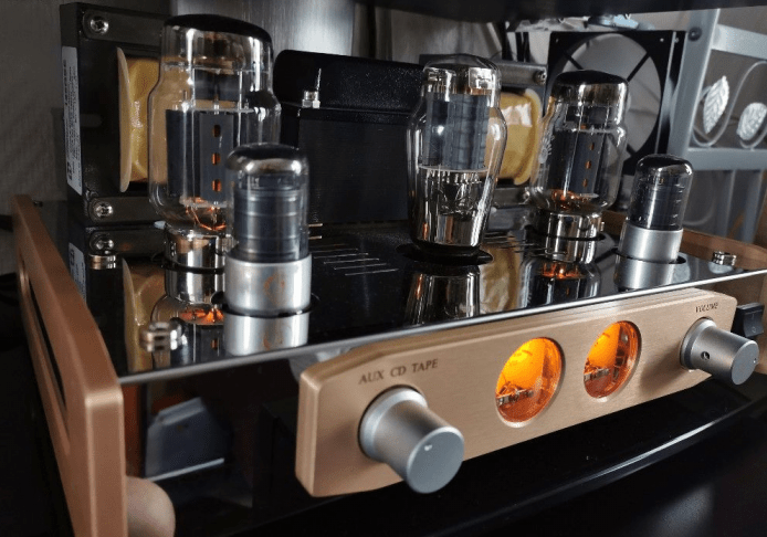

To sum up what I read here my amp seems fine. Unfortunately the DAC has its ringing. To really test what is going on with my amp I would have to invest in a proper signal generator. The wave overshoot we see when connecting to my speakers might be from the speakers is what I read here.
I might also try a Zobel network on my speaker just for the sake of seeing what that would do to the wave function.
One more thing: I want to learn more about amp design and the stuff we talk about here, ideally from a source like a book. Does anyone have suggestions?

Yarach,
Your Post # 23 has a 1kHz square wave, picture #2.
The "ringing" on that is the digital filtering effect inside the signal source electronics.
Your amplifier schematic shows that there is No digital filter in your amplifier.
So, it will not distort a proper accurate 1kHz square wave to look like picture # 2.
EdGr,
I have a test CD. It has a 100Hz square wave.
All my CD players are digitally filtered, so they all show pre-transition ringing, then smaller ringing all the way to the other pre-transition ringing.
Since the CD has a 44.1kHz sample rate, the ringing is at 22.05kHz (yes, as you said, sampling rate/2).
CD players have DACs.
The digital filter(s) in the CD players are before the CD DAC.
CD recorders have ADCs.
A recording device, like a CD recorder, must have an Analog Low Pass Filter before the ADC (Analog to Digital Convertor).
That analog low pass filter cuts off signal frequencies that are higher than the 44.1k/2 rate. It prevents Aliasing of any/all excessively high frequency signal(s) which would fold back into the audible range of frequencies (adding bad sound into the recording).
A single pole 6dB/octave analog filter does not cause any 'ringing'.
Higher order analog filters often cause 'ringing'
The 'ringing' that is being talked to here, is not an oscillation.
Examples:
Many Fires require Fuel, Heat, and Oxygen. Fire!
Many Oscillations require Gain, Phase delay or advance, and feedback. Oscillation!
That is not ringing, that is oscillation.
Amplifiers have gain, phase delay, and feedback. If those numbers are bad, we can have one of two things:
1. An Oscillator instead of an amplifier, once oscillation starts, it never ends, until the power is turned off.
2. What some call "ringing", it is a transient oscillation, it is not continuous. Most often this is referred to as amplifier Instability.
Neither of these two is the same thing as the "ringing" of a digital filter.

This is also my prefered shape of square waves for a single-ended tube amplifier. It is already a very good performance for such kind of amp, very difficult to rival at those frequencies in SE, given that the FB loop is circa 5.5dB only. This usually gives a fatigue-less, deep and crisp sound...
The quality of the output transformer proves to be very fine finally - these are unknown Chino amp production OEM, bought 2nd hand on a craiglist for almost nothing "because it is Chinese", from a Guy who replaced them by Hammond Standard Series 125GSE (see below)...
Effectively, on my schematic, the presence of the 1nF 500V MicaAg capacitors in the FB loop and accross screen and plate taps of the OPT corrects the treble region against a little leading edge spike and attenuates ringing, while maintaining a correct bandwidth though.
And that's true, it's a little flaw from the amp's Chino OPT, which can't be corrected further without a treble bandwidth increased sacrifice, the square waves from my Siglent SDG-810 generator being absolutely perfects.
But honestly, the result could have been much worse ! 😉
