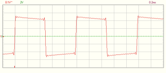

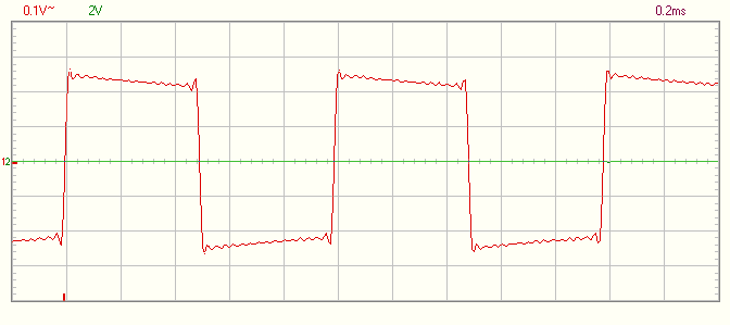

I recently finished building my first EL34 single ende tube amp. I must say it sounds rather good. I dare to say it sounds really good. I have had many amps and speakers and also worked in a hifi store for several years. Last weekend I went to a friend of my friend's father who used to be a professional audio technician for several decades and has worked with several great artist along the way. So if one person knows sound, it must be him. He also builds spuikers for a living.
When I took the amp to his place, he was very impressed with the sound. Ofcourse the low end lacks in comparison with a powerfull solid state, but he very much liked the openess, transparency and detail my amp produced. He also said how easy it is to listen to. Like no listening fatigue at all. Later in that day a friend of him als visited (also audiophile) and confirmed what he heard. He was also very impressed with my amp. My friend (also a musician) was there also and was very impressed by the sound and noted how clean and free of distortion it sounded. He said the music has a lot of body to it and the instrument seperation is stellar. He did not want to stop to listen to it. What had to be a 1 hour demonstration turned to a 3 hour listening session.
The square waves look absolutely awfull on the scope. They are something like the picture below. Note that this is not the actual screenshot of my scope. I have no picture of my own scope and am writing this post from outside of home. But the square wave looks like this across almost all of the frequency range. It is absolutely symmetrical. There is less ringing though in my case.
What the... &*^!!8768?!?!!?
Like how is this even possible? I would expect a ton of ringing and simple bad sound being produced by my amp. It should induce a ton of fatigue and distortion to the sound based on the measurements on my scope, yet it yields very good results while actully listening to it.

Yesterday I wanted to measure my amps distortion and also measure some other things. I was baffled by the results. I attached my prongs to the speaker output posts with a real speaker load.The square waves look absolutely awfull on the scope. They are something like the picture below. Note that this is not the actual screenshot of my scope. I have no picture of my own scope and am writing this post from outside of home. But the square wave looks like this across almost all of the frequency range. It is absolutely symmetrical. There is less ringing though in my case.

I'm not technically versed enough to actually address your theories, but based on my own experience I do have a few thoughts:
1) That square wave isn't actually that bad. I've seen much worse. ;-)
2) A little overshoot on the leading edge is fine, in fact preferable to my ears.
3) Ringing is a different matter and speaks to stability. If your little amp uses feedback you might want to tame the ringing with some tweaks to the compensation network. If your amp sounds good now, it will sound even better if it's stable, especially in the super-sonic frequencies.

If you use a real speaker, then the speaker also generates a signal in reverse, the back EMF I think it is, where damping factor becomes important. Could that be part of the waveform you are seeing in your measurements?
What is the rise-time of the square wave, how many times does the output ring, and what is the frequency of the ringing?The square waves look absolutely awful on the scope.
It matters because real music is not necessarily fast rise-time square waves. Thus real music may not excite any ringing at all. What you may find is that if you use swept sine wave as a test signal then you will probably find that at some high-ish frequency the amplifier gain starts to increase (need to watch the input signal amplitude too in case your signal generator output isn't constant with frequency). As you continue to raise the sine wave frequency at some point a peak output amplitude will be observed. Any further increase in frequency beyond that point should start decreasing in amplitude. (maybe safer to do this a low power)
So, it depends on where the frequency response starts increasing. Is it in the audio band or well above the audio band? Also, how much is the gain increase at the peak?
EDIT: One reason an amplifier might not ring with a resistive load, but show ringing with a speaker load can be because of speaker cable capacitance. Also, since its a tube amp it could be the output transformer that is ringing.
How does it look into a resistive load?
Might be able to tame it with a zobel network across the plate load.

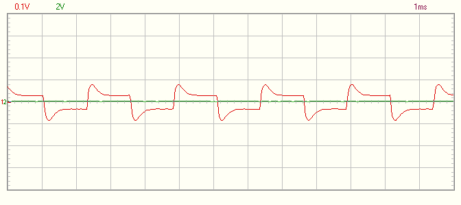

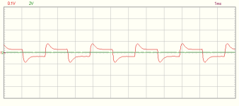

I found some resistors for a resistive load. Did some testing and the results are below. This is a 1000Hz square wave. It is quite different to the wave generated when coupling speakers.How does it look into a resistive load?
Got a schematic of your build?
Switching between negative feedback or not makes absolutely no difference.

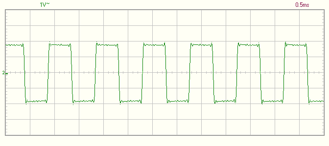

I decided to check the DAC with headphone and line output lying around and decided to use them also. And guess what. The ringing patterns are identical. Only difference being the HF being louder in my amp. So that might be something I might try to fix to get a better balanced tone. Please check my screenshots.
8590 is taken from the amp. 8591 is taken directly from the dac.
Interesting- i figured it was from the speakers. Poorly damped voice coil resonance? Are these some open baffle high-efficiency types?

Lets consider the wave-shape of the 400Hz square wave of Post # 10.
The spectrum of a 400Hz square wave, the amplitudes of the fundamental and all the odd harmonics: is 1 @ 400Hz, 1/3 @ 3x 400Hz = 1200Hz **, 1/5 @ 5x 400Hz = 2000Hz, etc.
That "ring" looks like a half cycle of 1200Hz **. No surprise to me.
A typical 2 way loudspeaker may have a slightly broad high impedance from about 1kHz to 2.5kHz, that is resonant in that frequency range.
Post a schematic, please.
The schematic allows us to analyze the circuit, estimate the damping factor, look at the different negative feedback path(s), which tube will clip first (like driver or output tube), etc.
Post 10 does NOT look like overshoot at all. It looks more like intentional filtering - as in there is something besides a wire in between the actual “amplifier” and speaker. “Overshoot” caused by marginal stability is MUCH shorter in duration, and nowhere near as “rounded”.
wg_ski,
It is not amplifier overshoot, it is not amplifier instability.
I have measured many simple tube amplifiers that look like post #10.
They look essentially perfect on a load resistor, but just like that on a typical 2-way loudspeaker.
Especially amplifiers that do not have global negative feedback, and that have a low to moderate damping factor.
The intentional filtering is in the 2-way loudspeaker might be a simple 6dB/octave crossover at about 1200Hz, as a real good example.
Sometimes, it is a resonance in the bass/mid driver, even if there is no bass/mid crossover.
Your Milage May have Varied.
Just my opinions and experience.
