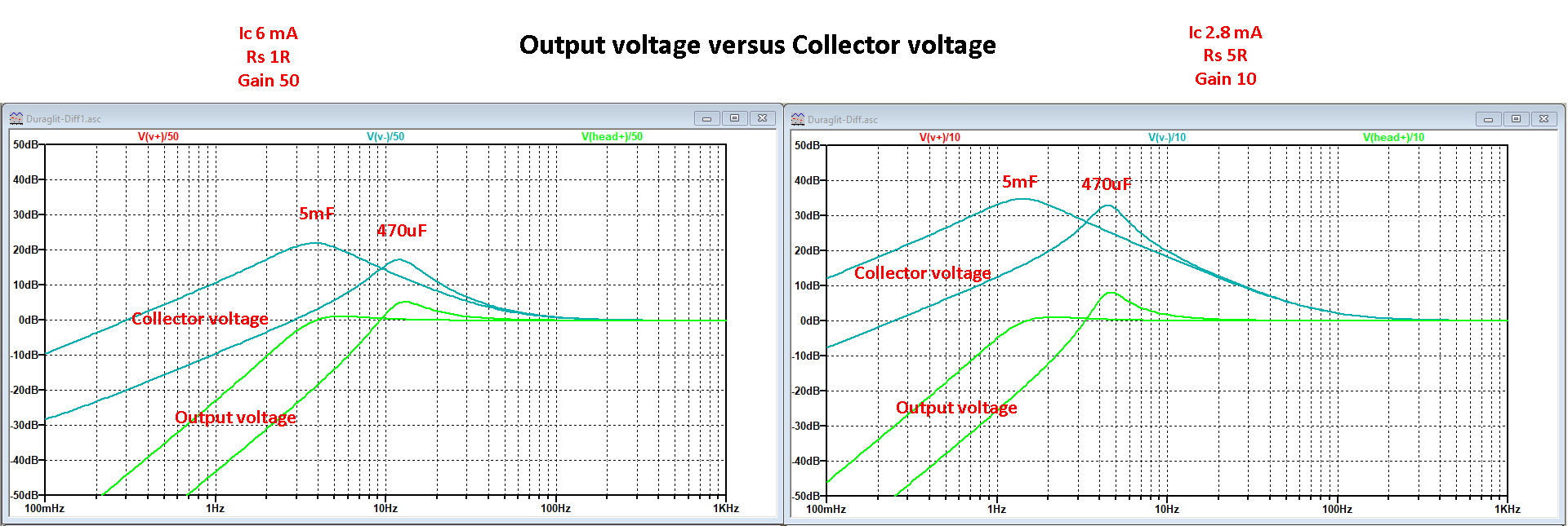

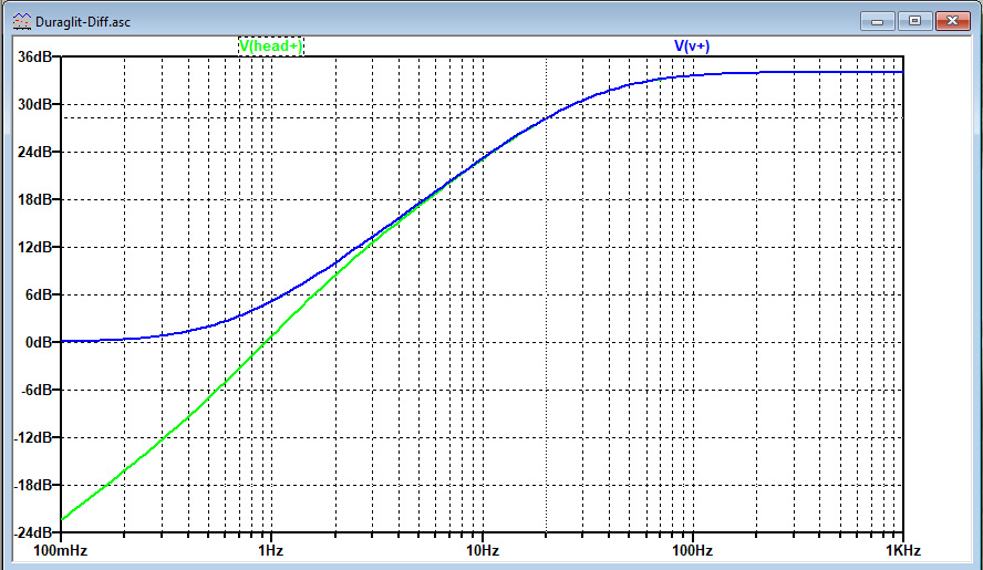

Bonsai,Hans, on the Hawking, if you run your sims but look at the collector voltage of the transistors before the DC blocking caps (with or without dampers) what are you getting? This is with the 10uF capacitors
Is this what you mean, collector voltages are V(V+) and V(V-), lying exactly on top of each other.
Two Sims, one for Rs=5R gain=10 and one for Rs=1R gain=50, both with output cap 10uF, no damping.

Good question about headroom, let's do a worst case calculation, which is for a 0.5mV 5R Cart, see image in #741.
1) Vmax for the collector voltages of the Duraglit is ca. 500mV rms.
2) Looking at the image in #741, collector voltage at 10Hz is 20dB above output voltage, so Vmax rms out @ 10Hz is 50mV.
3) With Riaa premphasis 0.5mV@5cm/sec@Khz drops to ca. 0.05mV@10Hz.
4) A 0.5mV Cart needs a Headamp gain of 20dB to be compatible with the MM input.
5) So Vin@0.05mV@10Hz gives a Vout of 0.5mV with this gain of 20dB
(Vout max)/(Vout@0dB@10Hz) = 50mV/0.5mV resulting in 40dB overload margin.
Where 30dB is regarded to be very good, 40dB is more than excellent and nothing to worry about.
Using 5mF + 10uF will give just one single Caps solution that fits all applications independent of Gain and Rs, whereas using 200uF or even larger output caps with a damping resistor will remove headroom over the complete FR and needs adjustment for each individual Cart / gain combination.
That's why to my opininion the 5mF +10uF solution seems to be the clear winner.

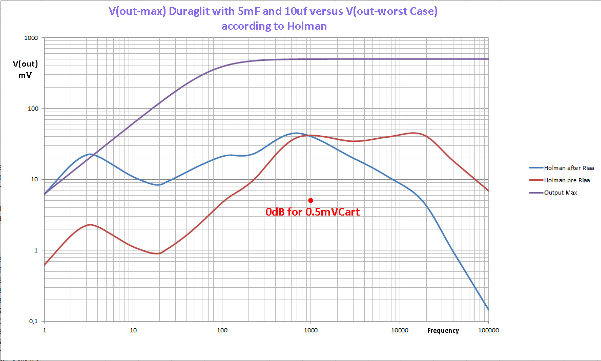

The image below shows the result of copying into Excel the Holman Worst Case Envelope after Riaa (blue) and the corrected pre Riaa curve (Red) for a 5R 0.5mV Cart in combination with a Duraglit set to a gain of 20dB.
At 1kHz and above, V(out-max) for the Duraglit is 500mV eff.
When using the before mentioned 5mF+10uF combination, Collector voltages at LF will be higher as the output voltages, forcing V(out-max) to be quite a bit lower, see image in #741.
Together with both Holman related curves, Duraglit's V(out-max) is now shown in the image in purple.
As can be seen, the purple curve lies way above the maximum pre Riaa Holman envelope in red.
There is absolutely no danger for clipping or overloading.
I have taken this 5R 0.5mV Cart at a gain of 20dB, because here the worst conditions are met in the LF reduction of the output voltage.
Even a 1R 0.1mV Cart with Gain 50 running at a collector current of 6 or 12mA, will be less demanding.
Hans

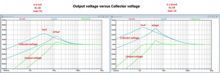

When setting the base capacitors to 100µF and the output capacitors to 470µF or bigger, there will be no gain increase at verx low frequencies nor will be there a headroom decrease as the collector voltages are not higher than the output anymore. Thus the 500 mV max signal level for Duraglit will be maintained over the entire frequency range.
And this values are an almost 'one size fits all' as this behaviour remains almost unchabnged over a wide Rs input range and over a wide gain range.
View attachment Hawking_AB Gain curves.pdf
View attachment Hawking_AB.pdf
For a gain of 20dB with a 5R cart or larger, you are right.
But look what happens when using a 1R 0.1mV Cart needing a gain of 50.
At 20Hz, FR is -6dB down, unacceptable and out of the question.
So this seems not to be the "one size fits all" solution like the 5mF+10uF.
Hans
P.S. This is for Ic=12ma. When using Ic=6mA FR is -3dB@20Hz and largely dependent on the Hfe of the transistors.
