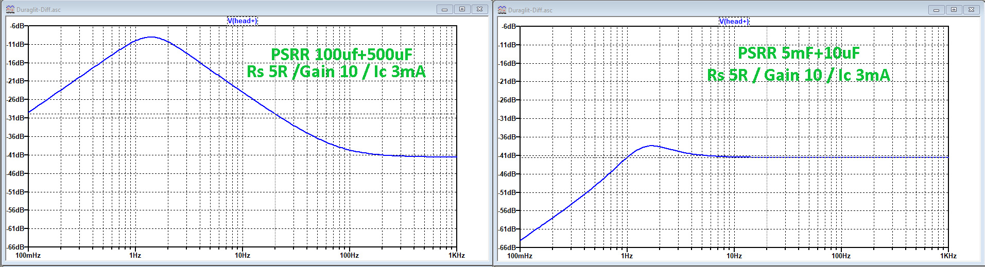

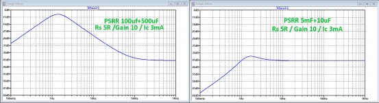

I tend to agree with your arguments concerning the power supply noise, but for a lower gain like 20dB, I would prefer a higher PSRR than zero,
That's why for the sake of completeness I have attached an Image showing the PSRR for the version with 100uF+500uF and for 5mF+10uf.
Results speak for themselves.
Hans
Hans,
the PSRR of the 'Duraglit' like amps is not bad. I investigated this only at 1kHz and found also values in the 40+ dB range.
+1 for your suggestion to use the large caps at the base as this obviously significantly improves the PSRR for low frequencies and brings it to 40+dB over the entire frequency range.
