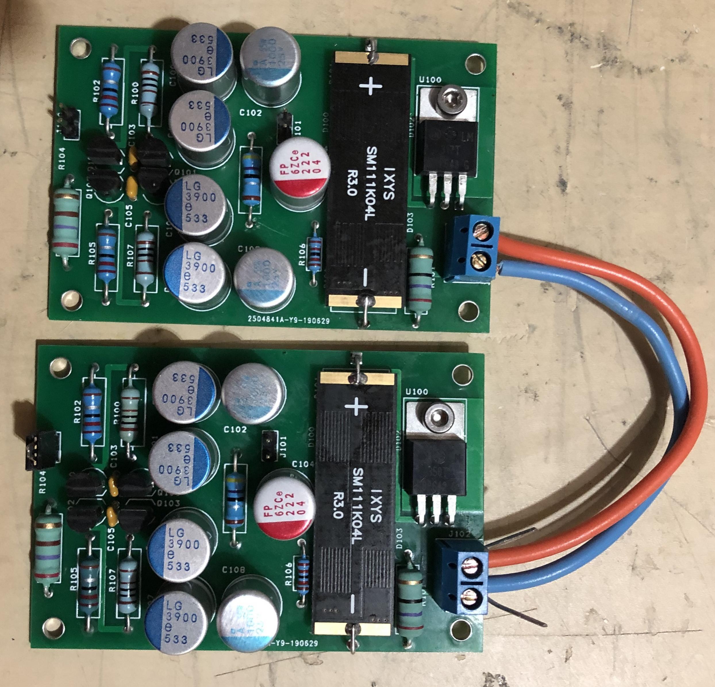

I urge you to make up a Duraglit each and use it.
What would you think, I already did (no case and raw power supply yet). Short of some hum (normal, since there is no shielding at all) sounds as good as anything else I have, as usual I can't tell any difference.
Attached is a photo, takes 50mA @100mA both channels for the solar cells, for my Benz Micro Gold MC (12ohm 0.4mV) the optimum current is lower, @1mA. Noise is 0.44nV/rtHz flat, input shorted. Feeding the output in an Anthem AVM20 MM input.
I am happy to report that the MC did not care about feeding a virtual ground, FR is just fine (I have a test LP for that). This is one precious lesson learned from this exercise, not sure if it's worth finalizing this project, since I already have enough idle HPS series preamps, don't need another one.

With great respect for the short time it took you to built such a neat looking Duraglit with fully isolated remote PSU, it’s also nice to hear that sonically the virtual ground topology seemed not to pose any drawback.
So no signs of “muddy sound” but in line with most other positive virt gnd experiences that were reported.
Thank you for sharing.
