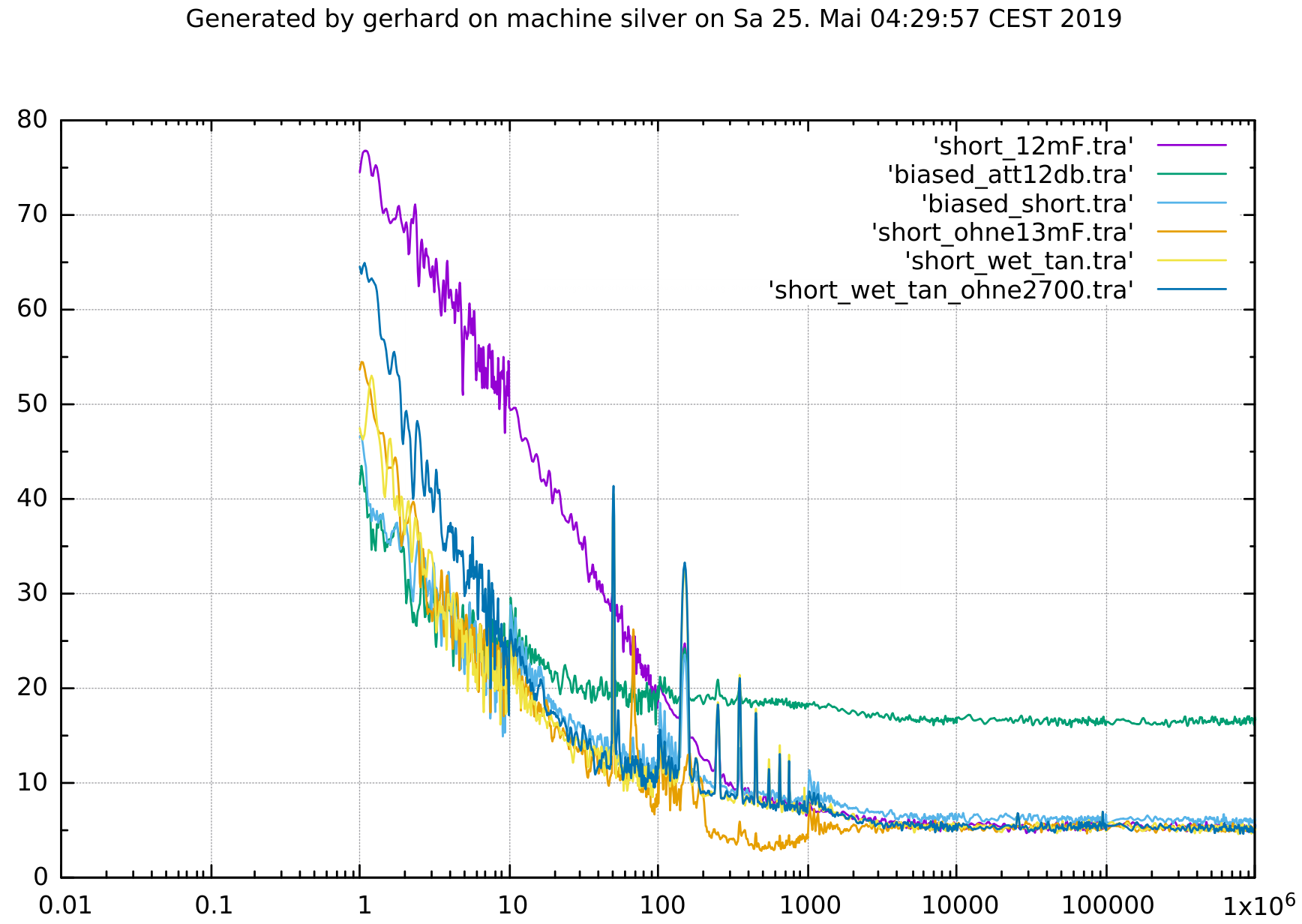

Be careful with these Poly Alu electrolytics.
I gave up on feedback for my wideband lo noise amplifier because I could not get
1 or 2 MHz BW without negative input impedance which I find unacceptable for
a lab tool. Yes, damping everything to death works, but then the BW is gone.
I wanted really high input impedance, so I grounded the gate via 10 to 100 Meg with
an analog switch to decrease that, if the operating point is out of bounds.
Gain with a FET goes with rt(Id) and over a range of 30°C the change was not acceptable.
I enforced the source current to 27 mA with a CCS made from a FZT851 mirror.
That's not too much current for 2 IF3601. To keep the source at AC GND, I used
Poly alu 4700uF / 2V5 * others for RF. DigiKey 493-4582-1-ND
2V5 should be OK for +500mV for Vgs. Did I think.
That resulted in the purple function in the picture. 30 dB/decade from 300 Hz downward.
Low cost normal ALUs 3300u/10V healed that. Wet slug tantalum was not better.
There is still 0.8dB/10K gain change in simulation. Attributable only to the FET.
I'll heat it to constant 35°C.

There is probably no problem with the DigiKey 493-4582-1-ND Poly Alus in a
low impedance environment, such as filtering a LiPo battery, but when used to keep
the output of a dc current source at AC 0V, every charge packet that defects through
the cap produces telegraph noise. (is telegraph 1/f**3 ?)
I'm not interested in circuits here, it's just that el Cheapo 1189-1056-ND 3300u/10V
ordinay alu electrolytic does not produce that effect.
I got some mechanically larger caps in the mean time that cost more but are promised
to survive longer at 105°/125°C (still 12.5mm dia). The results are still out.
I have used them in the second channel of the cross correlation machine; if they
perform there, the first channel will be updated.
One could also try 10V organic, but I'm seeing signs of operator exhaustion.
There is always so much one could test additionally.
This would be strange, since telegraph noise (aka popcorn noise) is normally associated with micro defects in semiconductors and/or heavy metal contamination, being therefore strongly process dependent. Not much to do with the electrolytic capacitors physics. Typically, popcorn noise doesn't have a Gaussian distribution, but a trimodal distribution inherited from 1/f and Johnson noise, shifted by the popcorn noise. The power spectral density of the popcorn noise is ~1/f^a where a=1...2, usually closer to 1/f^2, definitely not 1/f^3. It is fair to say that modern semiconductor manufacturing processes made the popcorn noise largely a non issue.
If you look into datasheets for electrolytics/organics the specified the specified ESR can be very low for the organics but leakage current is at least 10-fold higher than for ordinary (low leakage) alu electrolytics.
Leakage currents are currents due to random defects in the microscopic thin alu-oxide layer. These then are healing again (by oxidation) by the flowing current. Beeing random in nature, this must result in noise currents. These processes are typically low frequency and thus should follow some 1/f***x function with x beeing highly dependant on technology and manufacturing conditions.
Same happens in Tantals and that's what Richard already reported in his original article as 'crackling' noise.
Not typically. I have observed GR noise at frequencies as low as .01Hz with its region of 1/f**2 which returned to 1/f behavior at .000011Hz (and yes I measured it).

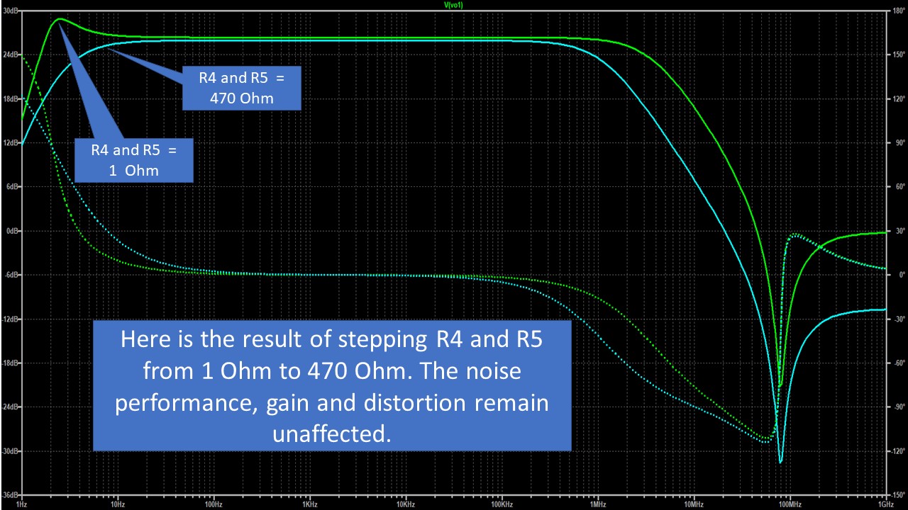

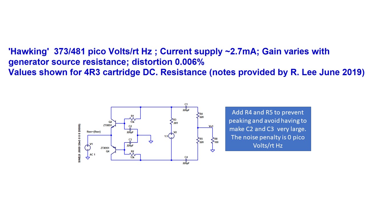

You do not need very large capacitors from the bases of the transistors to ground in Richards Duraglit. The cure is to insert 2 damper resistors in series with the output caps as shown below. Values of between 220 and 470 Ohms do the job.
There is no impact on the noise performance.
For some reason, I used 22uF output caps all the time, instead of the 220uF as you have used.You do not need very large capacitors from the bases of the transistors to ground in Richards Duraglit. The cure is to insert 2 damper resistors in series with the output caps as shown below. Values of between 220 and 470 Ohms do the job.
This changes the behaviour a bit.
But inserting 2* 220R into the output line, doesn't makes things better in the example I gave yesterday, on the contrary.
You will still need large caps for the other 2.
Hans
Here are the plots for R4 and R5 at 470 Ohm. As you say, even with 220uF capacitors in the transistor bases you still have the sub-sonic bump, but this trick avoids that you have to use very large (>> 1000uF) caps in the bases with no penalty to get rid of the bump.
Did you use the exact values as in the circuit diagram of #712
and what value for Rs did you use ?
Hans
