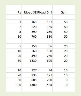

is my understanding of your setup correct for
as Duraglit gain is roughly Rload/Rsource, did you changed Rload accordingly to sweep Rsoure to maintain a constant gain e.g. 50x ?
If this is the case then e.g. single ended 50x gain at 1 R source had a Rload of approx 50 R while for a 10 R cart it has been set to 500 R. Then a huge H2 distortion of up to 40 dB higher for SE vs. Diff is well explainable as the current drive requirements for the 1R, x50 case would be 2.8 mA pp at a bias of 6.25 mA.

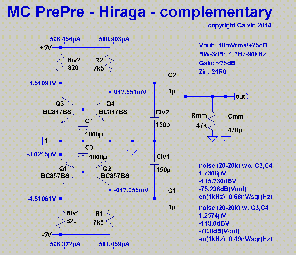

there is still one circuit missing: the Jean Hiraga 'Le pre pre' (if you google, you easily will find the original circuit). It's sindle ended similar to the simple Maxwell circuit but uses a current mirror and dual suppply to make the input DC voltage free (avoiding the huge input cap required otherwise).
My guess is, that an additional capacitor from the bases to ground will improve noise significantly.
ok - I will add it - probably not this week though. Did you see the Douglas Self design MC amp results ('Fermi')?
Hiraga - is it this one?
DIY Audio Projects Forum • Hiraga MC pre-preamp

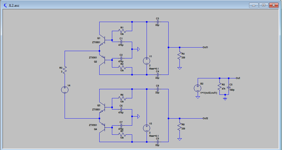

Here it is,Hans, please post a circuit of your Differential Duraglit.
Hans
Common ground is now at the emitters for in and output! (this is what defines a 'common emitter' topology)
Common node of input signal and output signal is still on the bases, no matter where you will place GND symbol
I have no Idea what you mean.No, absolutely not
You forgot that the output voltage is not referenced to GND any more
The 47K and 150pF are the input of the following MM stage, where one side is connected to Gnd, you cannot simply take that away.
And the Cart is also connected to Gnd with one end, so ???
Put your model in LTSpice and see what it does.

I did not sweep, but used discrete values where for each Rs a new Rload had to be found to give exactly the right gain.Hans,

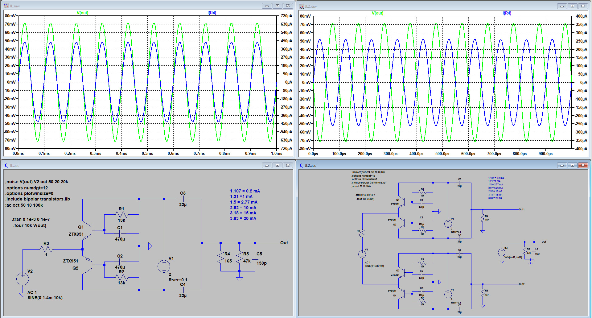

See below a number of values used for Rs, Rload SE and Rload Diff.
I have also attached an image for Rs = 1R with a Gain of 50 for SE and Diff.
In case of the SE 428 uA pk is needed to drive R4 and for the Diff version 258 uA pk
So no way near the 2.8mA you expected.
Hans
P.S. The largest difference in THD of 91.7 between SE and Diff happened with Rs = 100 and a gain of 10
You are right - I simply forgot the input impedance of approx. 2 R when running the transistors at 6.25mA.
Theerfore you need the 165 R output resistor to get the 50x gain and not 50R.
Then the current drive requirement drops as well.
Yes, this is it. It got some cult status in certain audiophile circles.
As far as I know, this was also developed in the 80s a little bit later than the Leach/Lee common base complementary circuits.
And yes, have seen the 'Fermi'. Good but can be bettered (noise, overall distortion and current consumption) with less complexity.

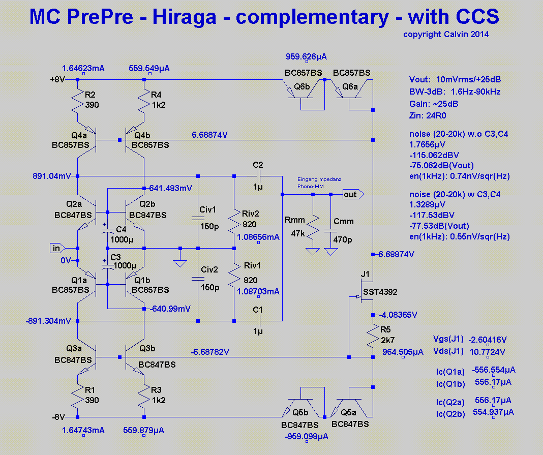

Yes, I played with it a bit today and it can be improved.
A lot of these simple circuits I noted do not have Ic optimized for lowest noise - I suspect with some tweaking a few tens of pico Volts/rt Hz reduction is possible.

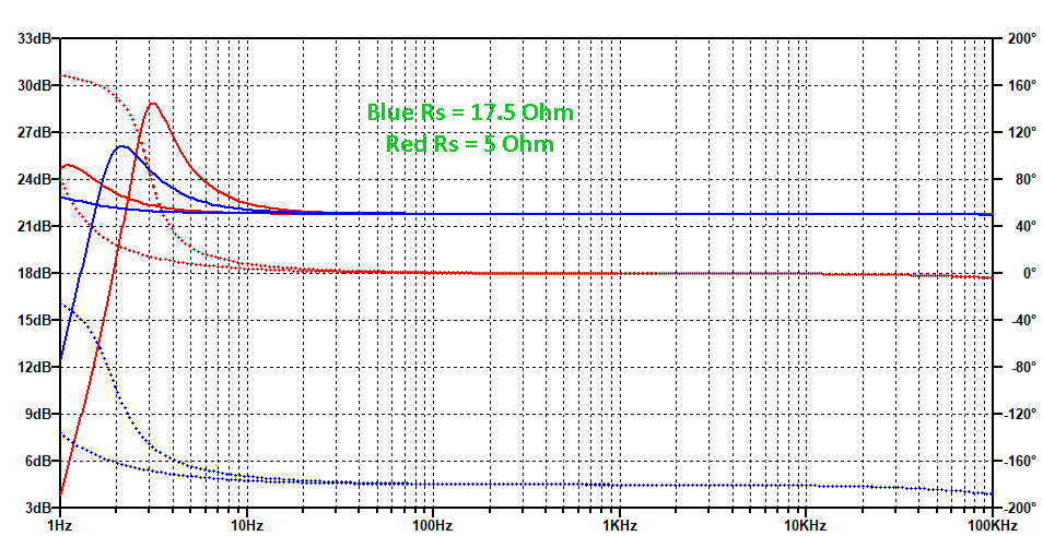

So far I examined Richard's Duraglit mainly on noise, collector current and Rs.
Now I looked at the FR and noticed that depending on Rs and collector current, there can be a nasty bump below 10Hz when using 470uF caps.
The lower Rs, the larger the bump.
With Rs = 5 Ohm, it can already be as much as 7 dB, getting even larger for lower values.
The remedy is to alter these caps into at least 5mF as can be seen in the image below where 0.5mF and 5mF are both used for Rs=5R and Rs=17.5R
Hans
Hans
I think Richard recognized this, the peaks can end up at record warp frequencies, very bad.
