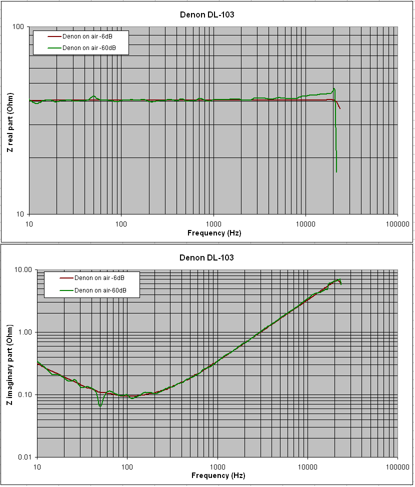

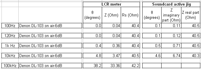

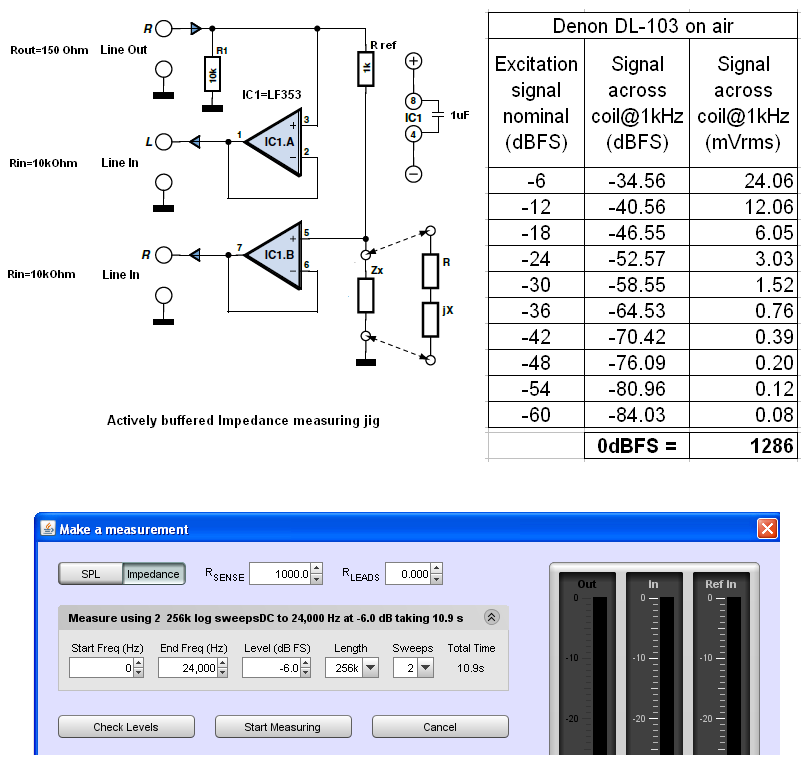

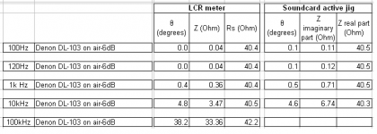

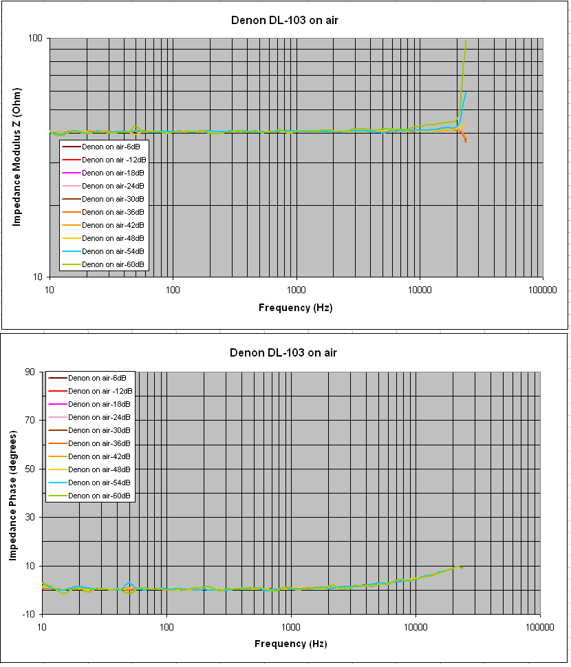

Guru Wurcer, where did you get DL103 at 12R? I've got 40R from my Jurassic notes. Spectral pics in my original document.
syn08. Yes. I did ASSume Duraglit would behave like a common or garden common base. Too good stuff to digest, ponder & reply in a short post.

DL-103 did have a coil R change at some point in its 50 year life.

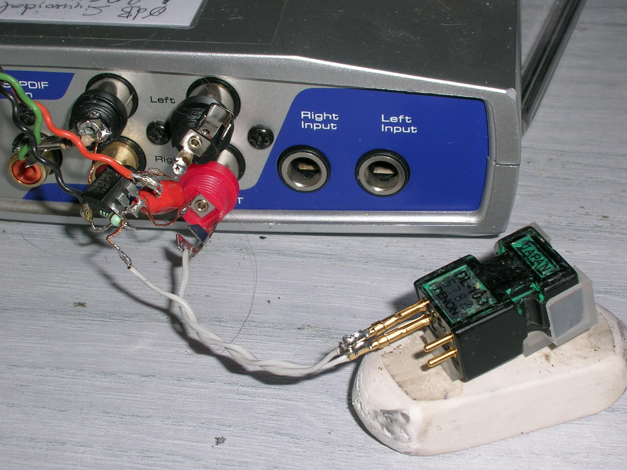

Hans: After years of working with RF systems I still get thrown by the whole 20log thing in audio!
On the load used to measure cartridge sensitivity front I have so far drawn a blank. There must be a DIN or other specification but not found it. Ortofon used 100 or 200 ohms but don't say what the cross over point is for changing. I assume 100 for all their low output models which are 3- 6Ohms. Will keep looking. May have to invoke George on this.

Can you confirm that your LTspice sims showed SNR for this 14R source, peaked at 12mA for a Duraglit with a single ZTX851/951 pair?I mentioned that for my 14 Ohm example 12mA was a minimum at least in LTSpice. More current and SNR degraded.
What rbb' & load did you assume?
I had bought mine around 2010.
It was a 40 Ohm
George
