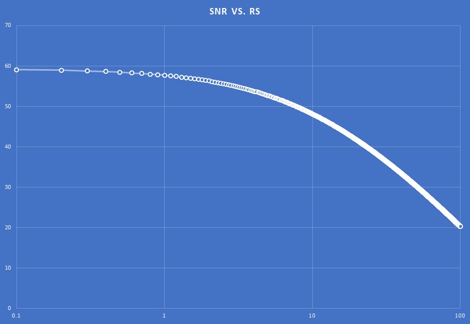

How does the S/N behave if Ic is constant - this is the most practical scenario. I assume it will also peak at say 1mA but then drop off more rapidly as Rcart decreases and increases about the 1 mA level ( or whatever is selected).
Yes - I meant to say Rcart is the independent variable. I think fixing Ic like this is probably the more usual case unless you are expecting to deal only with ultra low Rcart. But, it also seems with this topology Ic is best up in the 10 mA range.
I posted the wrong chart and then deleted the whole post.
If Rs is variable and Ic is constant then 1/2gm the collector current noise contribution is constant, the input impedance is constant, so the input divider divides both the signal and the noise by the same ratio given by the variable Rs. Therefore, for large Rs, the SNR decreases, since the signal is constant and the Rs noise increases as SQRT(Rs). No optimum in this case.
To me it was a surprise that the SNR is optimum at such low collector currents. But then I have no idea what is the best metric for a MC cartridge + head amp, the total noise, or the SNR. That's because when the stylus hits the vinyl, the SNR of the MC cartridge + head amp is much better than the vinyl anyway, even if it's not optimized. OTOH, for the idle TT, it is the total noise that matters, to avoid the idle hiss. So it could very well be that this Ic optimum is a result of academic relevance only.
And yes, I was always wondering if the "optimum load" in the MC cartridge pamphlet has any relevance and what would be the side effects of going much lower than the recommendation. Hence my question about reading the MC cartridge almost in short (lower input impedance compared to Rs).
Attached is a plot of SNR[dB] vs. Ic[mA] for Rs=12ohm Vs=0.4mV and Rbb=0. Note the Ic horizontal log scale. The optimum Ic goes down when Rbb is considered.

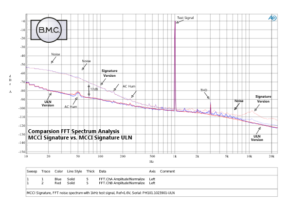

The manufacturers factsheet tells that there is global feedback, so read Stereophiles report with suspicion.
Hans
I dont know where you got the manufactureres factsheet from but on the BMC homepage, the key features of the circuit are desribed as
1. symmetrical current input
2. BJT common base topology
3. feedback free circuit
4. fully balanced circuit
5. symmetrical single ended class A output stage
6. fully passive RIAA eq between stages
The input circuit is furthermore described as a DC balanced symmetrical design where the cartridge current is injected leading to a current shift which is converted into an output voltage. So it looks like a circuit very similar to the ones discussed in this thread but symmetrical and balanced.
The unweighted noise measurements are somehow reasonable (manufacturers values match the sterophile measurements) but the difference of 30 dB+ when A-weighting can only mean that there is a huge 1/f noise component at low frequencies.

The explanation is in the same post. No, the reason is that the Rs noise (the X axis variable) increases, everything else, including Ic shot noise, is constant. It is perfectly intuitive.
"If Rs is variable and Ic is constant then 1/2gm the collector current noise contribution is constant, the input impedance is constant, so the input divider divides both the signal and the noise by the same ratio given by the variable Rs. Therefore, for large Rs, the SNR decreases, since the signal is constant and the Rs noise increases as SQRT(Rs). No optimum in this case."

Thanks for making me aware of these facts, I obviously had an old factsheet.I dont know where you got the manufactureres factsheet from but on the BMC homepage, the key features of the circuit are desribed as
Looking at their website now with the most recent info, I see:
Amplifier Circuit
1. Balanced Current Injection input.
2. Common base circuit for highest bandwidth.
3. "Automatic" gain adjustment.
4. Feedback-free circuit with very short signal path.
So you are right, a common base circuit sounds like the Leach / Lee topology.
I'm intrigued by their "automatic" gain adjust.
There is also a picture of the amps noise production, see below, just following the Riaa curve as expected, nothing special.
No sign of "huge 1/f components".
The large spread between both channels in SNR of resp 83.2dB and 71.8dB SNR is already quite strange, but 100dB-A after A-weighting is out of the question.

Thank you for sharing all this info.I posted the wrong chart and then deleted the whole post.

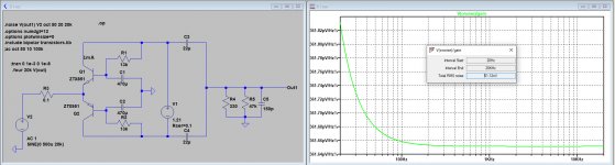

Since you refer to 1/2gm, I suppose you went back to the complementary Lee version and that you are still working with a 0.4mV Cart signal.
What is not mentioned is what collector current you used, 1mA or 0.2mA ?
With a 1mA collector current and Rs=0.1 Ohm, LTSpice gives a SNR of 75dB and with 0.2mA a SNR of 72dB.
However, your image is showing ca. 58dB for Rs =0.1 Ohm.
Am I missing something ?
Hans

You probably don’t; as the collector current increases, the collector current shot noise increases. However, the RTI voltage noise contribution of the collector current shot noise decreases. 1/2gm is the RTI equivalent resistance noise contribution of the collector shot noise current.
For Hans, no, the 1/2gm equivalent input noise resistance is not for the complementary version. Calculate the collector shot noise current multiplied by the input impedance and convert to an equivalent resistance, you’ll get the 1/2gm.

Hans, are you sure you simulated at Vs=0.4mV? I get from calculation SNR 74dB at Vs=1mV, Rs=0.1ohm, Ic=1mA, so this covers the delta to your simulation almost exactly if you used Vs=1mV. SNR always depends on the input signal level, that's yet another reason why it is not my favorite noise metric.

It is even 3dB better, because I simulated with a differential version, sorry for that.Hans, are you sure you simulated at Vs=0.4mV? I get from calculation SNR 74dB at Vs=1mV, Rs=0.1ohm, Ic=1mA, so this covers the delta to your simulation almost exactly if you used Vs=1mV. SNR always depends on the input signal level, that's yet another reason why it is not my favorite noise metric.
Now having switched back to a SE version I have again adjusted Ic=1mA by lowering the battery voltage to 1.21 Volt.
Noise as you can see is 51.12nV with 0.1 Ohm source, so SNR is 20*log(0.4mV/51,12nV) = 78dB.
For a 1mV input signal SNR would even have been 86dB.
And yes, the Rb's for the two ZTX devices are properly adjusted to resp. 1.5 and 1.2 Ohm.
Hans
Hans, that's for the symmetrical complementary version, calculations are for only half of that.
But in general, I have no idea what you are doing there and where is the discrepancy (if any) is coming from. Since simulation is so much easier, I am sure you could easily figure it out. SNR is by definition the ratio of signal and noise powers at the output, BTW.
