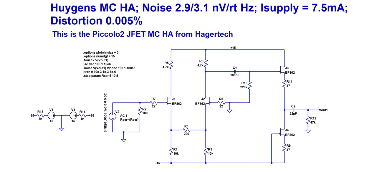

Even more universal as the graph in #502, Richard Lee's Ultra low Noise MC Head Amp
Here a general formula to calculate the S/N after Riaa and after A-weighting for a MC Head Amp.
This is without taking the mostly very low contribution of current noise into account.
S/N = 20*log[17.7e3*(Vcart/(Sqrt(RTI^2+Rs/60)]
Vcart the output in mV @5cm/sec/1KHz,
RTI the Amps equivalent input noise in nV/rtHz without Cart
Rs the Carts source resistance in Ohm.
As an example with ABOOS cart, 35R /0.2mV with Richards 0.28nV/rtHz amp, gives 20*log(17.7e3*(0.2/(sqrt(0.28^2+35/60)] = 72.77 dB-A.

Interesting formula, any idea about how it is derived? The term Rs/60 looks rather strange.

Adding noise is by taking the sqrt of the sum of the squares.Interesting formula, any idea about how it is derived? The term Rs/60 looks rather strange.
Since a resistor produces sqrt(R/60)nV/rtHz, the square of it is R/60.

This has an interesting consequence... If you increase the collector current (into the mA range) in a common base stage (to lower the noise, RTI goes with SQRT(1/2gm)), the gain also decreases (since the input impedance goes with 1/gm). So the S/N decreases ~1/SQRT(gm) or ~1/SQRT(Ic).
So increasing the collector current (in the mA range) actually lowers the overall S/N...
At very low collector current (gm is small) increasing the collector current (in the uA range) actually increases the S/N since the gain is not affected, but the noise decreases.
Between these two extremes, there could be an optimum Ic for each cartridge Rs, to maximize the S/N. Perhaps this is what Richard was thinking when talking about "noise matching", and we assumed he was talking about maximum power transfer (that doesn't apply to audio).
I need to do more algebra...
I mentioned that for my 14 Ohm example 12mA was a minimum at least in LTSpice. More current and SNR degraded.
I'm not seeing anything interesting. A couple of things that can confuse the issue, the self biasing resistors are in parallel with the load (and also beta dependent) so when you increase the bias current eventually the gain will suffer by simple attenuation at the output. The SNR seems monotonic with Ic for different Rs.
SNR does not depend on the gain, since both the noise (Rs +Rb + 1/2gm equivalent noise) and the signal (past the Rs-Zin divider) are equally amplified. The bias resistor is much larger than the load, anyway. Once again, I am looking at the basic common base, no complementary stuff.
