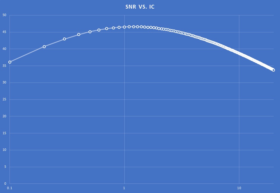

Done. Assuming Rbb=0 (which may not be true) the maximum SNR is exactly where gm*Rs=1 so (surprise, surprise) Richard was exactly right, the maximum SNR is where Rs=1/gm. Otherwise said, the maximum power transfer condition coincides exactly with the maximum SNR condition. That's very specific to the common base stage, no generalization possible as far as I can tell.
I've built a spreadsheet, the maximum is very flat though, no fine optimization is required. For a 12ohm MC cartridge I get the maximum SNR anywhere between 1mA and 3mA, SNR variation across is about 0.5dB.
I'll do the same, considering Rbb this time. Rbb noise is fully amplified by the gain stage, no input divider like for the Rs noise.
Once again, all this holds for the sigle transistor common base, no complementary stuff yet.
Whew, this was rather ugly. No closed for solution, since the SNR optimum is the root of a 3rd degree polynomial. Here's a couple of examples to see the Rbb effect on the optimum Ic
Rs=12ohm
Vs=0.4mV
Rbb=0ohm
Ic=1.2mA
Rs=12ohm
Vs=0.4mV
Rbb=2ohm
Ic=1mA
Rs=12ohm
Vs=0.4mV
Rbb=4ohm
Ic=0.9mA
SNR varies with 1.6dB
Rs=5ohm
Vs=0.4mV
Rbb=0ohm
Ic=2.9mA
Rs=5ohm
Vs=0.4mV
Rbb=2ohm
Ic=2.2mA
Rs=5ohm
Vs=0.4mV
Rbb=4ohm
Ic=1.8mA
SNR varies with 3.2dB
So for MC cartridges with very low impedance (here, 5ohm) the SNR optimum is relevant and of course Rbb has a significant effect.
For MC cartridges with higher impedance (12ohm, this is my current Benz Micro Gold low output) the optimum is rather flat and (as expected) the Rbb doesn't matter much.
Very happy I got a new tool to optimize the bias of these common base virtual ground head amps 😀.

Very large differences in SNR, and that's to be expected. The input signal and the Rs noise are divided by the voltage divider of Rs and the (low) input impedance of the common base. At the same time, the noise is not, so the SNR in my case is much lower (up to 30dB lower), and this is to be expected. This divider is why I said this optimum exists only for the very low input impedance of the common base (essentially 1/gm).
I've mentioned a few posts up why a gm optimum exists.
For the easy no Rbb case
Psig=G^2*Vs^2/(1+gm*Rs)^2
Pnoise=G^2*4KT*Rs*(1+2*gm*Rs)/[2*gm*Rs*(1+gm*Rs)]
you do the ratio (the gain G goes away and separate the constant factor Vs^2/(4kT*Rs)) calculate the derivative of the expression (as a function of gm*Rs), make it 0 and calculate the optimum gm*Rs. Plug it back in the SNR and you'll get the optimum SNR for that gm*Rs. Then calculate the optimum Ic, given Gm and Rs.
Attached is a plot of SNR[dB] vs. Ic[mA] for Rs=12ohm Vs=0.4mV and Rbb=0. Note the Ic horizontal log scale. The optimum Ic goes down when Rbb is considered.
