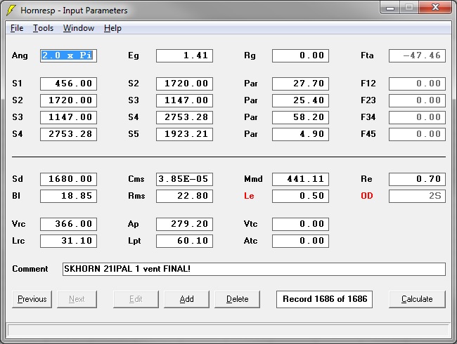

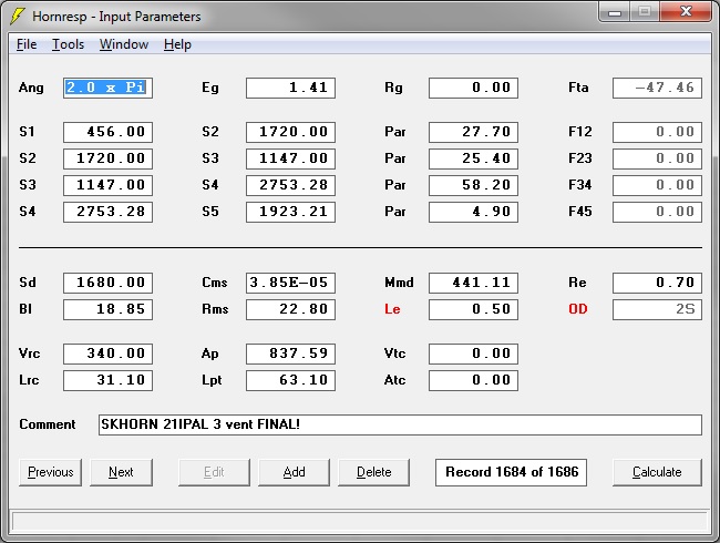

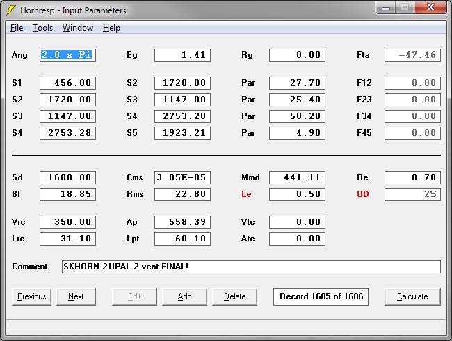

EDIT: 02/20/18
I have improved the accuracy of HR simulation inputs when compared to the measured ground-plane performance of the final speaker. The preliminary HR inputs in the first post are not nearly as accurate as those developed after testing the final cab, which are posted here. If wishing to simulate this cab design use the inputs for the Skhorn cab from this post. (Note: The HR inputs below are using the B&C 21-Ipal drivers, which are what I built and tested. The cab can be run with any of the 3 vent tunings of approximately 18, 25 and 29Hz shown below.)
attachment.php
attachment.php
attachment.php
