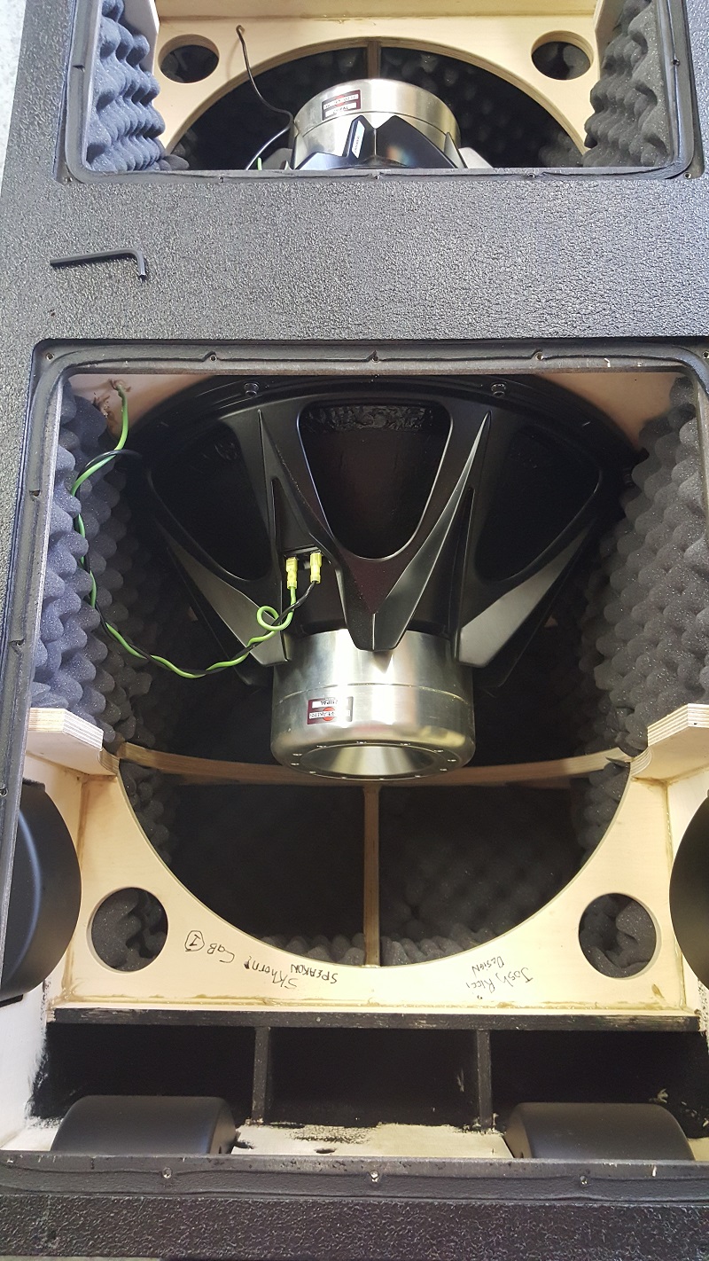

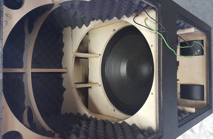

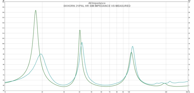

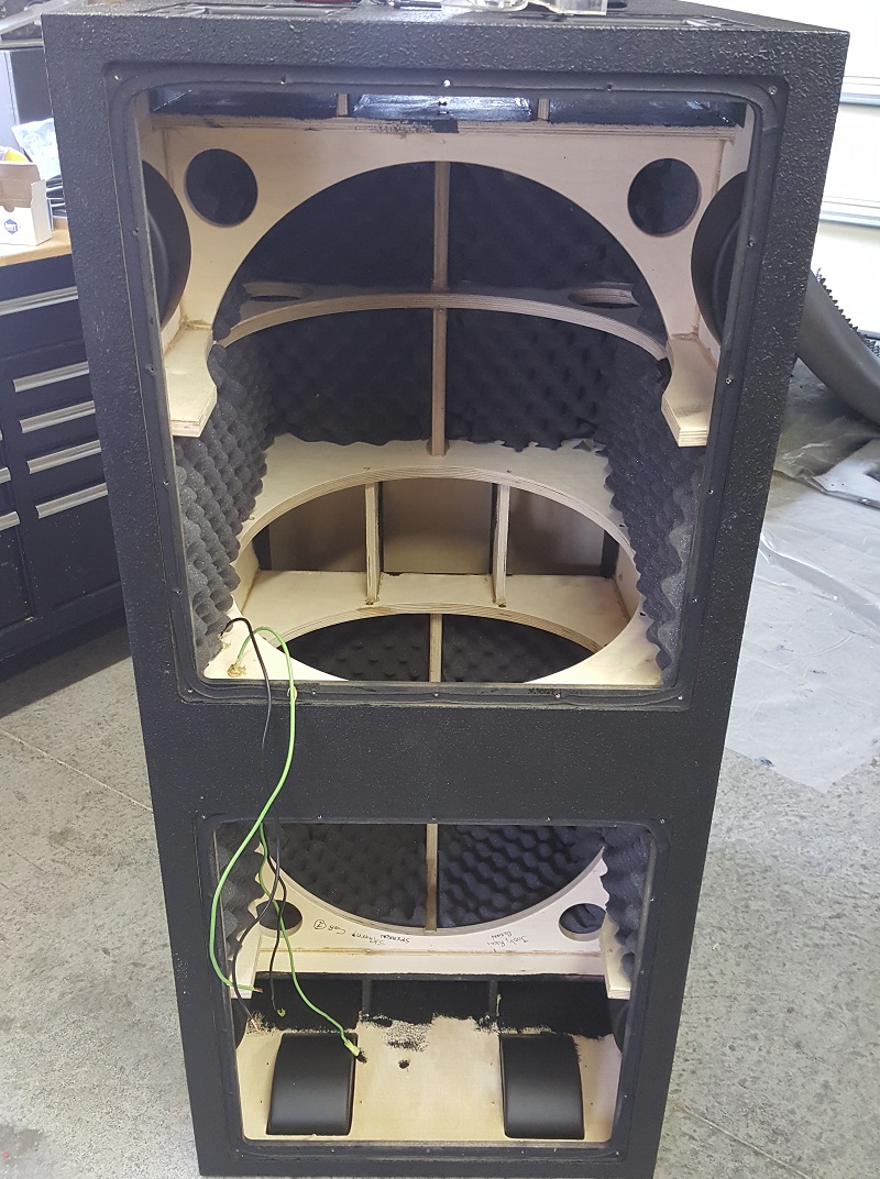

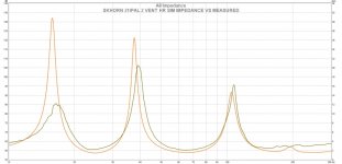

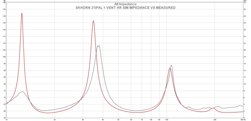

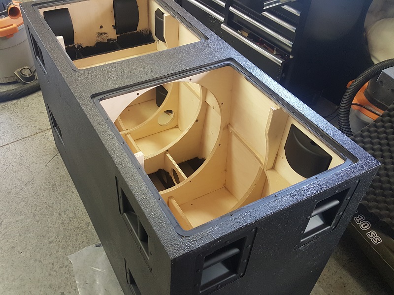

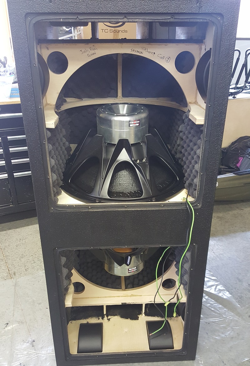

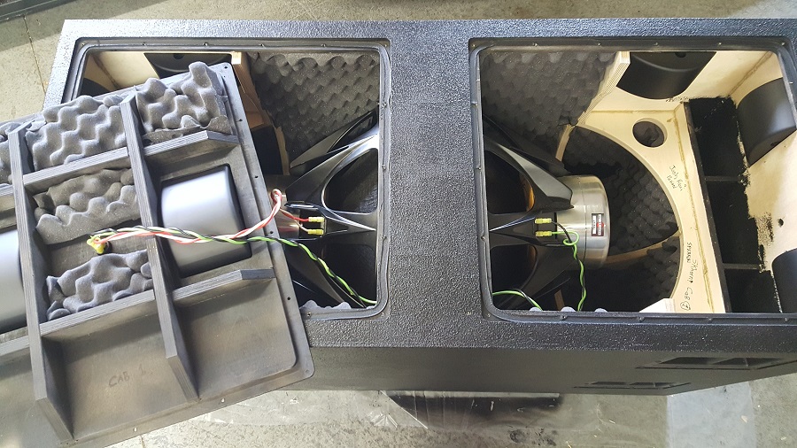

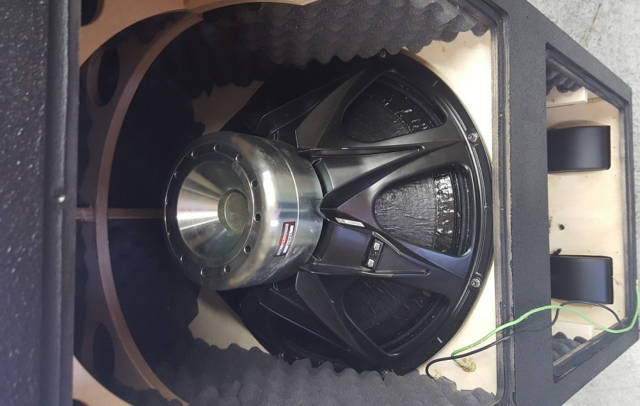

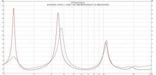

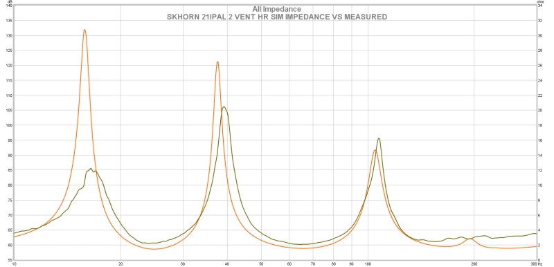

Little bit of an update. I have the cabs and have the 21-ipal's loaded into one. I've started on some preliminary testing. Some pics and impedance measurements below. I'm using wooden covers to block the vents and lower tuning but they are a bit leaky in the impedance measurements below. I'm going to figure out a way to get a better more solid seal and rerun them. I expect it will clean up and increase the magnitude of the low frequency peak below tuning a bit.

Actually a guy who contacted me about building some Othorn's and Gjallarhorn's built these for me. Yes he does good work.
