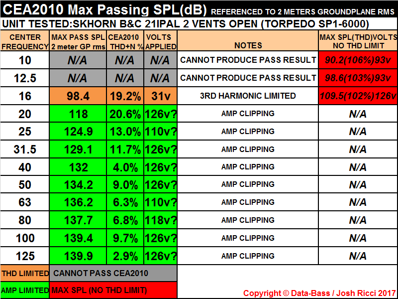

Question, was port noise present in 1 or 2 vent form?
At the limits for sure. Every vented sub exhibits vent noise IME. One vent was by far the worst and showed up as more vent compression. 2 vents wasn't bad. Sub wasn't really designed for 1 vent use. It's not enough vent area.
There are a few guys who have requested these plans and are having a go at building these and at least 2 other people besides myself have Skhorn's already. Hopefully they will post some of their builds or opinions on it.

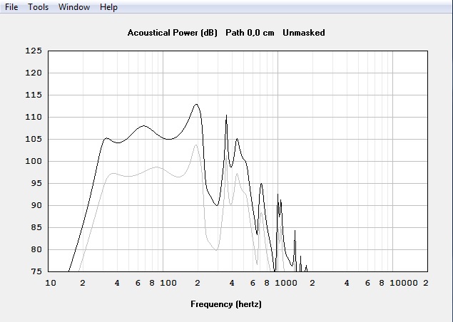

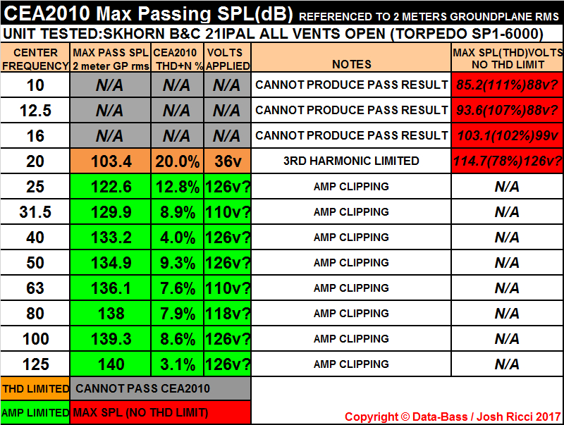

May as well throw in a measurement graph or two for good measure. Distortion limited and maximum burst output using a Speakerpower SP1-6000 amplifier with all vents open and with 1 vent blocked per side.

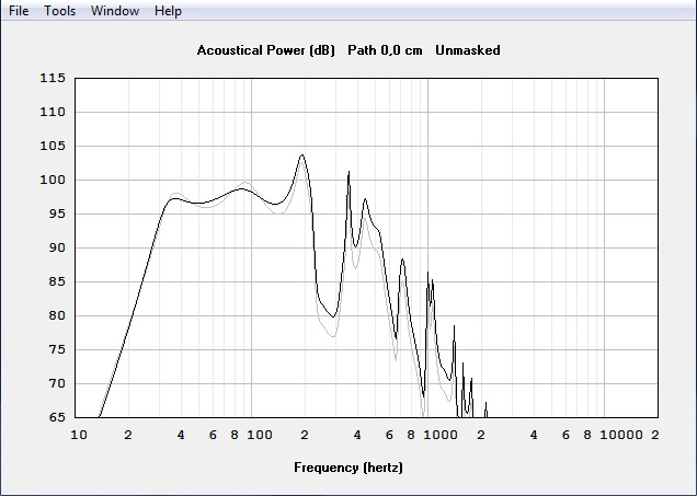

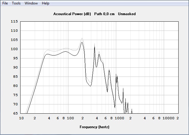

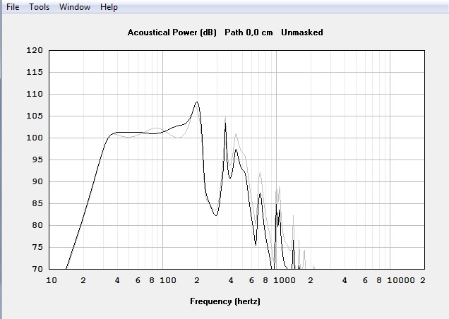

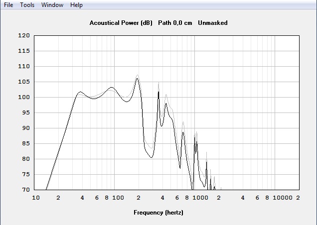

Hi, I got curious today how my 18sw115-8 would work in the skhorn cabinet and compared it to a few other drivers in various simulations. Note that I'm very newbie with Hornresp and I'm sure anyone could point out any mistakes made if so.
Thought it could interest somebody
As of now I've got my two drivers loaded in Keystones and wonder how one Skhorn would compare to two keystones with them. If it's possible to get hold on CAD files for CNC I might be interested in giving it a go, would it be possible Ricci?
Other than that I must say I'm surprised they keep up well with the 21ds115. Also you can clearly see the cabinet are designed with 21Ipal in mind! Real beasts
From left to right:
18sw115-8(black) vs 21sw152-4(grey)
18sw115-8(grey) vs 21ds115-8(black)
18xl1800-8(grey) vs 18sw115-8(black)
21ipal(black) vs 18sw115-8(grey)

Hi!
If you compare drivers with Hornresp look for OHMs and Volts with different drivers
8 ohm = 2,83 Volts
4 ohm = 2,00 Volts
2 ohm = 1,41 Volts
21ipal(black) is 2 ohm, so you should put in Hornresp (1,41 Volts) vs 18sw115-8(grey) is 8 ohm, so you should put in Hornresp (2,83 Volts) to compare simulations!!

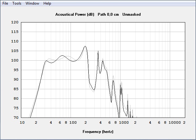

Oh, thanks!
I now used 2P for 18sw115-8(2 Eg), 21sw152-4(with 1,41 Eg) and 18xl1800-8(2Eg), for the 21Ipal 2S(1,41 Eg). Hope this is correct
Left to right:
18sw115-8(grey) vs 21sw152-4(black)
18sw115-8(grey) vs 18xl1800-8(black)
18sw115-8(grey) vs 21Ipal-1(grey)

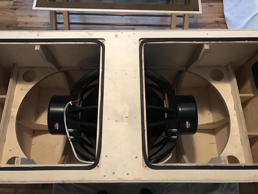

Sure Osse. I will send you the prints when I get a chance.
Have you thought about the new 18ds115?
Thanks! I did simulate it and to me, applying power and full excursion, it seemed to put out 1.5-2 db more if I simulated correctly. I don't know what to expect of the real life difference due to power compressions and losses.
If I end up using other drivers I might just make the upgrade to 21ds115 instead of 18ds115. With the same diameter VC they should be able to take roughly the same long term power and I'm able to heat up my 18sw115 to about 100°C if I want
Well since it is your money and you are buying drivers... I would go for the 21DS115. 😀 (I should be testing the cab with those drivers in the next few months.)
But seriously...Even if you do not have a big enough amplifier to "push" them all of the way, that just means that the output remains clean and easy up until the amp gives out. The extra 3dB or so worth of displacement from the 21's goes further towards lowering distortion than you would think.
Whatever you decide I look forward to your build and thoughts on how the cab sounds.

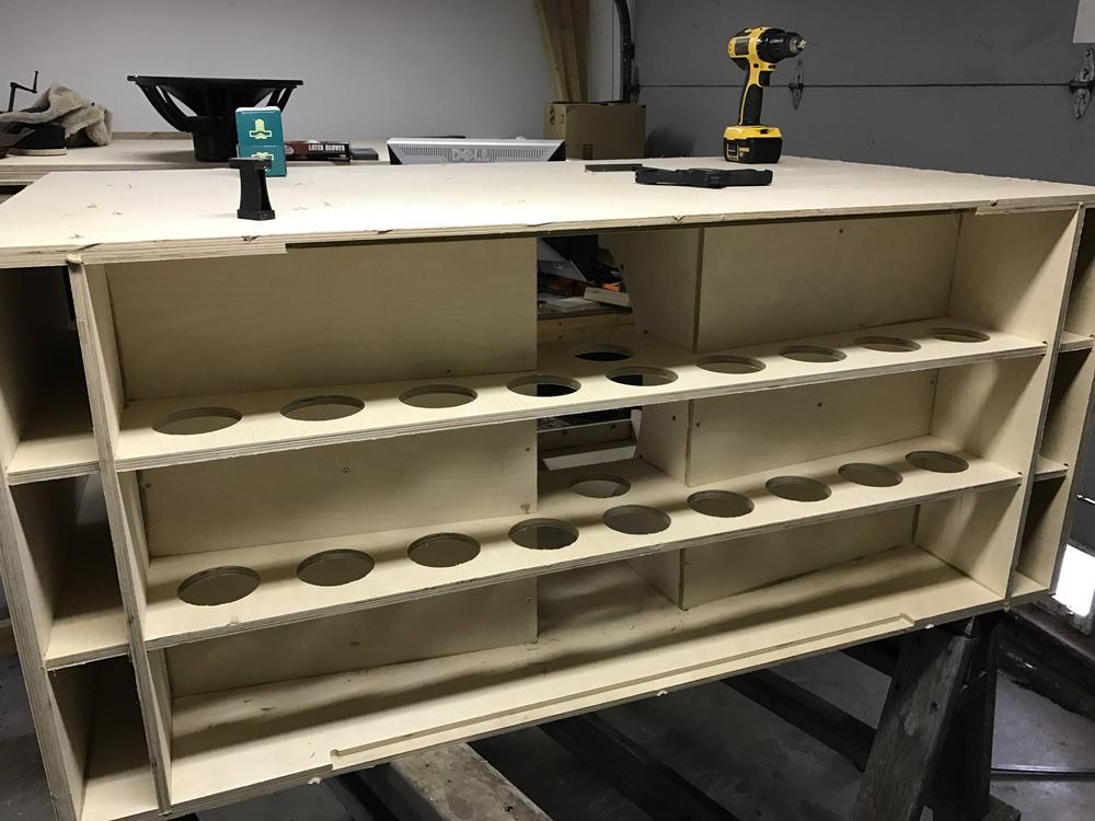

I figured I would revisit this subject. Bandpasses and other types of high order compound loadings often get a very bad rap as far as sound quality goes. We've all heard the way they get described as sounding: One note, booming, sloppy, notes over hanging, smeared, tubby, etc. A lot of us have heard terrible sounding subs that do just that so it is no surprise they have this type of stigma. All of that goes back to subpar, compromised or flawed designs in my view.
To me the Skhorn cab or MAUL sounds nothing like any of those descriptors commonly used to describe BP or compound designs. The measurements bear that out as well. In my experience it comes down to using powerful, well damped drivers and spending time during the design phase to produce a system that responds smoothly over a large bandwidth, remains linear to very large signals and does not store too much energy in the bandwidth of interest for the device. It all comes down to the individual design. There can be excellent 6th order subs.

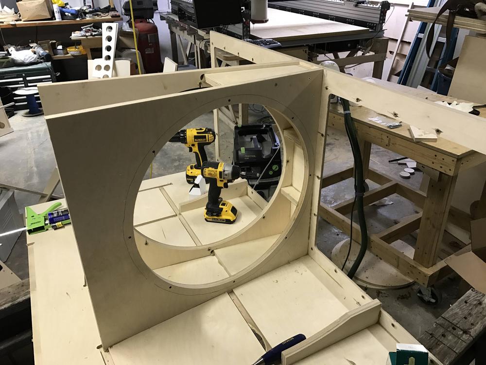

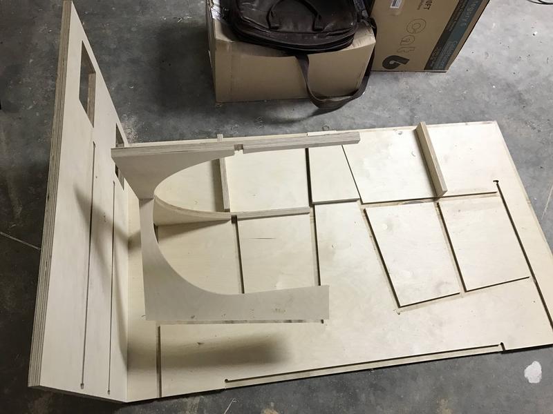

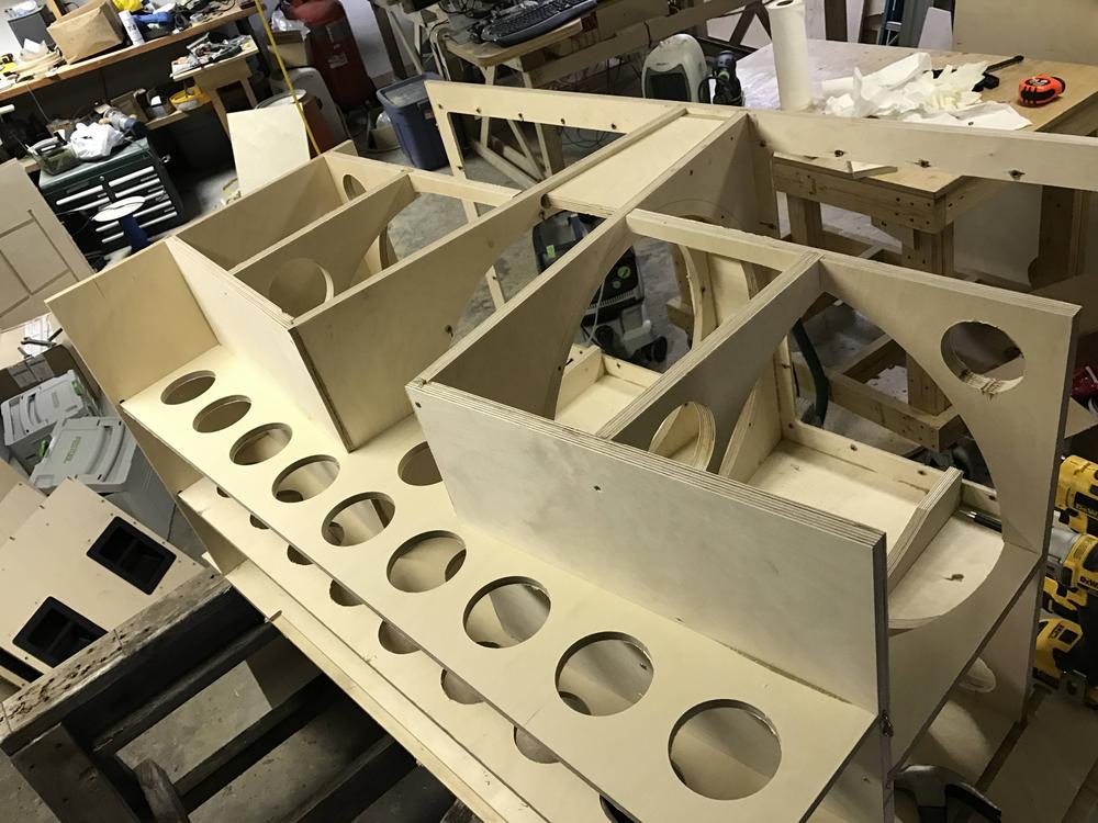

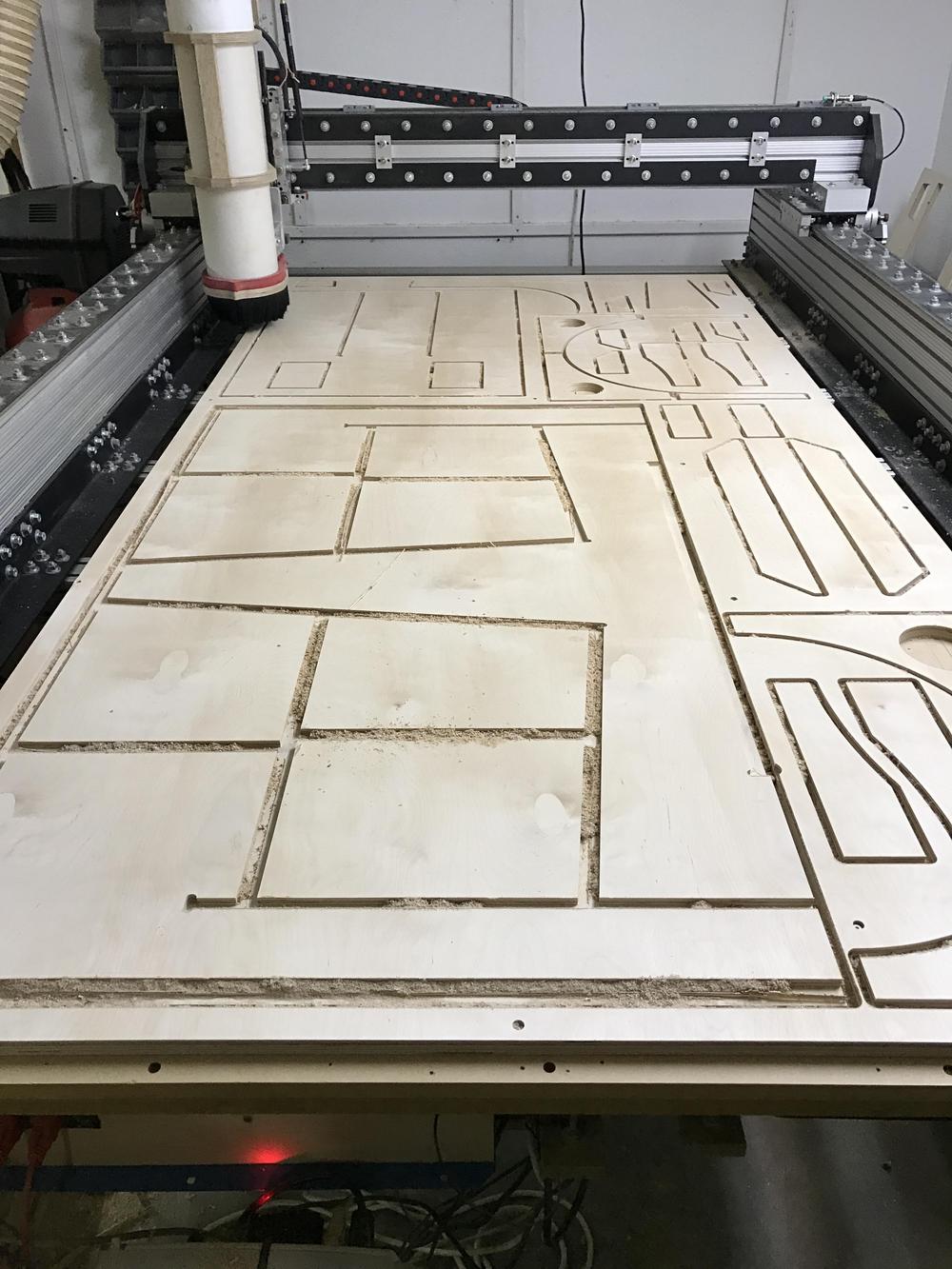

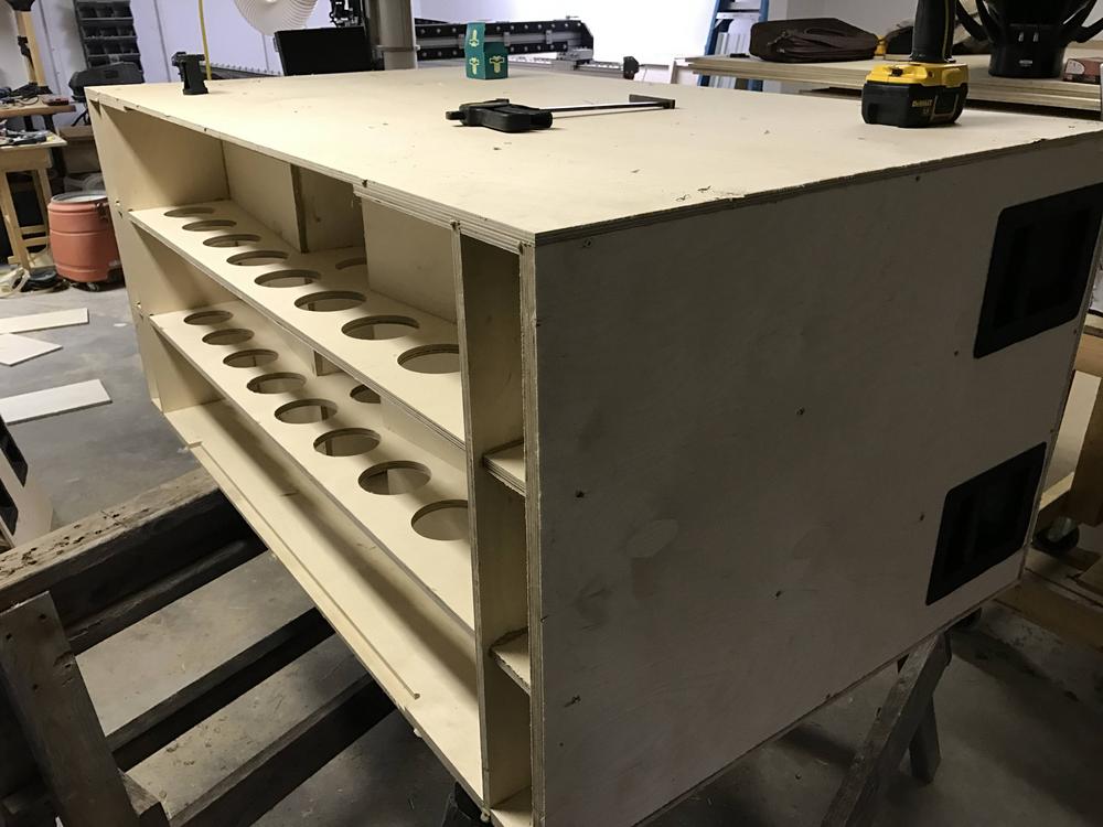

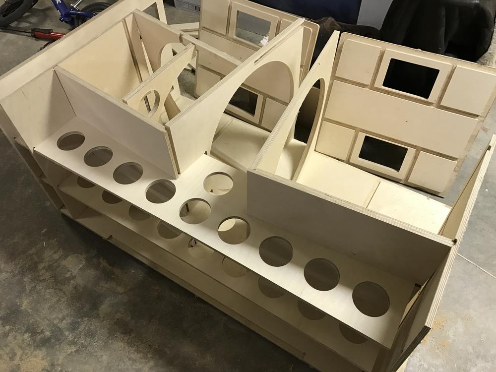

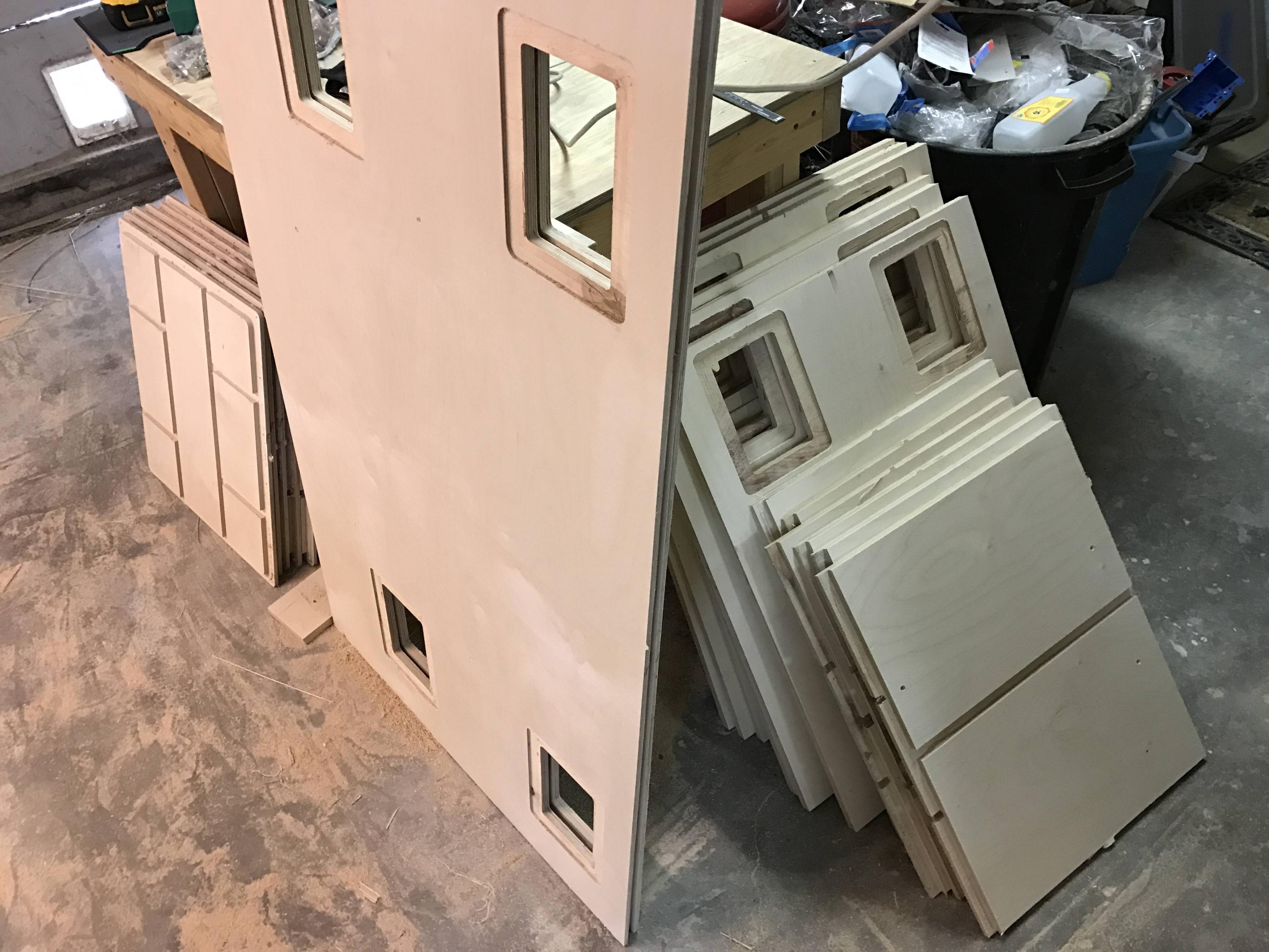

Josh, Nice build! What tooling did you use on your router? Looks really clean! Do you have a vacuum hold-down pump or ?
I can't take credit for the build. Thankfully I've had a couple of DIYers with access to cnc shops who've helped me out on my last few cab designs. This one was cut and assembled by a guy named Ti.
Fantastic! It looks like a really clean route. How long did it take to machine 1 sheet?
