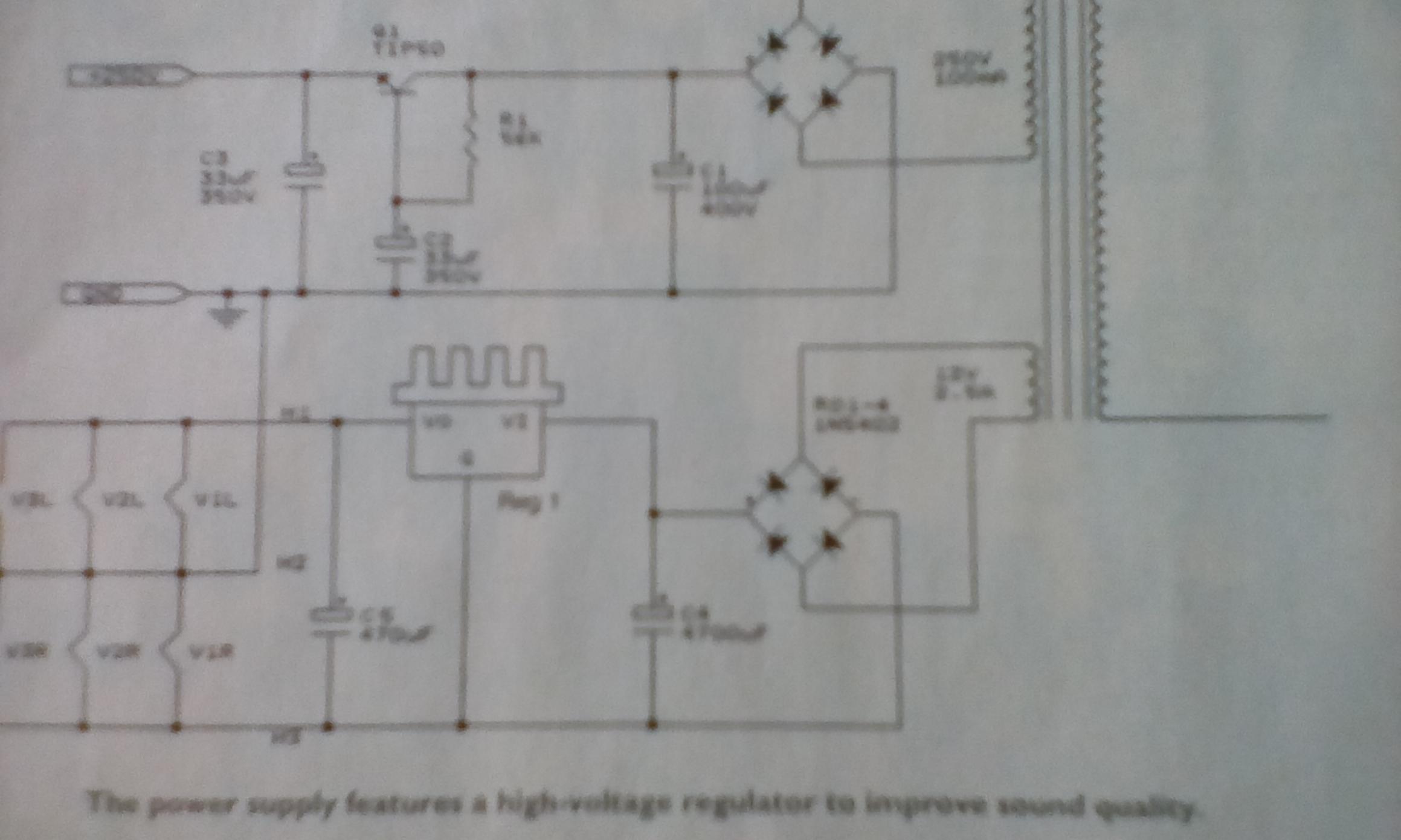

Sorry lads I was not ignoring you.
My camera is refusing to shake hands with my laptop...flipping windows10 is doing my head in.
Anyway the heater PSU was completely reworked....
That's from my phone ugh!!!!
