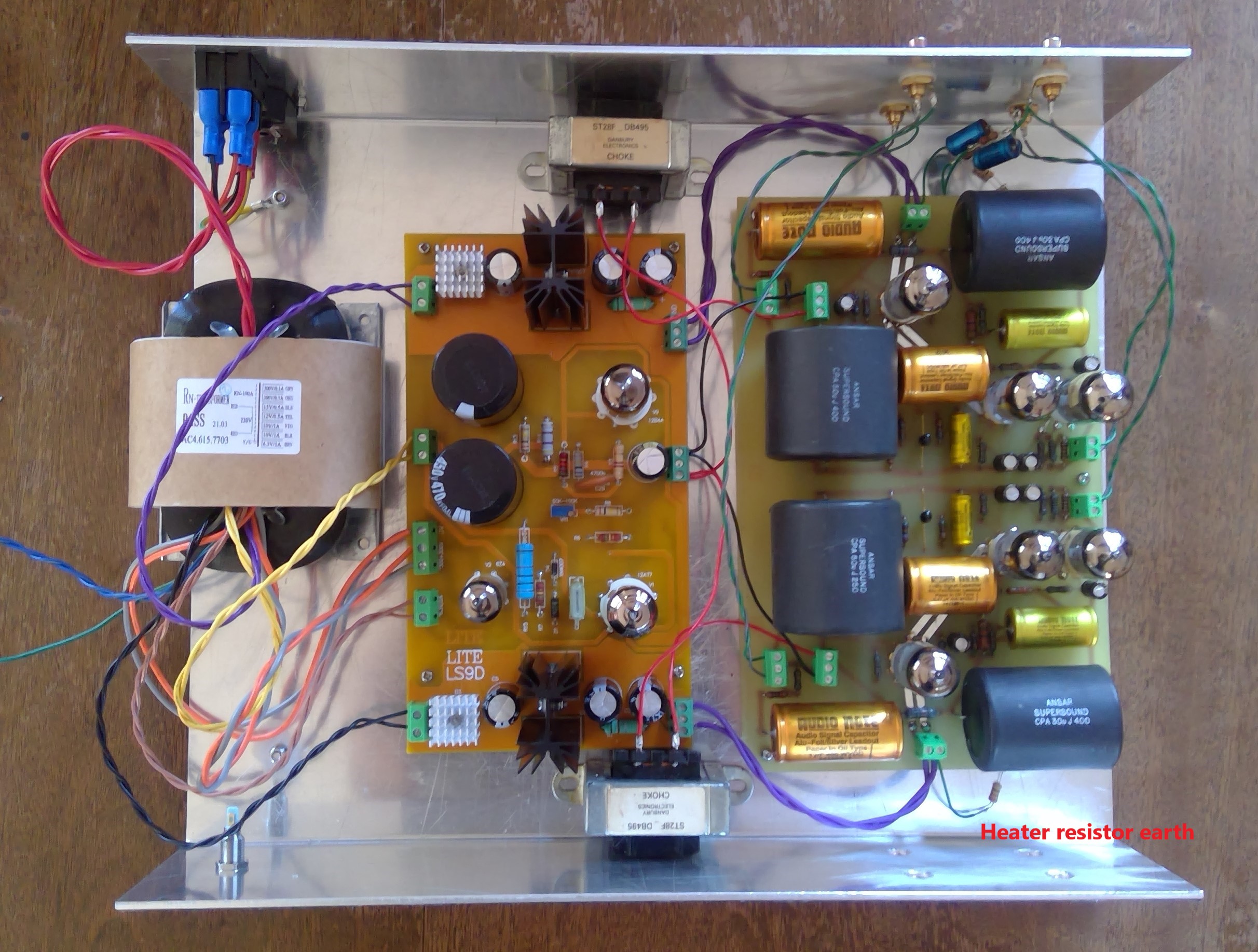

Here is the text relating to the circuit, i haven't had a chance to try any suggestions to remove the hum yet - I will have a go tomorrow and I will also post a picture of the unit if I still can't get rid of it. Thanks for all your replies
Is it perhaps possible for you to take a picture of that (hardware) layout? So we can also benefit from your experiences. 🙂
Heater earthing
Picture as requested, I have put text where I added an earthing resistor to the heater supply. I still need to tidy the wiring and change the input / output cables for screened type but it's all coming together nicely !!
Unshielded long input wires for 500uV input????Picture as requested
The output wires also?
Sorry, but it's a typical bad layout, source of hum.
If you would rotate phono board 90 degree left, the input wires would be as short as possible (in this constructions).
In this case is impossible, try shielded (two wire with shield) signal wires.
Wiring
As I said in the text I need to sort the wiring , and regarding the input length there is 1M from the turntable so I can’t see 4 inches making much difference and there is a 100R resistor to ground also ( cartridge load resistor ) on the input !!

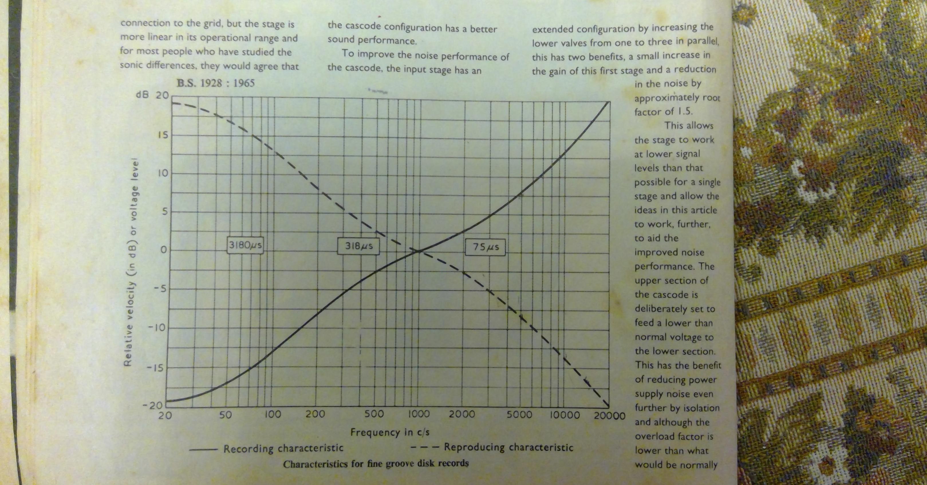

Hello ,
if I find my PCB , I will do some measurements 😀 .
Kind regards , Alexander .
Alexander, can you share the contents of that article (booklet?) with us please? Or where can I find this on the internet (perhaps)?
Joe.
"input length there is 1M from the turntable so I can’t see 4 inches making much difference"
Phono cable from turntable to phono preamp is shielded.
You wiring inside the phono amp not, and there are some magnetic field from transformers.
If shorting inputs no significant hum, you are a lucky man, but in general the phono input wires must be as short as possible, if it not feasible, must be shielding!
