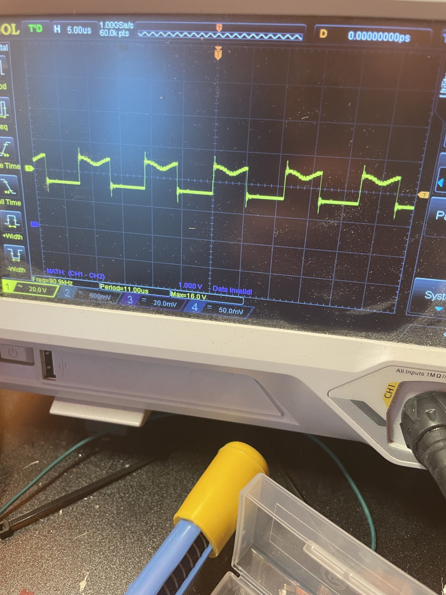

Predicting next step - U15 pin 7 is the same square wave mentioned above. U9 pin 7 is a strange square wave attached

I removed the scope battery ground to avoid a short through the scope. Using the probe ground on Q101Pin3, U9pin7 has a clean square wave. Using probe ground on the battery (screw hole) U9pin7 has the pictured wave in post50.

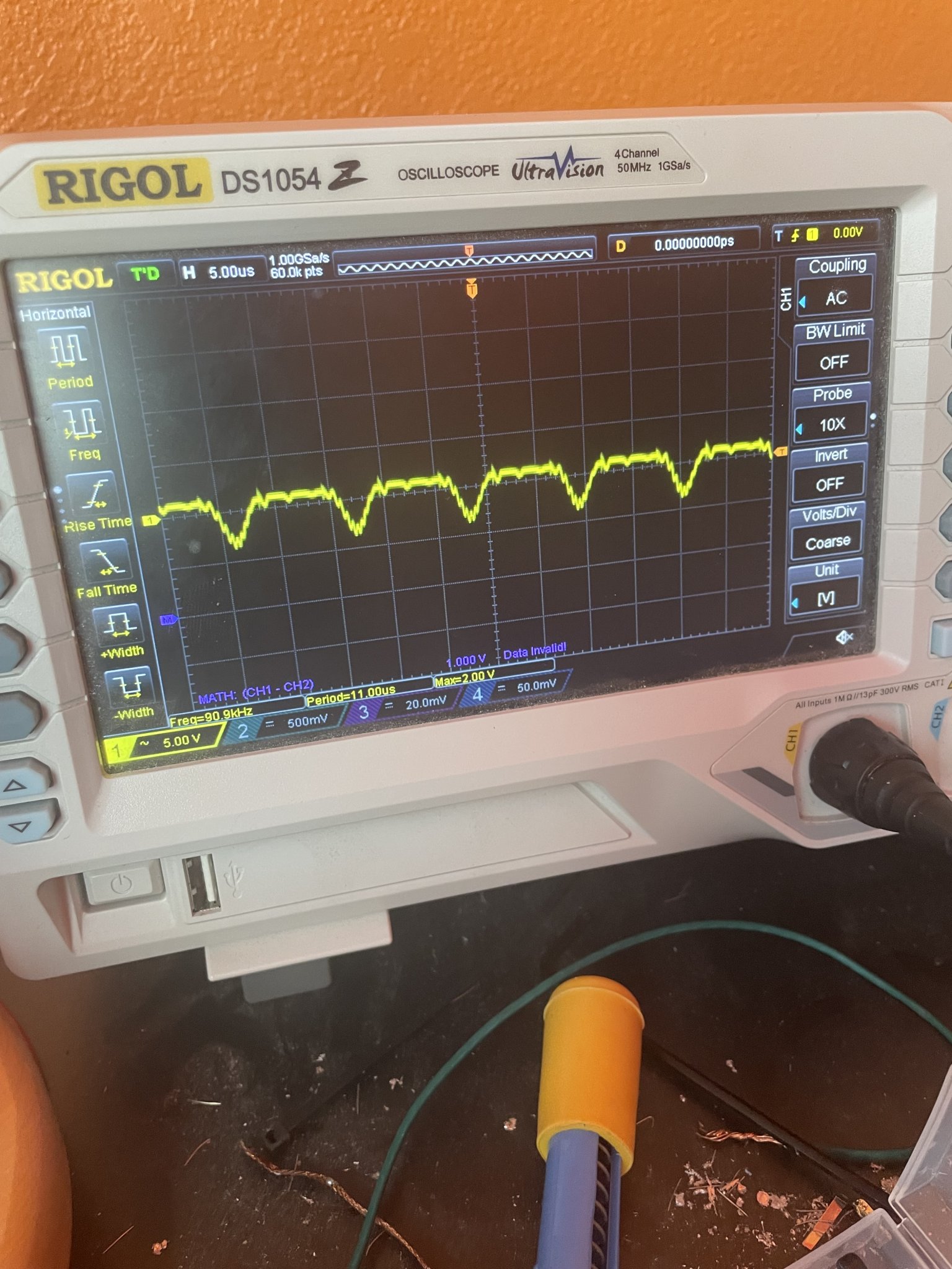

-10v vdc offset, trace attached.
I suspect you will suggest replace U10. Should I do U9 as well, or replace U10 and then re-evaluate U9pin7?

So… success. The U9pin7 flattened out and didn’t have the odd dip. Got hv jumper back in, removed u17 jumper… and we’re rocking. Full wave on output. Clean.
