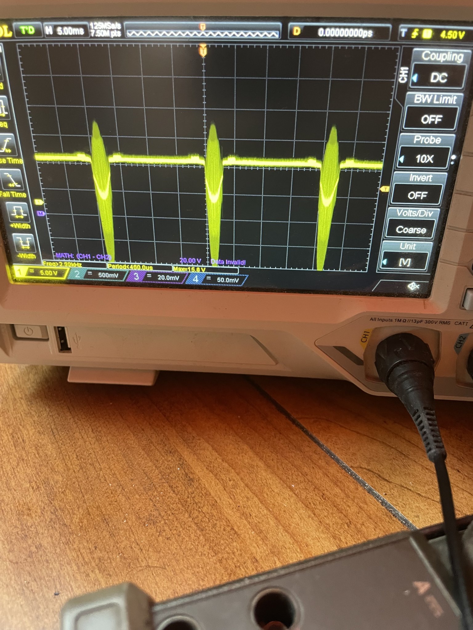

Yikes. Output on the scope is…. Not good. Only bottom half of the wave.

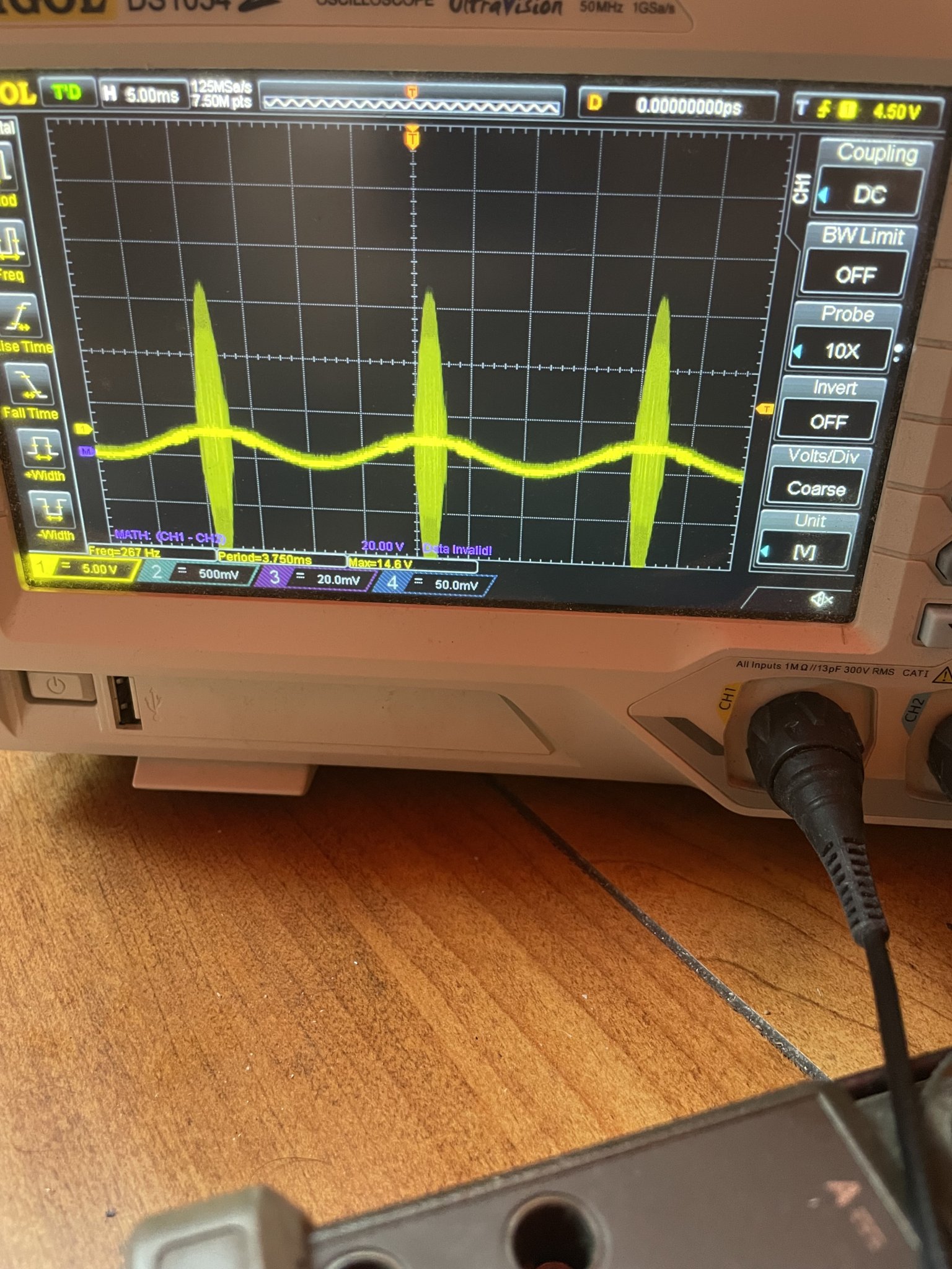

I’m suspecting u17. Here are traces of the output pin 6 and input pin 2.
No jumper yet, 50hz input
And what’s with all that noise at the peak of the wave? If I scope the input directly at the rca’s it’s there. If I remove the remote but leave the battery hooked up it’s fine the noise disappears.

Amp is being fed by a lithium battery. Scope ground is on B- terminal. I put a probe on the second channel of the scope and clipped that lead to B- so I can use the first channel probe without the ground clip.

I figured with a full wave in and half wave out it was bad.

The noise appears to be radiating and being picked up by everything. It’s at the rcas, at B+, at the vcc of u17

Yes, the noise is on B+ (battery positive 4awg terminal) and goes away when the audio is turned off but amp still powered up.

The scope has a common ground amongst all the 4 channels. CH2 scope probe ground is connected at B- 4awg terminal. The snapshots are from CH1. The ground lead on the scope is only 4” or so long, so it’s impossible to put it on B- terminal which is on one side of the board while I probe u17 that is on the opposite side. Unless I find a large enough ground for the alligator clip on the probe on that side of the board. Or maybe use two channels in differential mode.

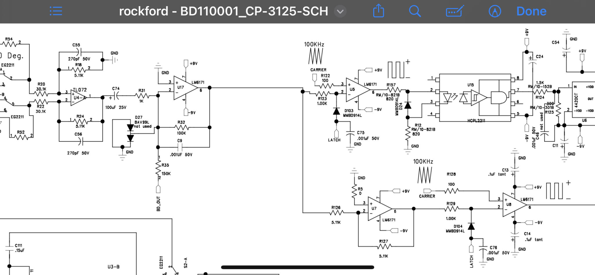

Is it possible we are looking at different schematics? I’ve attached a portion of the one I’m referencing. U17 is the final opamp before the output stage splits off into its halves.

With the amp as is, U17 is responding to the performance/operation of EVERY component between the U17 output and the BD_OUT point on the output transistors. ANY defective part between those two points can make U17 behave strangely and it can react (at least) a few hundred thousand times a second. The output of U17 will typically look nothing like the output signal at the output terminals of the amp.

The measurements were the same shape though. U17 input pin2 is a full wave approx 3.5v peak-peak centered at -2v. The output at pin 6 is a half wave (the negative half) centered at about +8v, with an 8v peak. The output appears to be only the negative rail.
