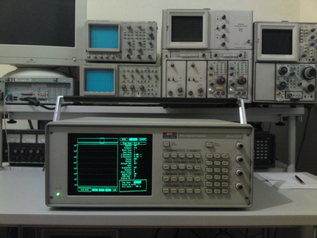

Guido,
Similar to your analyzer is the tipical TDC, time to digital converter, which is used a lot in physics.
And yes, it can be used to collect the same histograms, like the TIE histograms here. We used these to measure jitter in our experiments a lot of time. Typically these have 45 psec resolution, that is the finest binning.
But there is an important point: seemingly also the scope would have a similar resolution, 25 - 40 - 100 psecs. But. An interpolating algorithm is used, so the crossing time can be extrapolated by a much better precision.
The higher level scopes are good down to 1psec jitter resolution, the best ones are having like 500 femtosec jitter noise floor.
I have seen the built in 50psec rise time square signal generator's jitter: it was gaussian, 1sigma was 1.5psec. In the above histograms it would be a thin line.
Another point: a TDC like instrument collects only histograms, you loose the "private" information of the individual edges, so no time trend reconstruction. Also no FFT of it, no phase noise plots.
Again: a TDC has to be started / stopped at each time. That is, triggered. Also this procedure, producing the trigger, is producing it's own jitter contribution. Not by accident the discriminators used for it are a topic on it's own.
Also conventional scope "eye diagrams" are having the scope trigger jitter included.
In the plots above this is not existent: there was only one trigger at the beginning.
Ciao, George
Ok, ok. Here's one plus for my acient beast: it was only 80 euro's or so and not 35k 😀
